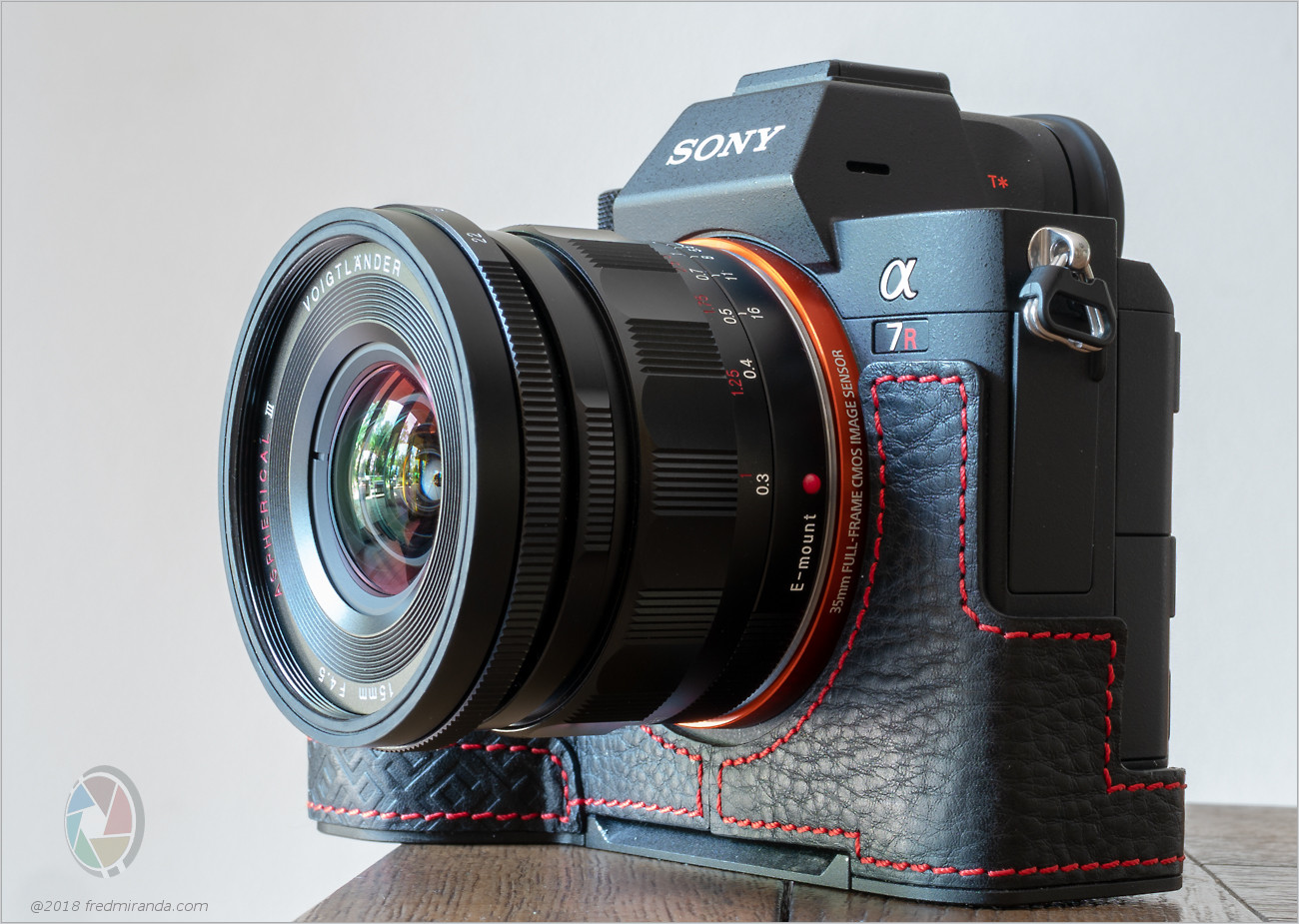

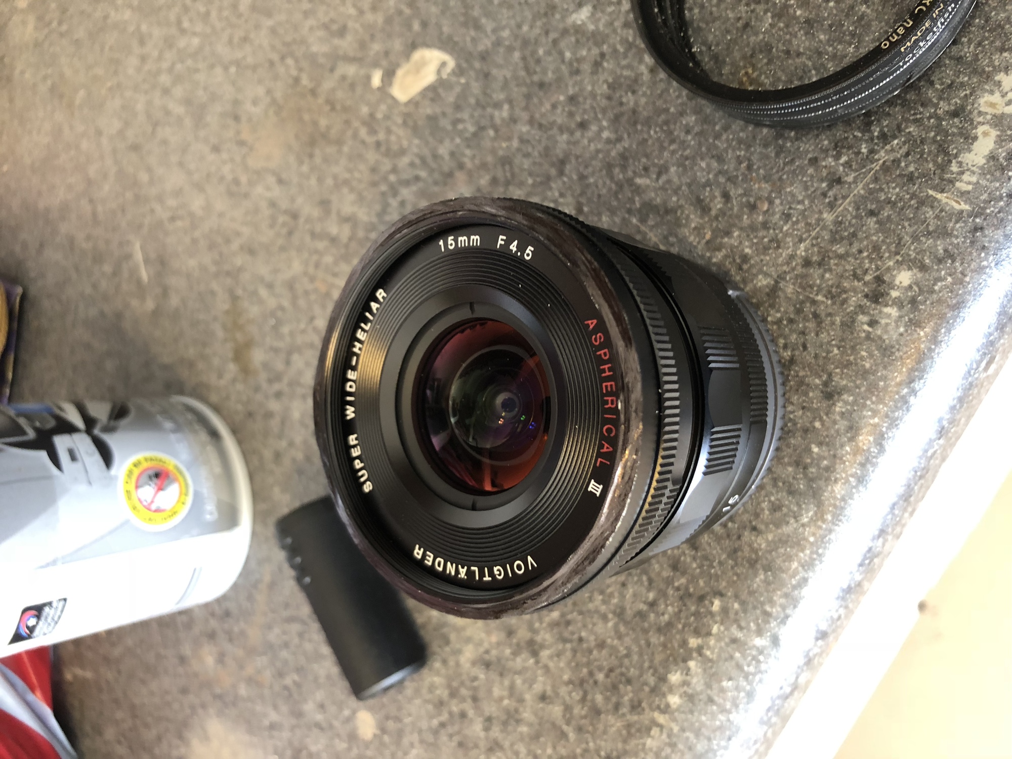

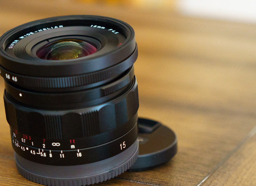

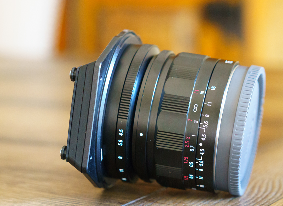

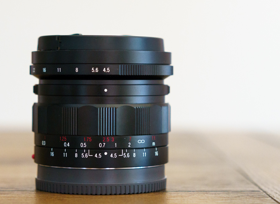

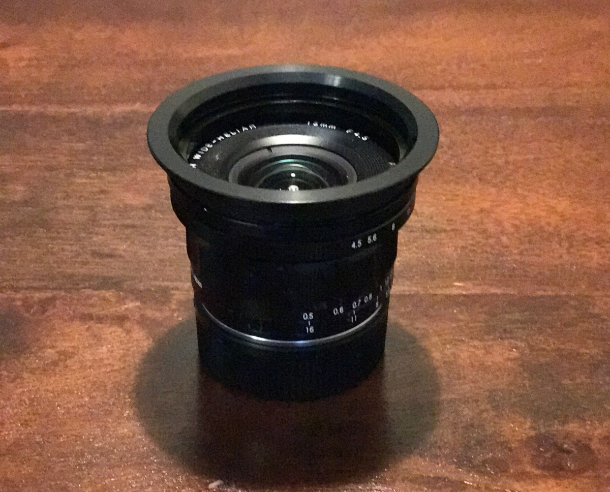

I just got my CV 15/4.5 III E-mount lens back from S.K Grimes. I requested a hood removal and paint to match.
Basically, I wanted to use Lee Filters (Seven5) with all my prime lenses and I'm happy to report that it works perfectly with zero vignetting after the mod. It was a gamble and it works. Sharing this info was the main reason I wanted to start this thread. If anyone is thinking of removing the hood to use Lee square filters, have no fear!
Here are some sample pictures showing the custom hood removal job. It was priced at $70.
It's now possible to use 6 or 10-stop ND filters without getting strong corner darkening which happens when using screw-on filters. It's also possible to use C-POL and ND filters at the same time. Personally the biggest benefit will be swapping the same filter system between my prime lenses in the field.

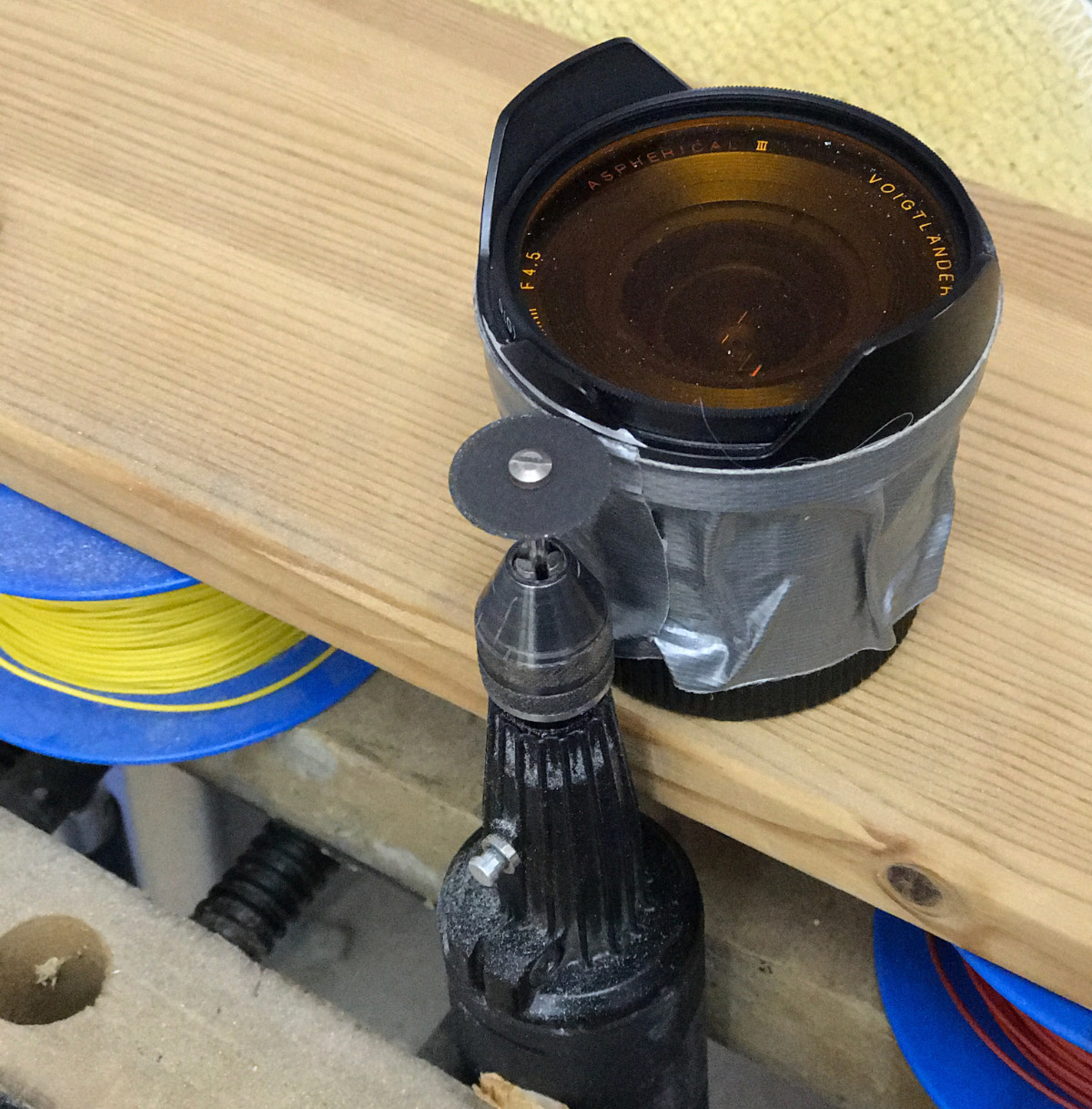

I know there is a way to do it yourself with a Dremel but after finding this pristine copy, I decided to spend a little more and do a clean removal, instead of giving birth to another Choppy!

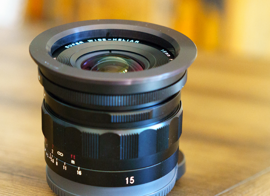

With original 58mm cap
With Lee filter ring (58mm)
With Seven 5 adapter

I went with the cheapest option for $70. It was removal of the petals on the hood and painting the exposed surfaces. It actually looks great.

It does look good. Guess I lost a choppy job. My Dremel gentle weaps in its little box.

This is actually very easy to do. If you lift the decorating ring (the one that says Voigtlander, etc) with an exacto knife (it is held by a double sided sticky tape), it will reveal three screws that hold the hood.
Unscrew and remove the hood. You can now cut it and paint it before screwing it back on and restoring the decorative ring.

BTW: Without the pedals the lens weighs 278g. (No caps)

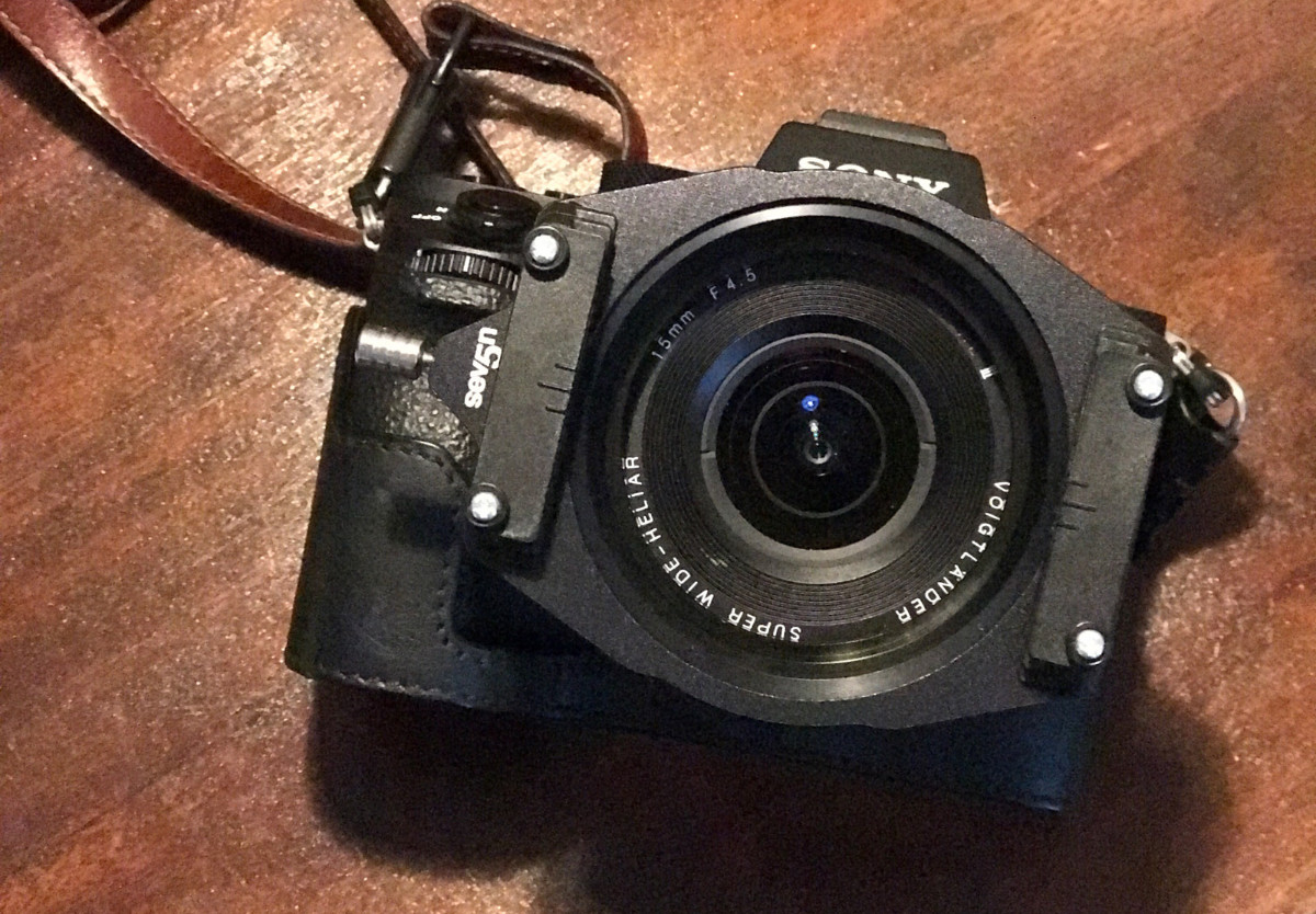

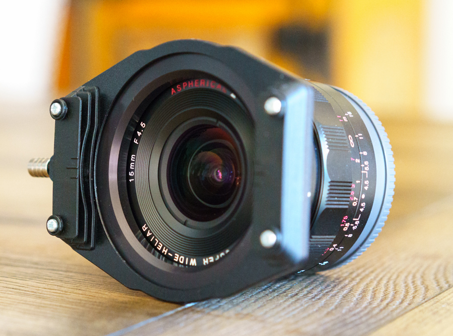

Here is another one...
About a year ago I modified my Heliar so I could use my sev5n filter on it.
It was much easier than expected. It took just 15 minutes and the pedals were off.
One filter system for all lenses makes life much easier.
some duct tape and an old red filter to protect the front lens
lens with sev5n filter holder
