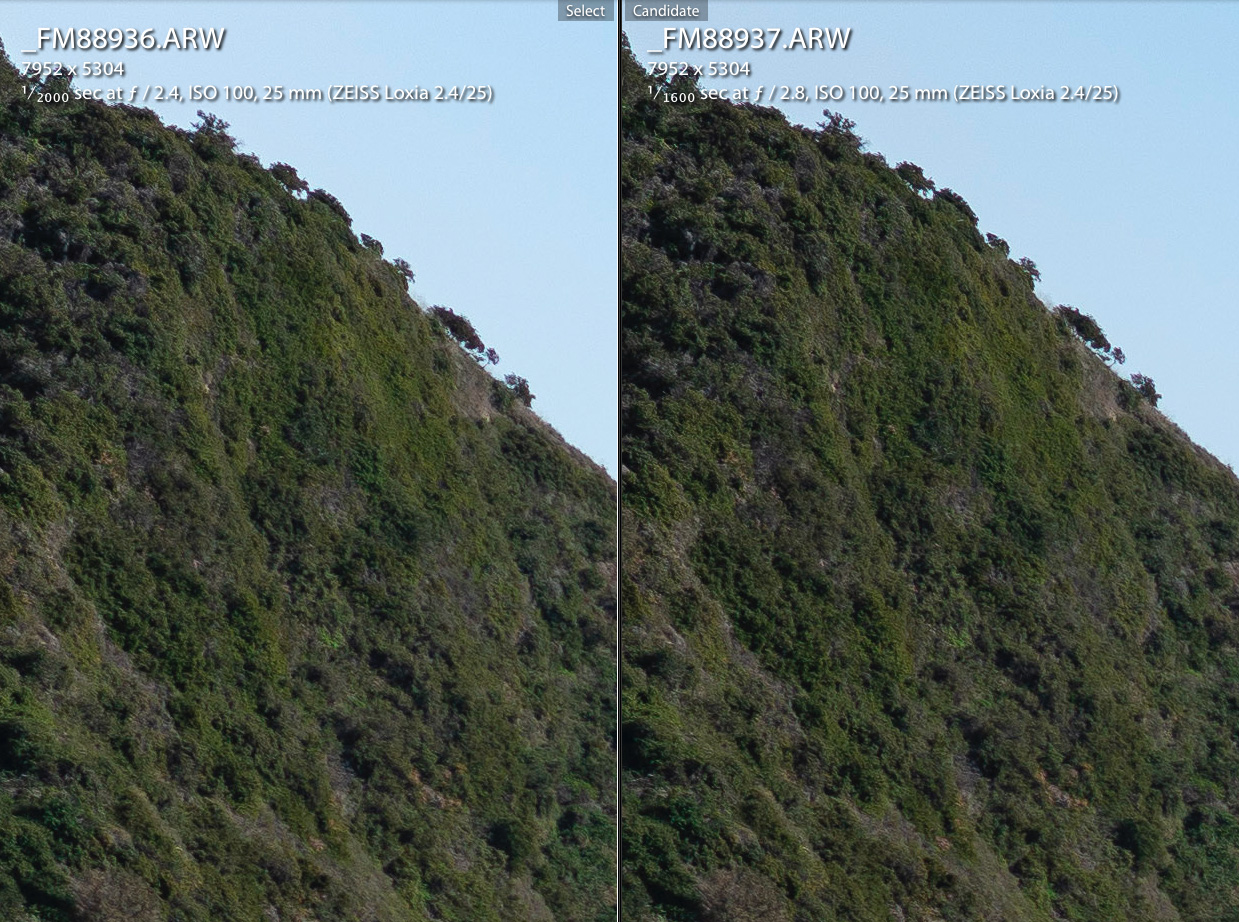

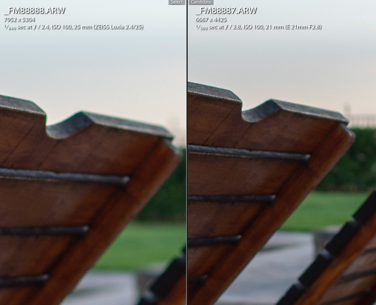

I just received my Loxia 25 today and had some time to test it at infinity distance. First, I tested it for decentering using my usual method and luckily this copy is well centered even at f/2.4.
Physically, it looks pretty much identical to my Loxia 21, only slightly taller. (Same weight, thread size, etc.)
Checked field curvature and it has the same shape as the Loxia 21's where the corners need a full hard stop and the center a tad before it. The amount of field curvature also seems similar also but perhaps milder in comparison.

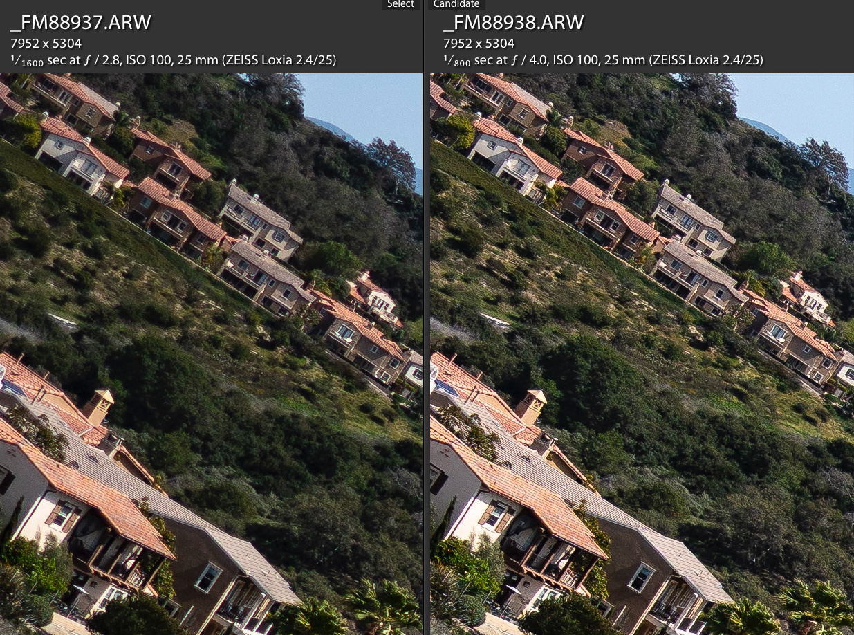

Admin

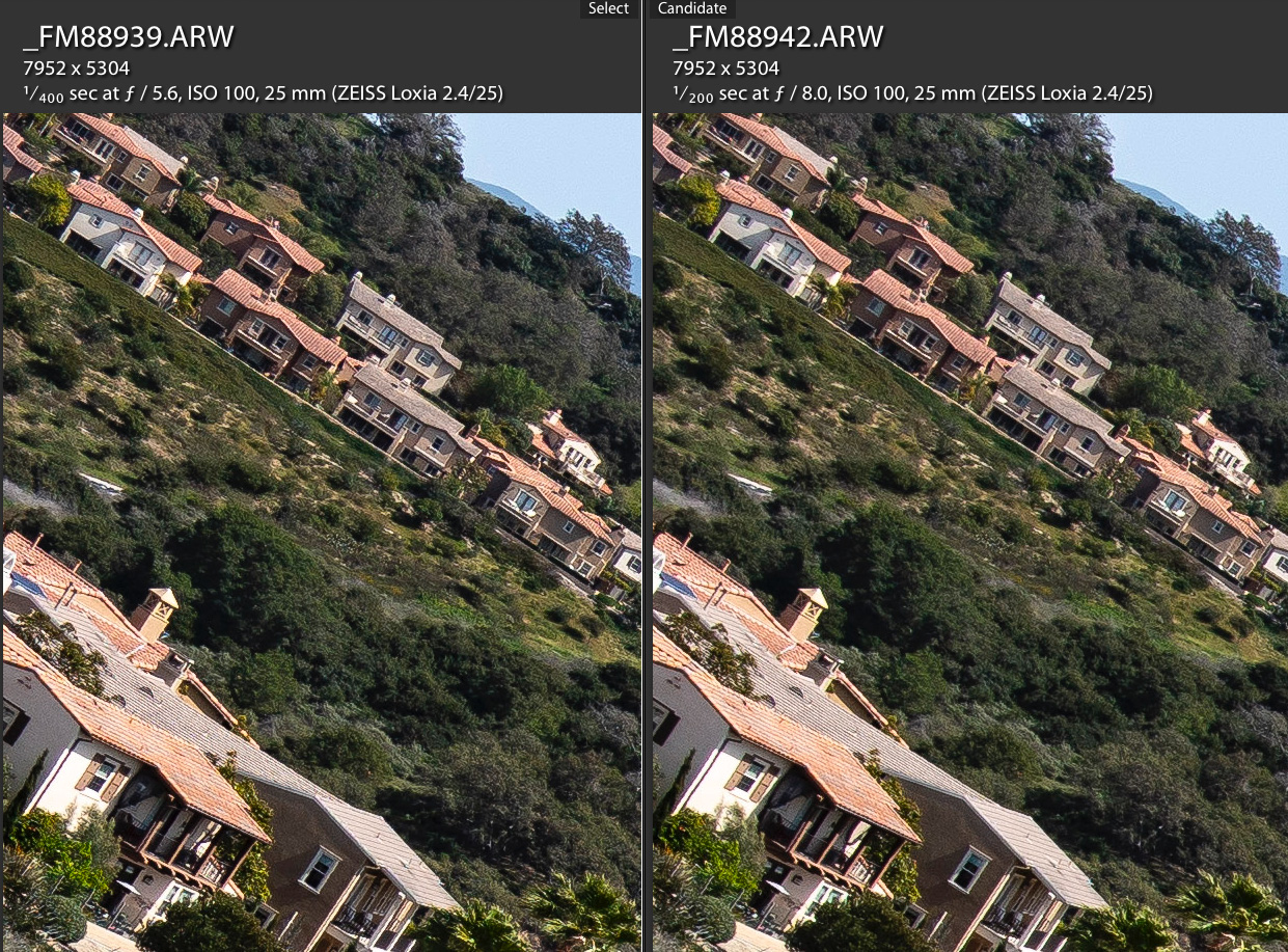

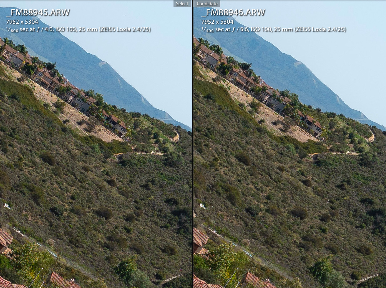

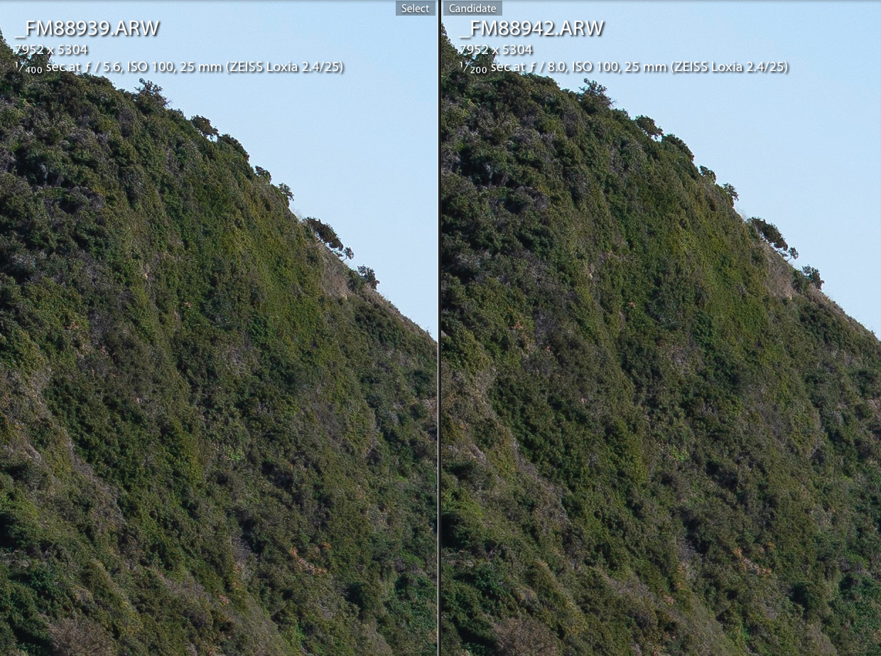

p.1 #2 · Loxia 25mm f/2.4 Distagon Tests and Comparisons

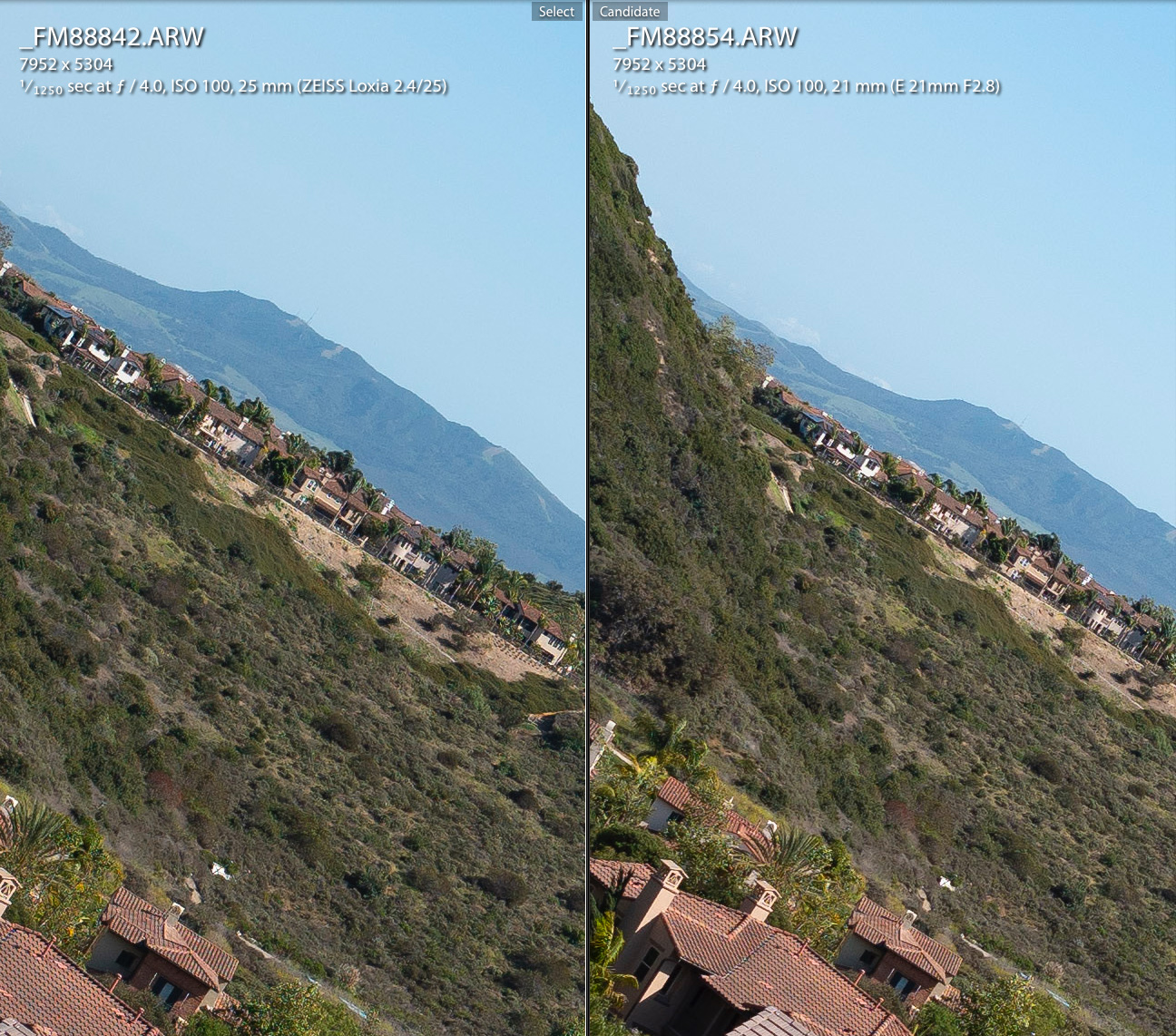

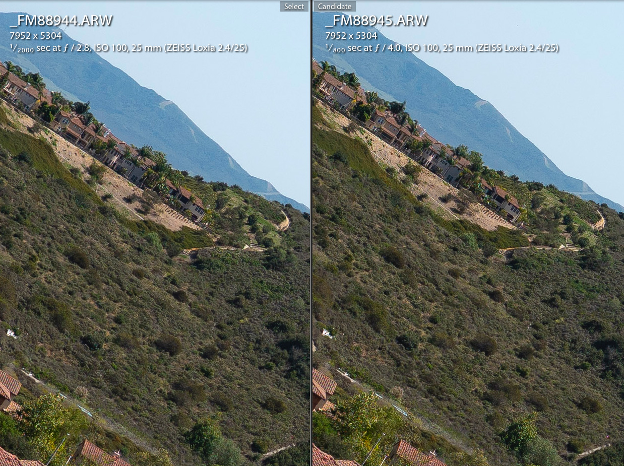

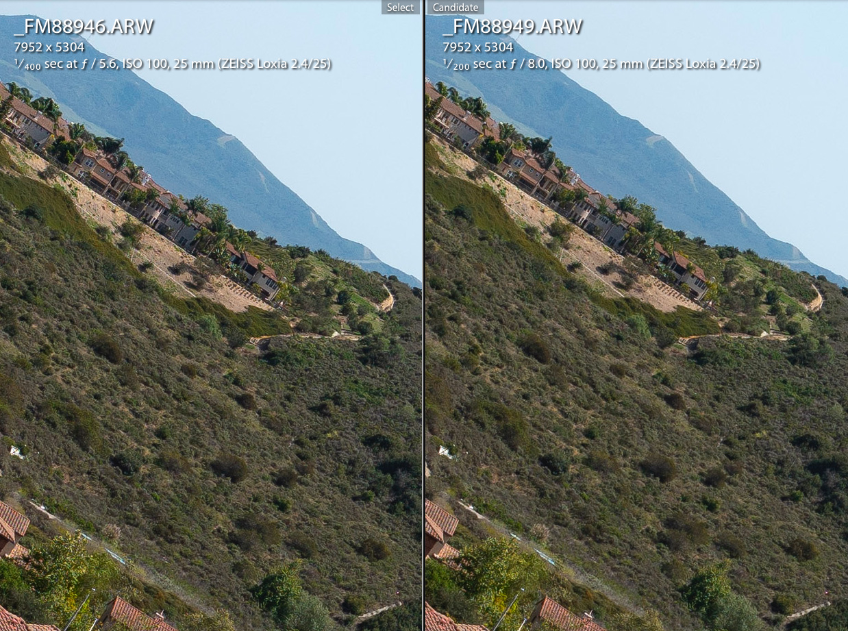

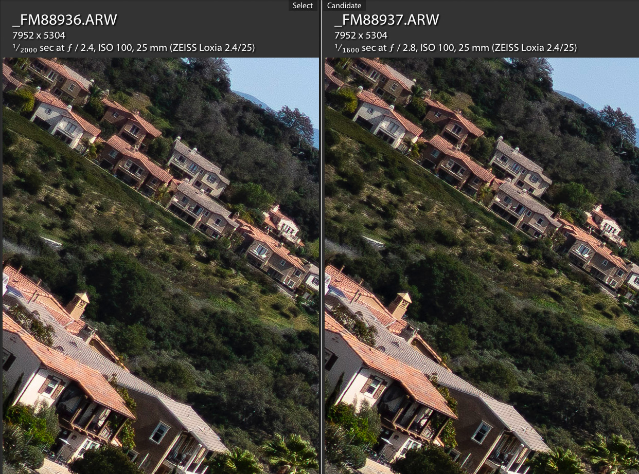

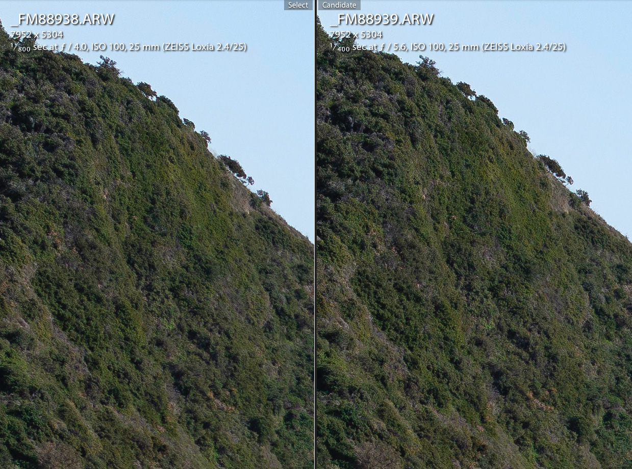

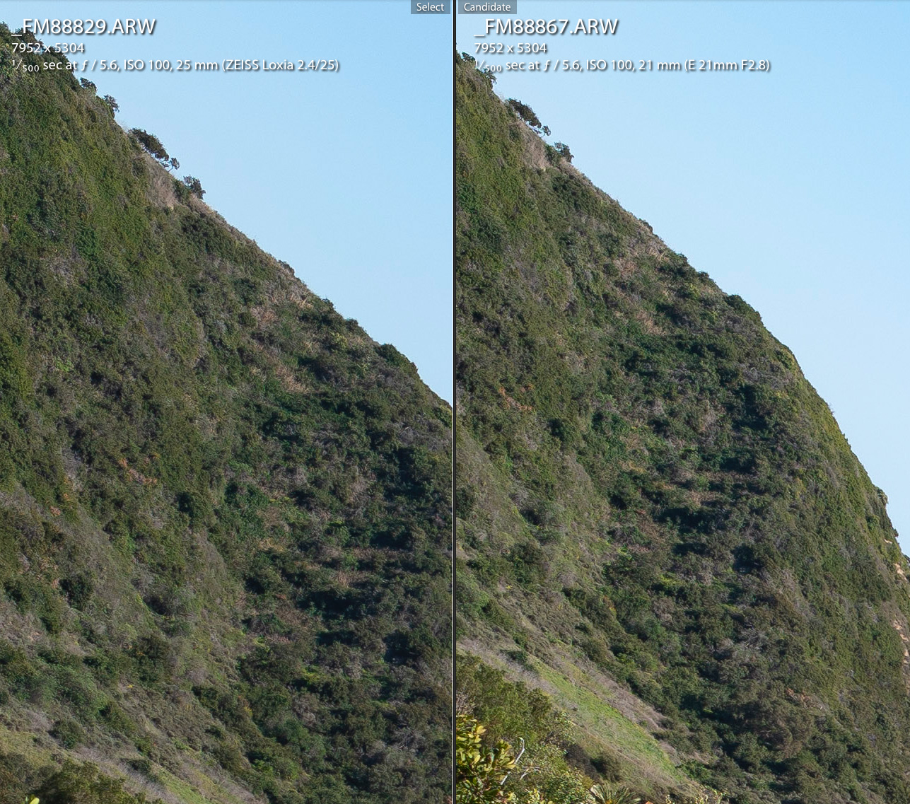

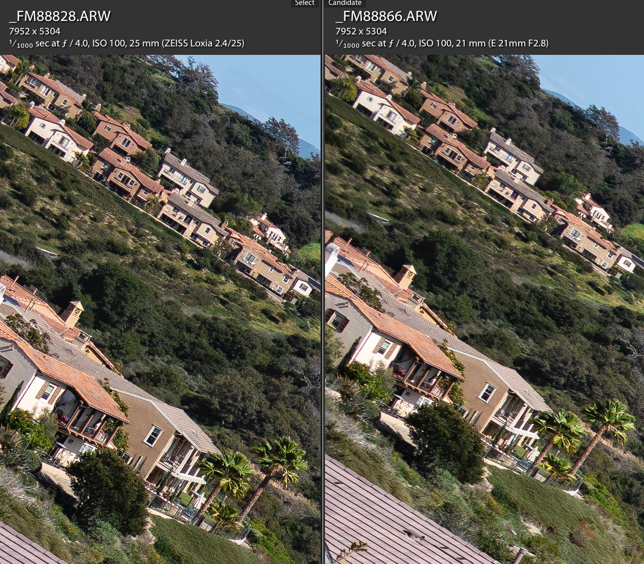

At f/4 (optimal for both lenses), the Loxia 25 is slightly ahead towards the corners. (It's a very small difference but it's there)
At f/5.6, same story and f/8 both show visible diffraction.
In real world images where extreme edges are not filled with small detail, I don't believe this can even be detected.
Apr 12, 2018 at 06:33 PM
Admin

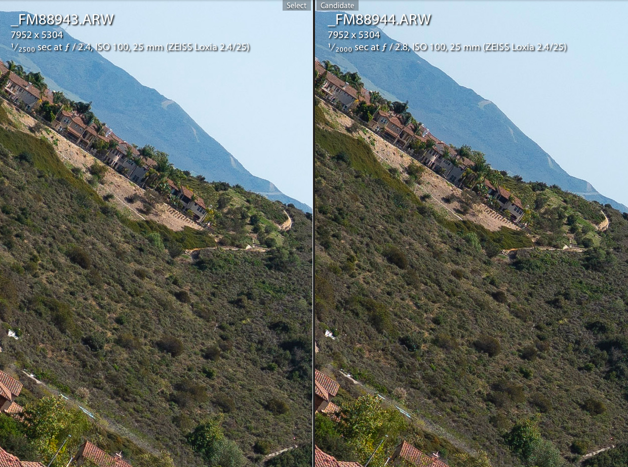

p.1 #3 · Loxia 25mm f/2.4 Distagon Tests and Comparisons

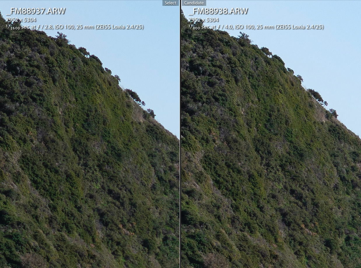

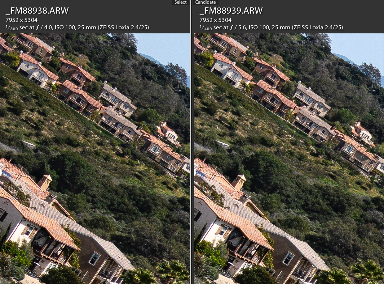

Their mid-zones are very similar even at f/5.6.
Apr 12, 2018 at 06:34 PM
Admin

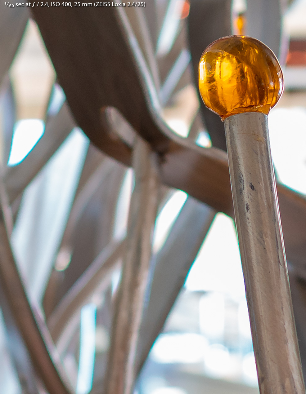

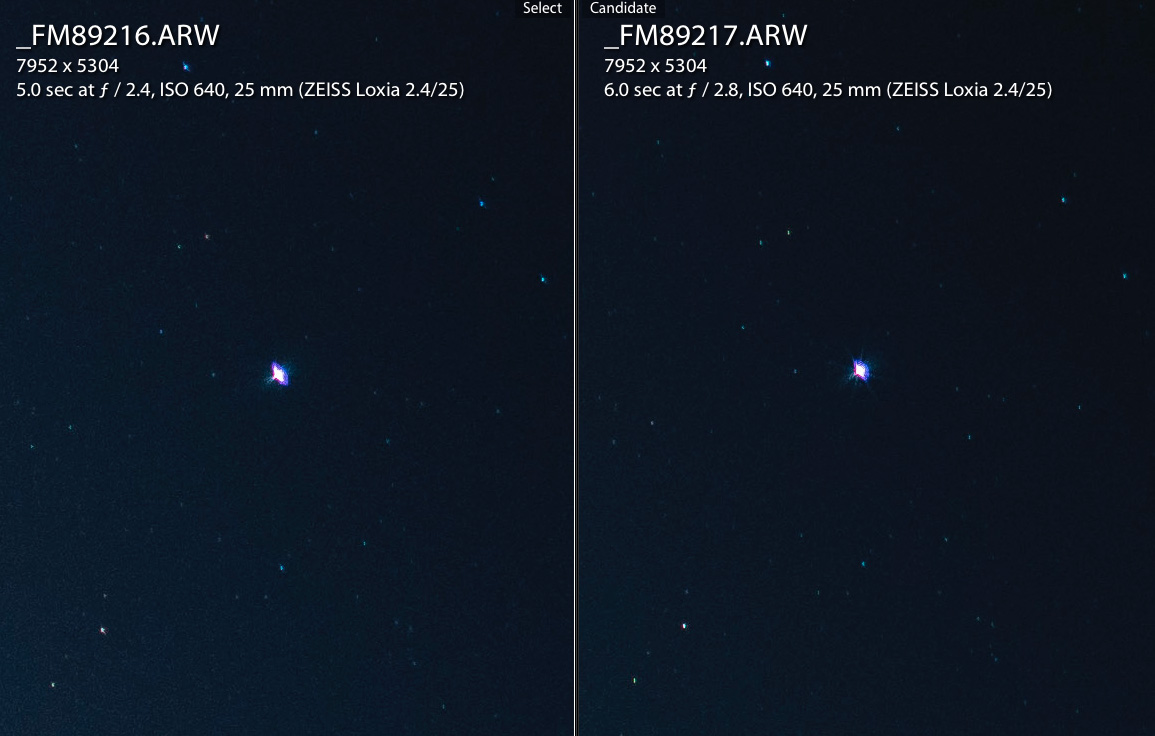

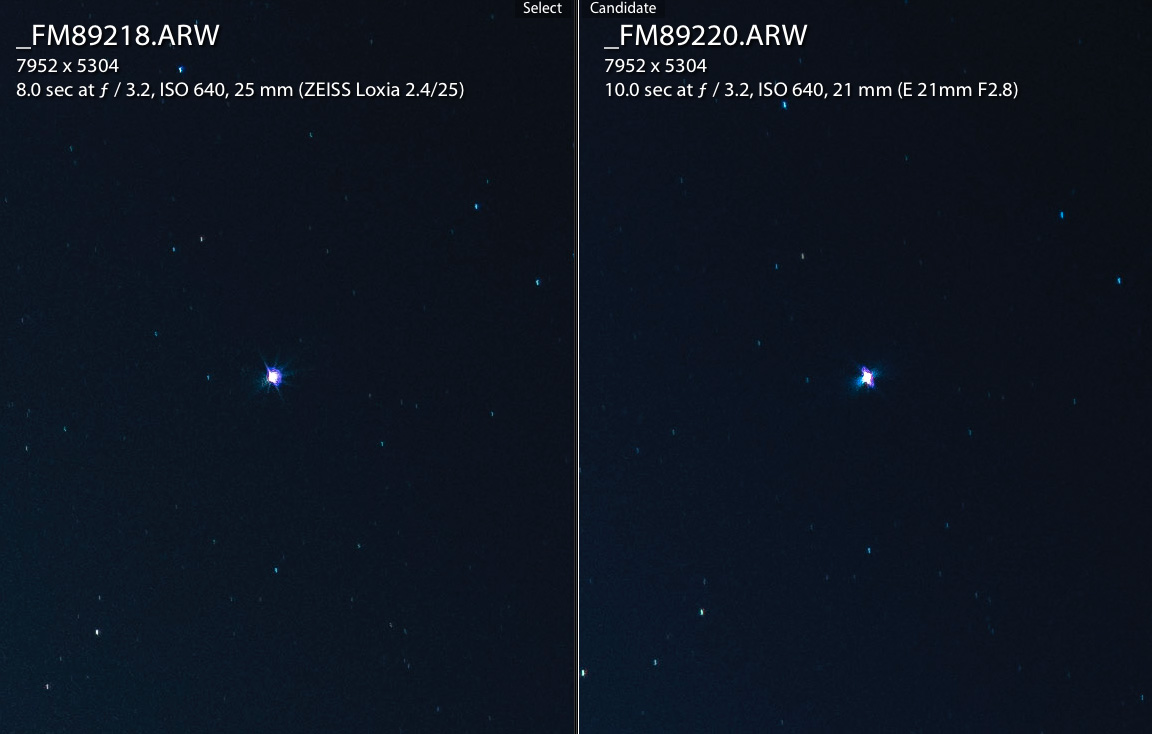

p.1 #4 · Loxia 25mm f/2.4 Distagon Tests and Comparisons
At center they are both so crispy at f/4, which seems to be optimum for both. Amazing performance so far.

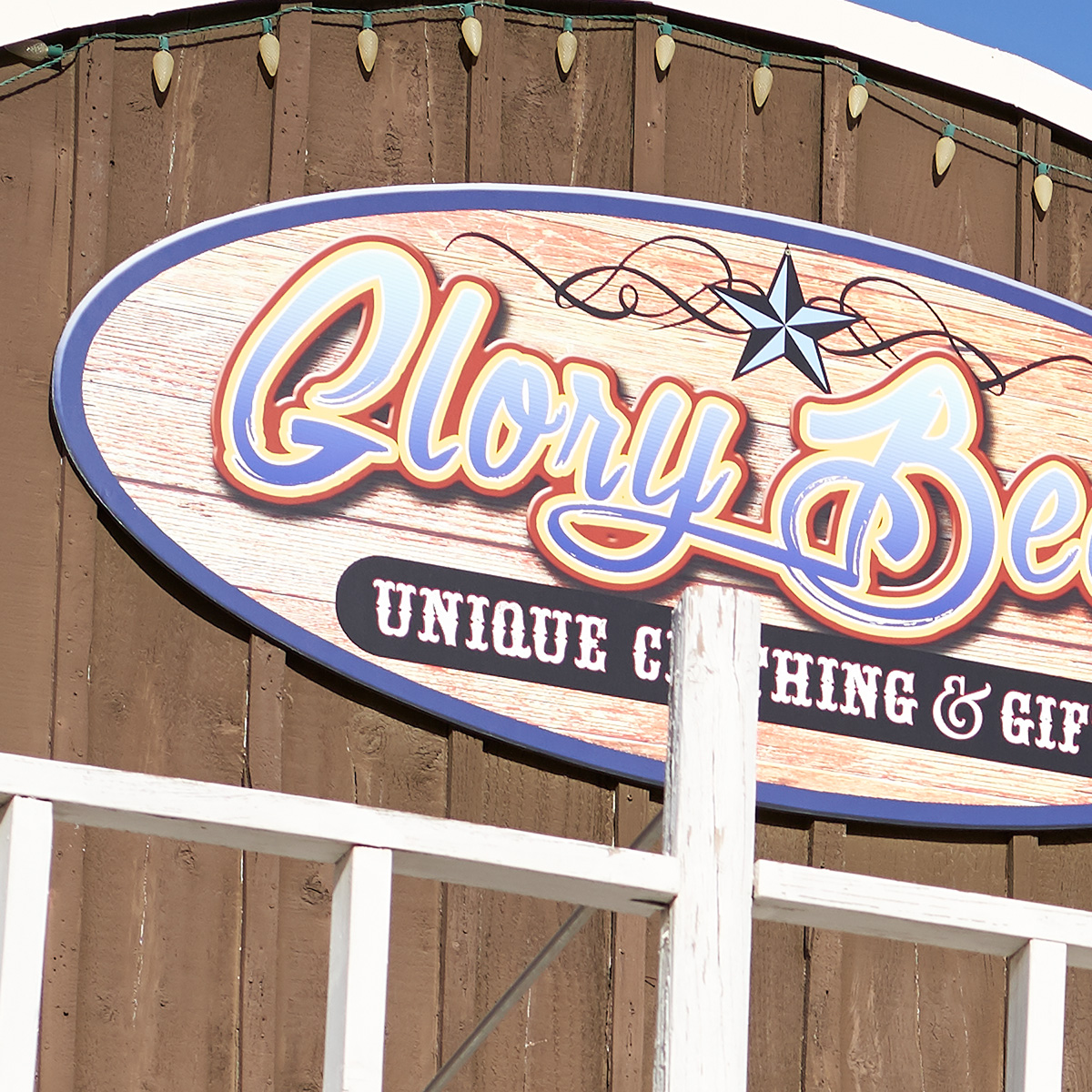

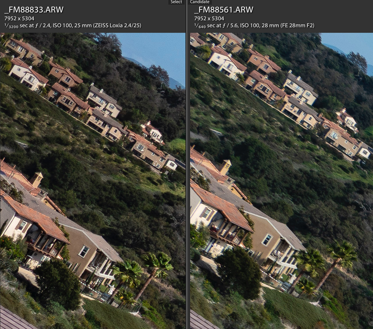

Here is the Loxia 25/2.4 @f/2.4 next to the FE 28/2 @f/5.6 towards the corners... (taken at different days)
Both lenses seem to be close to 26mm.
The resolution and contrast level is just not even comparable 2.5 stops apart. (especially towards the corners)
Apr 12, 2018 at 08:36 PM

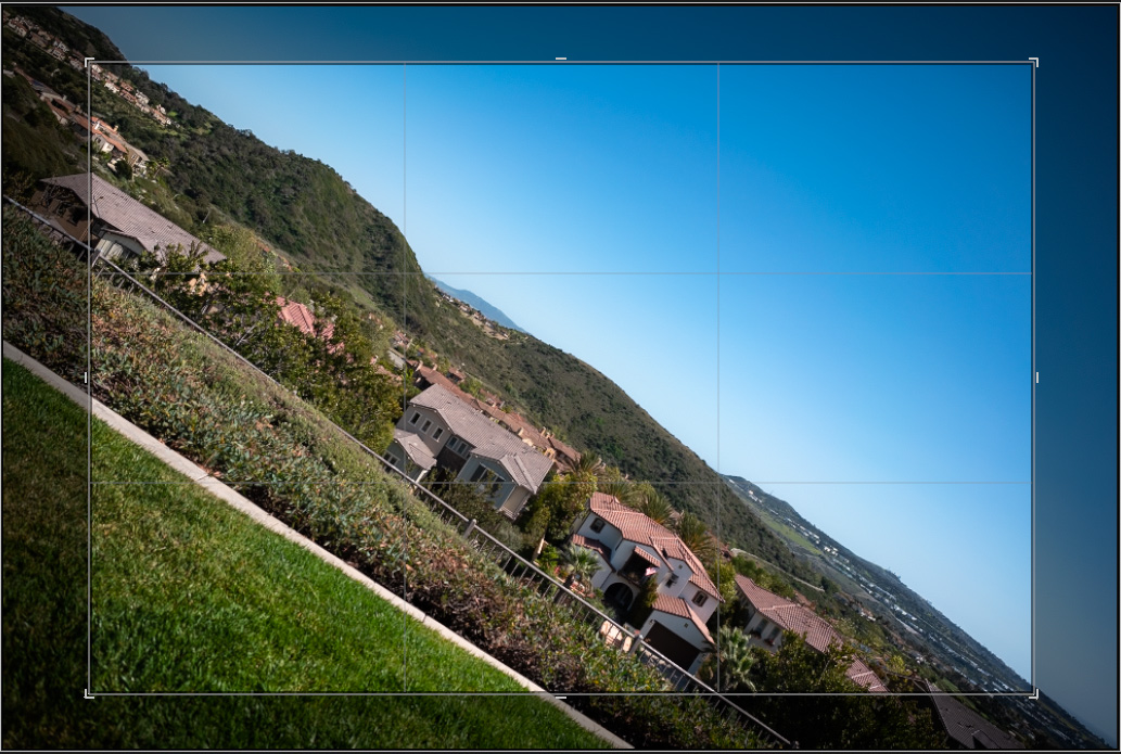

Admin
p.1 #12 · Loxia 25mm f/2.4 Distagon Tests and Comparisons
For those thinking about keeping both Loxia 21 and Loxia 25 lenses, here are resized images showing their field of view:

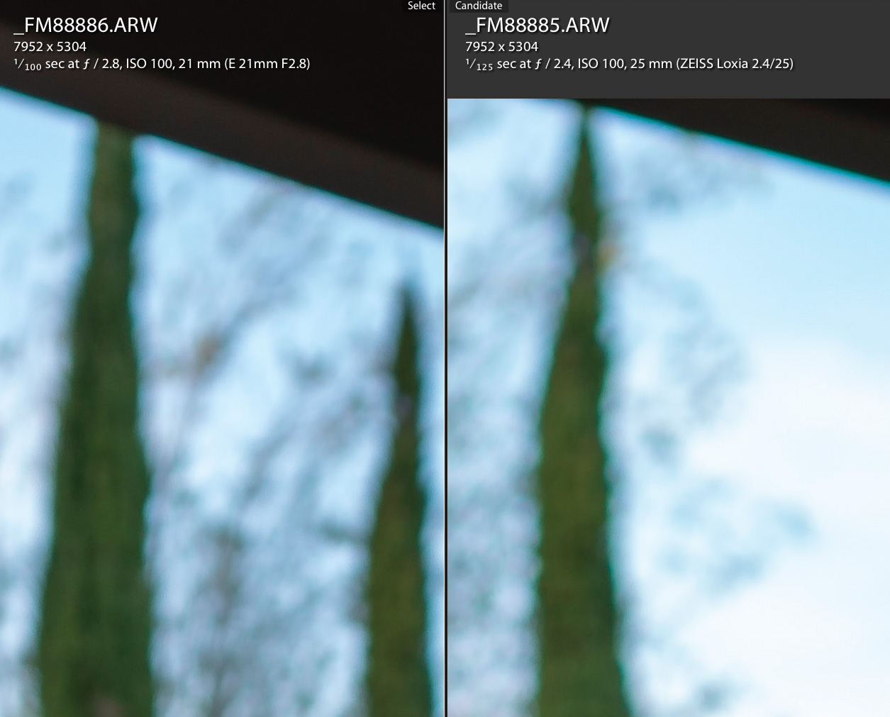

Admin
p.1 #18 · Loxia 25mm f/2.4 Distagon Tests and Comparisons

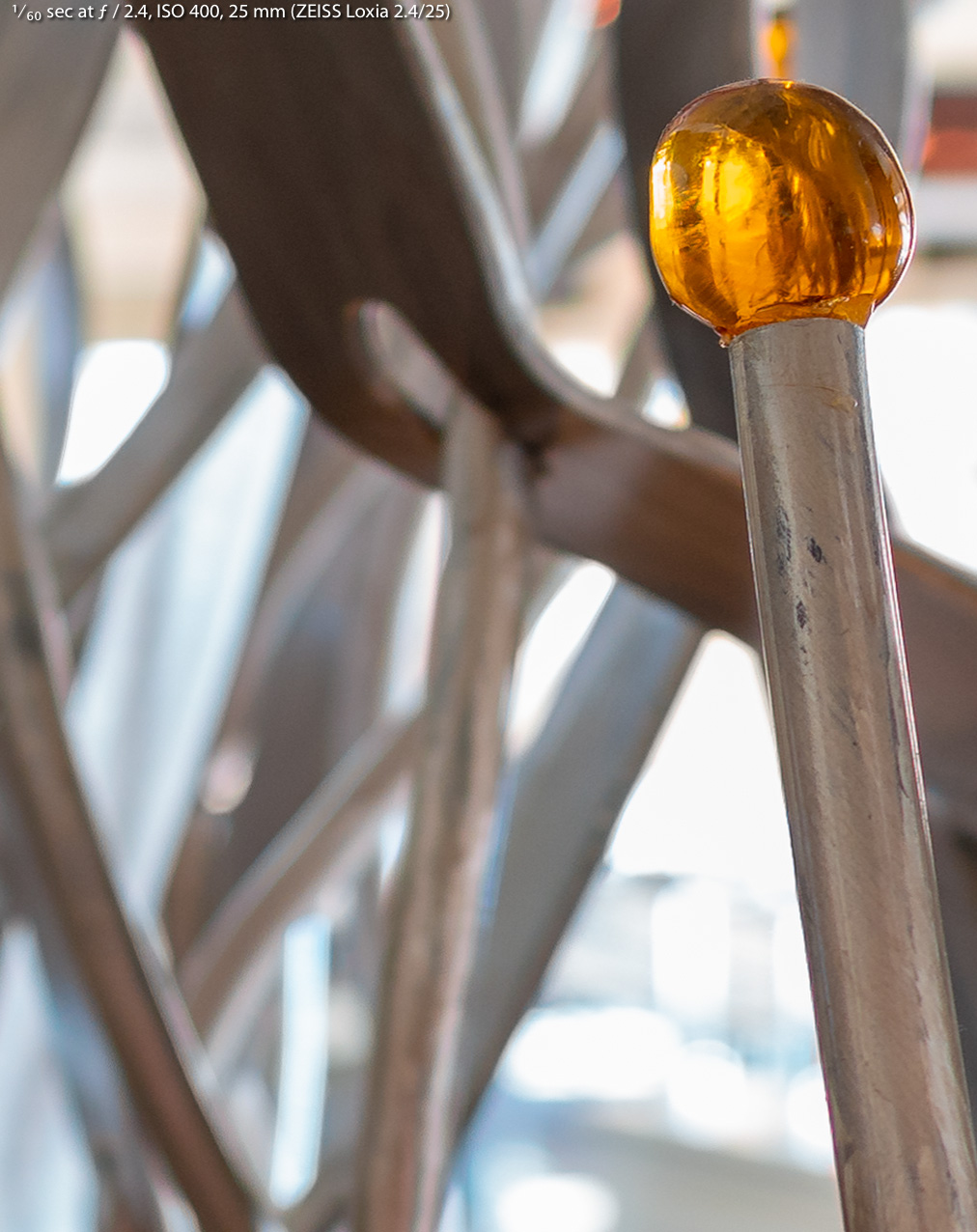

The Loxia 25/2.4 is not as well corrected for axial CA compared to the Loxia 21. Here are a few samples under low contrast lighting. (Expect more CA under high contrast lighting)
thumb: Lox 21 (top), Lox 25 (bottom)
Both lenses wide open (1:1)
thumb: Lox 25 (top), Lox 21 (bottom)
