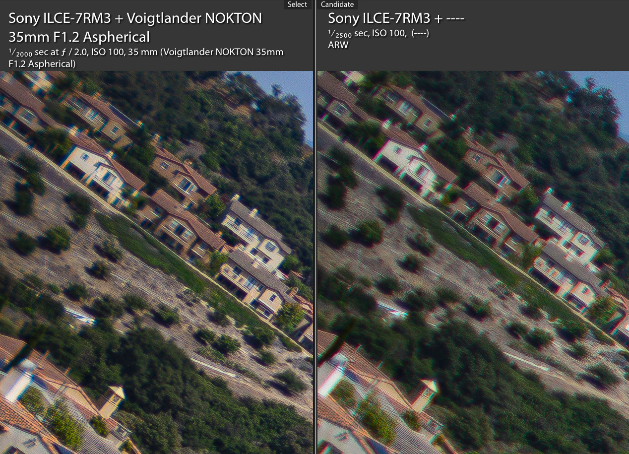

Let's start with some infinity tests to see how the new Voigtlander Nokton 35mm f/1.2 Aspherical III performs in regards to resolution, contrast, vignetting and color aberration. Just like the Voigtlander 40/1.2 and 50/1.2 Nokton lenses, the new CV 35mm f/1.2 III is not equipped with a floating system so it performs way better at infinity compared to closer distances. At distances closer than 1m, spherical aberration is very noticeable and images will have lower contrast, resolution and some haze.

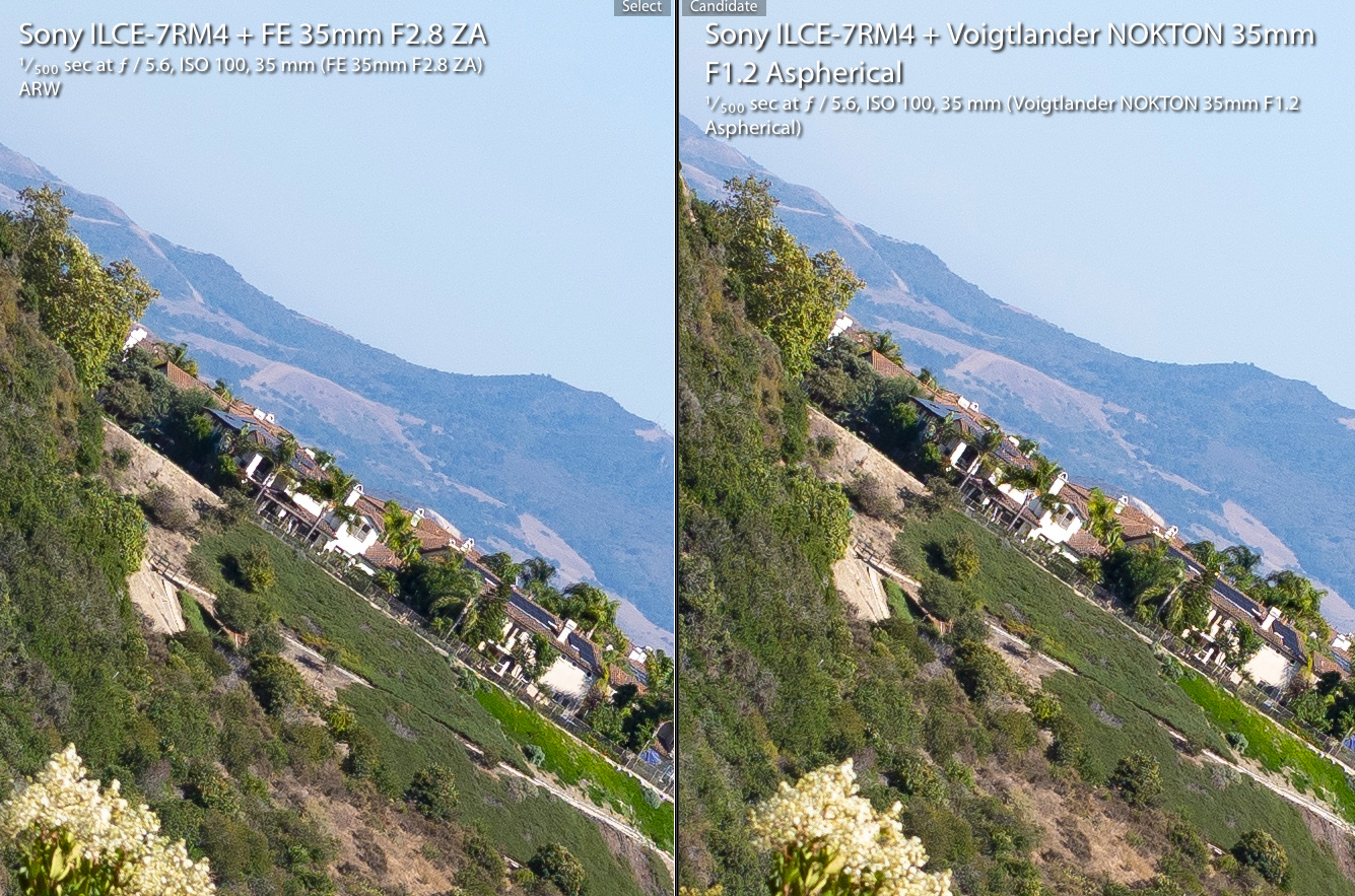

Here is a summary with links to the tests and samples images:
  1. Voitlander 35mm f/1.2 SE Infinity distance test for Resolution and Contrast

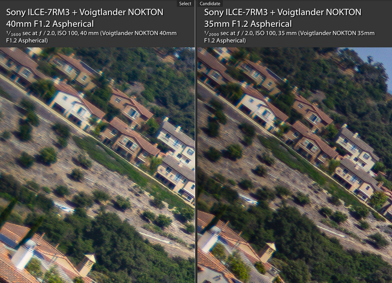

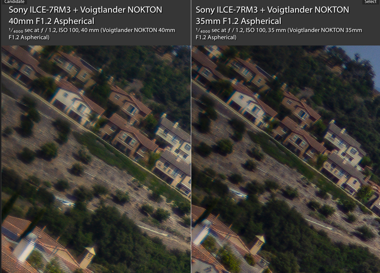

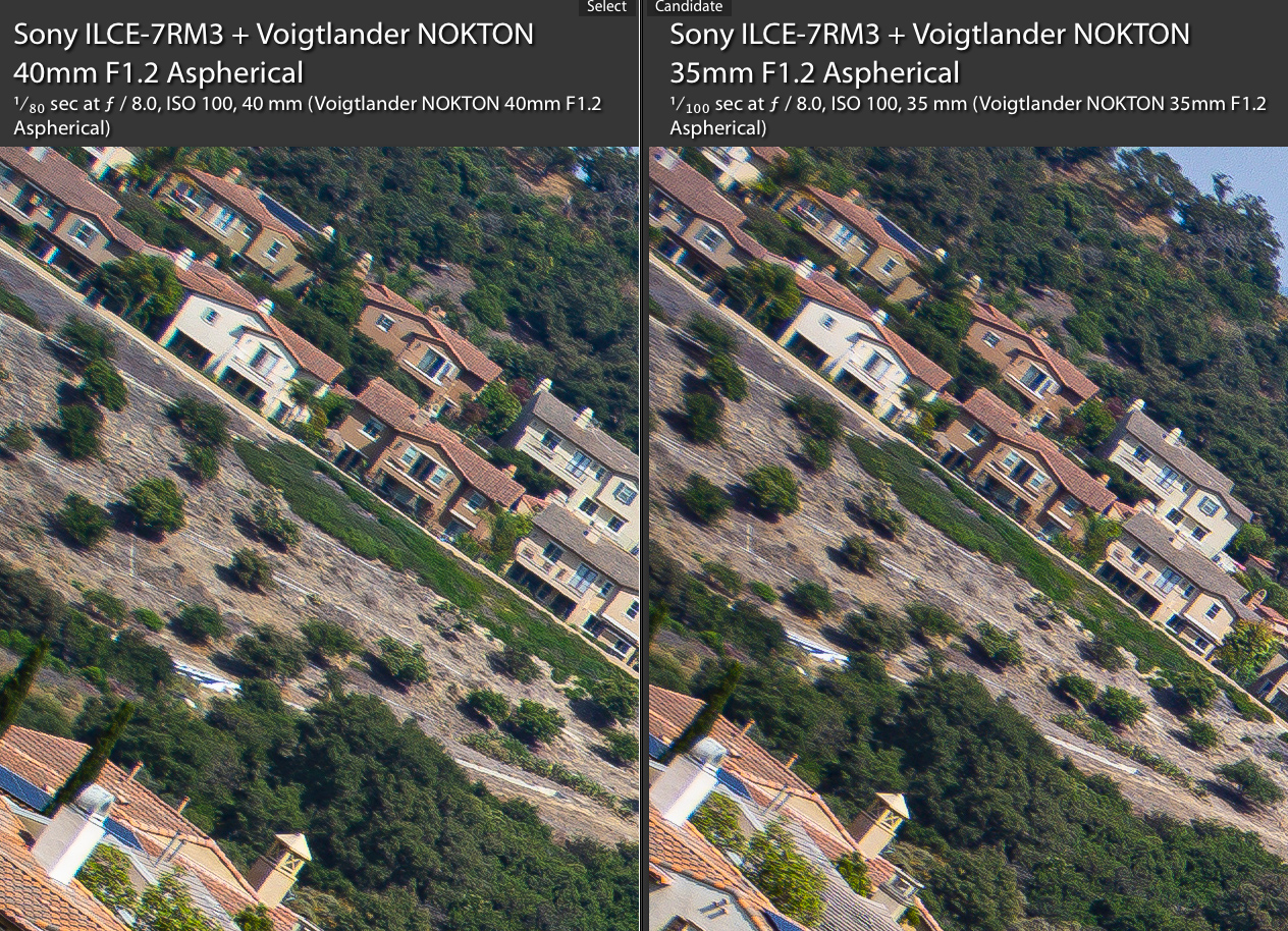

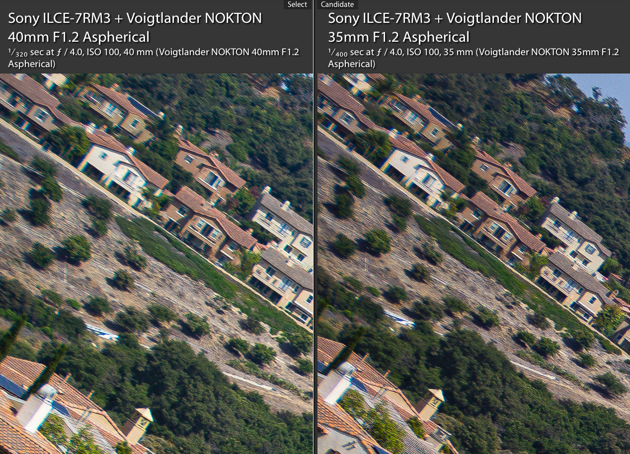

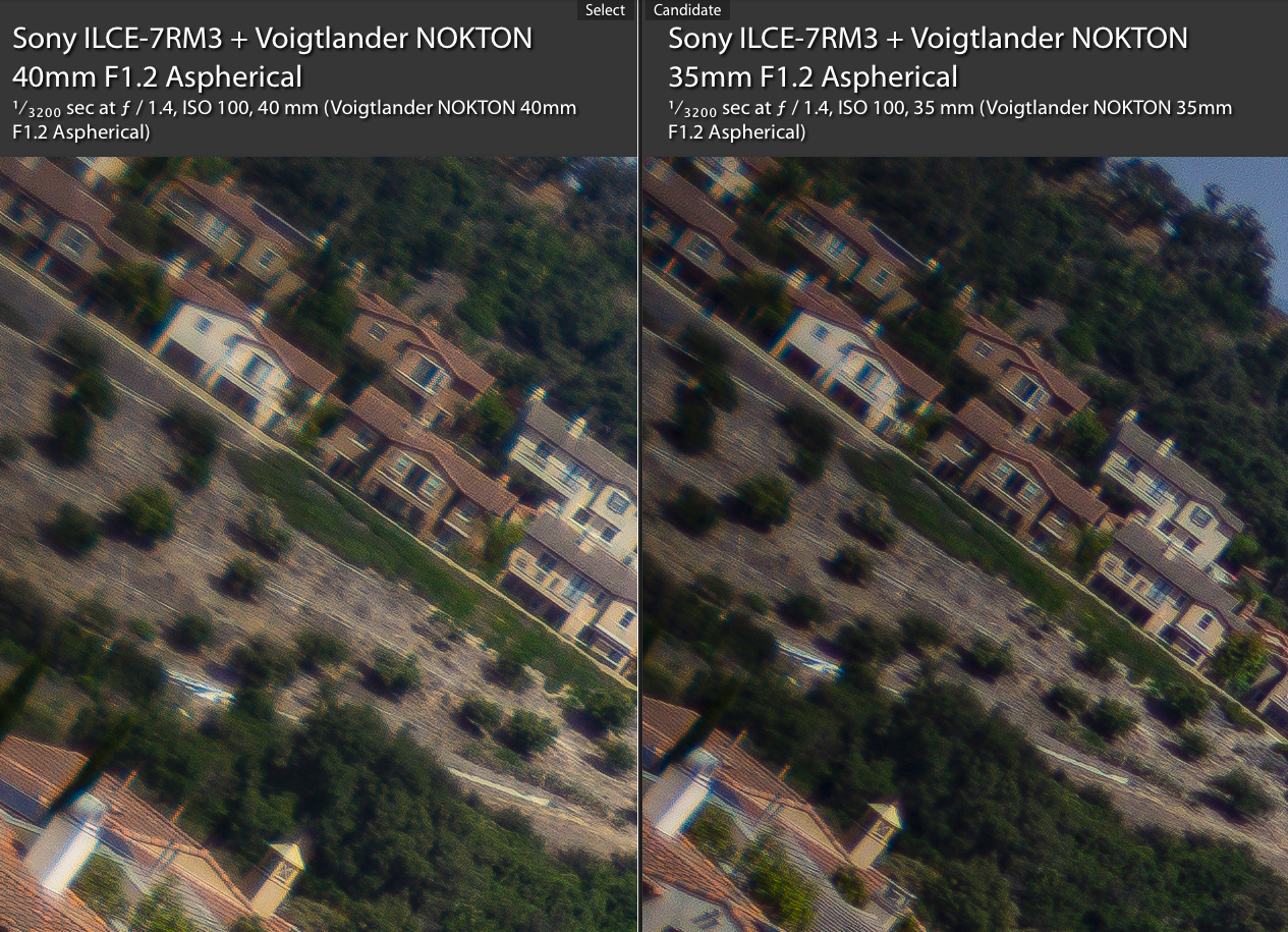

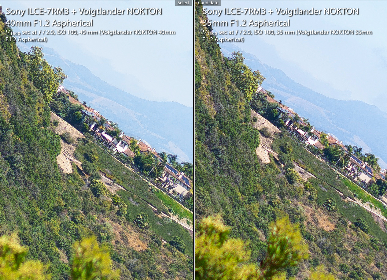

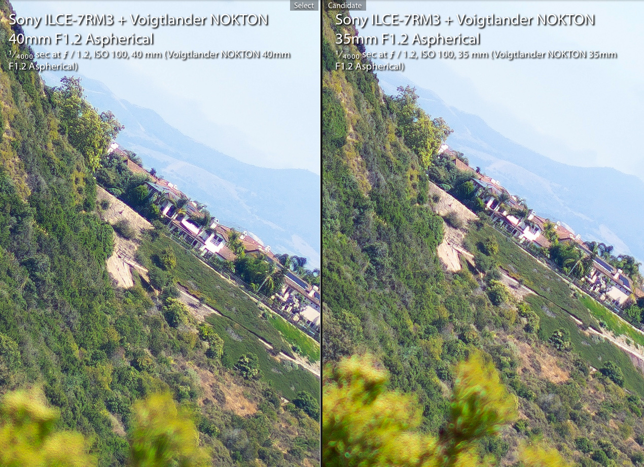

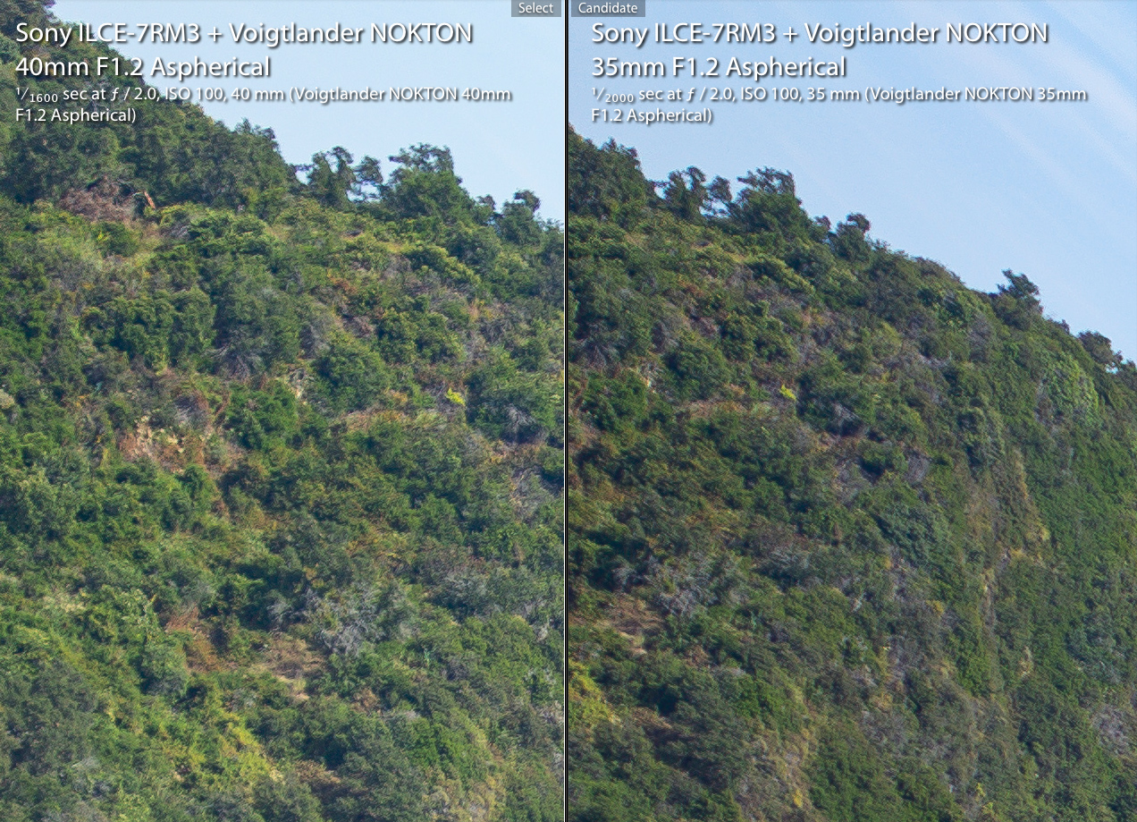

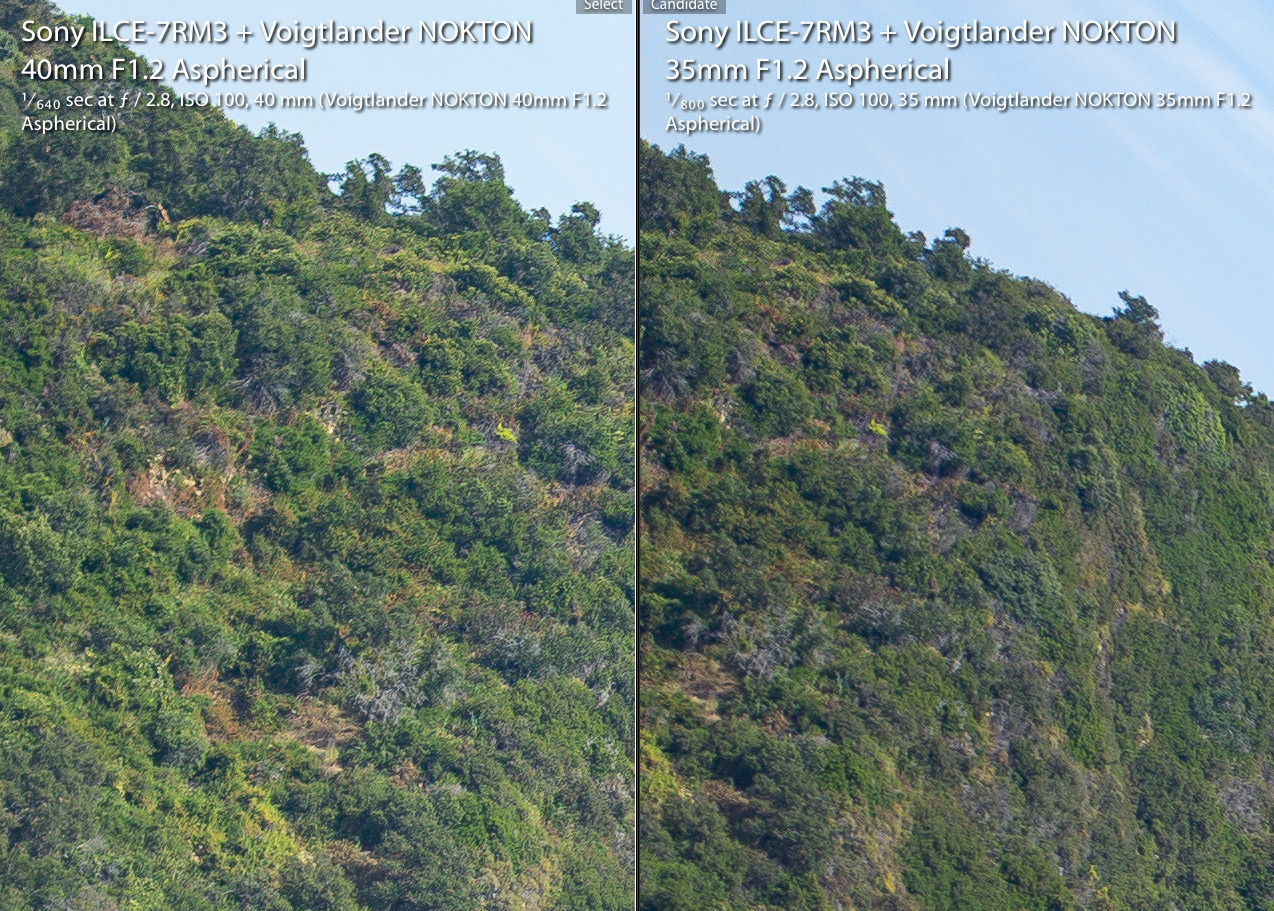

  2. Voigtlander 35mm f/1.2 SE vs 40mm f/1.2 SE

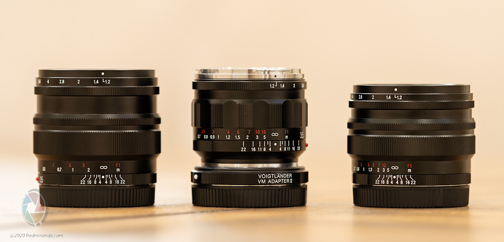

  3. Voigtlander 35mm f/1.2 SE vs 35mm f/1.2 III VM + adapter
  4. Voigtlander 35mm f/1.2 vs Sony FE 35/2.8 ZA @f/5.6

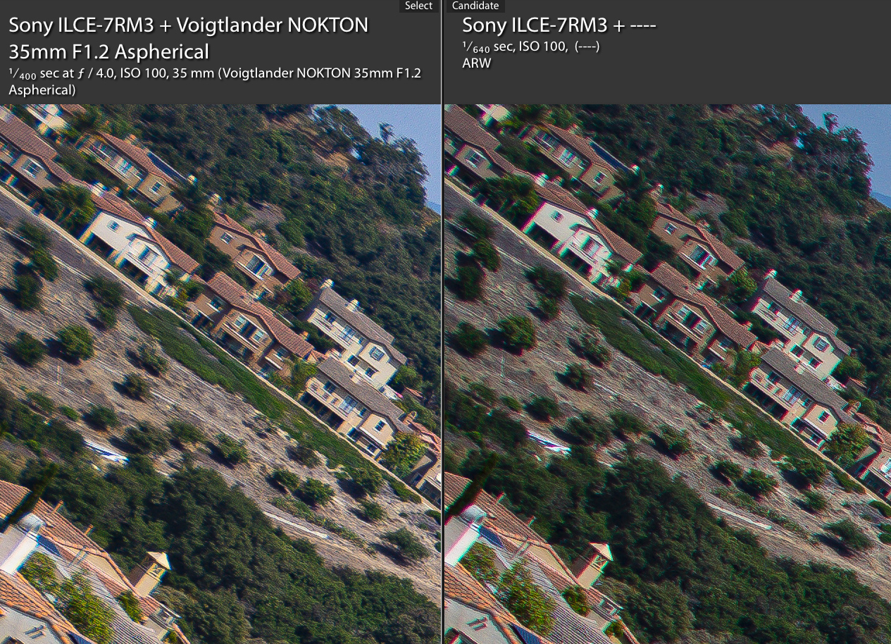

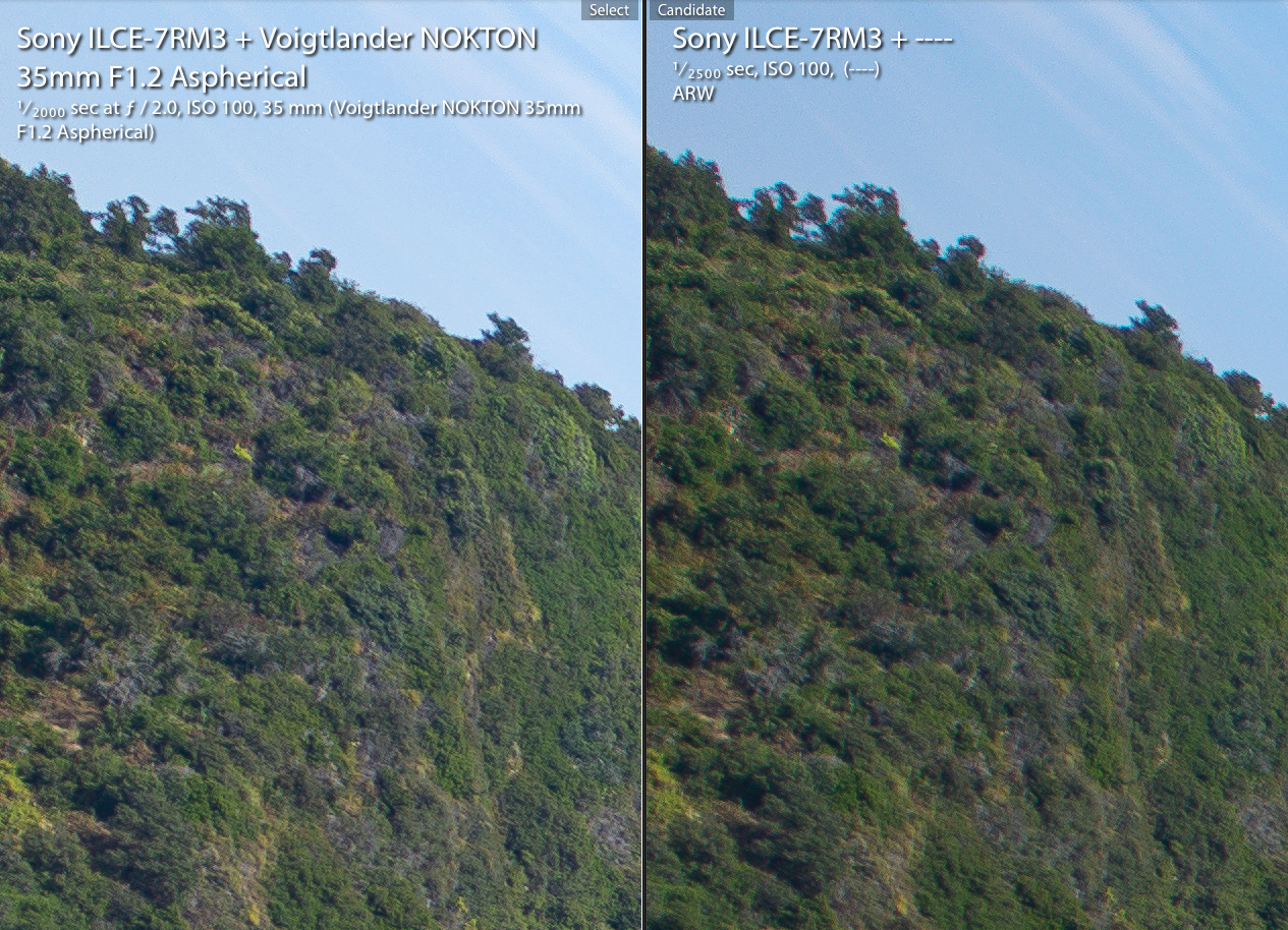

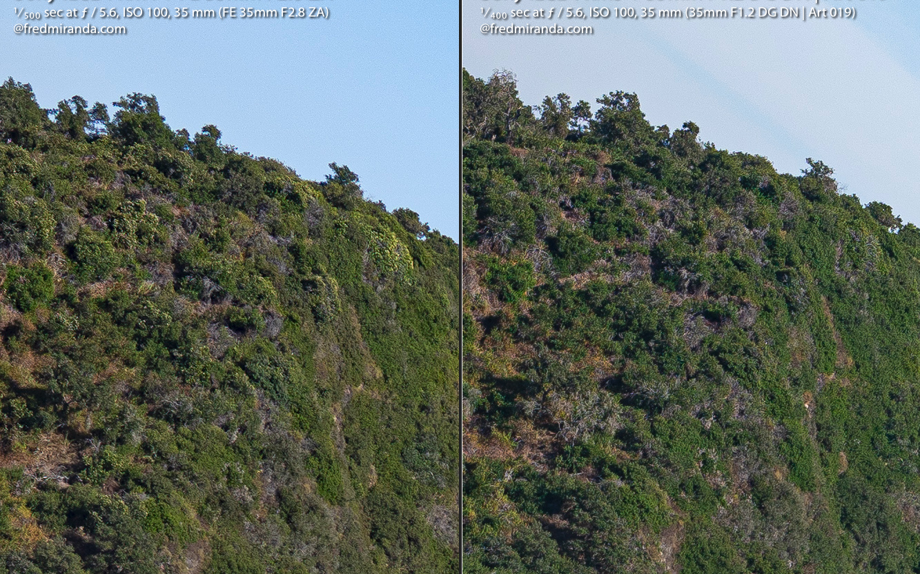

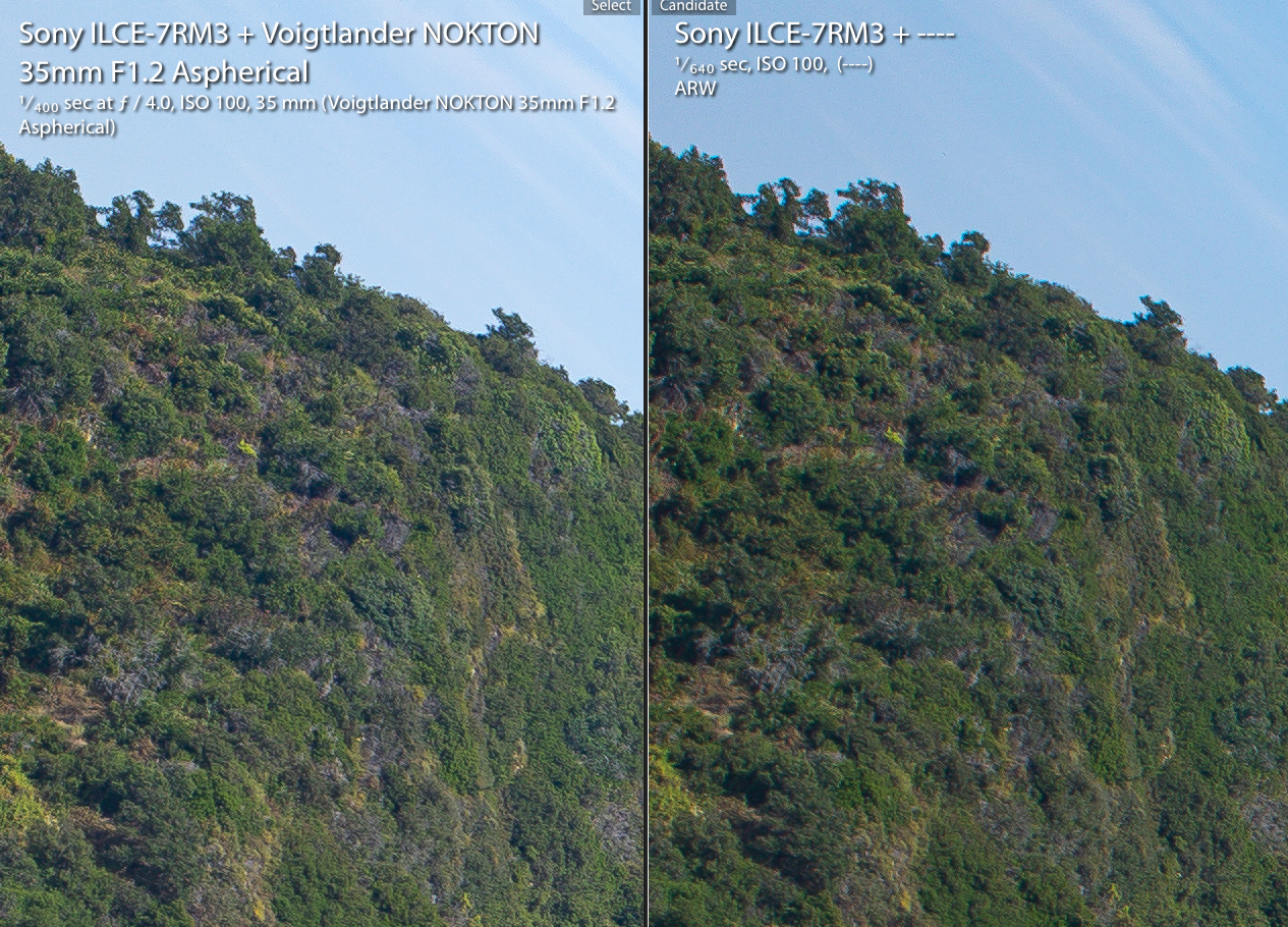

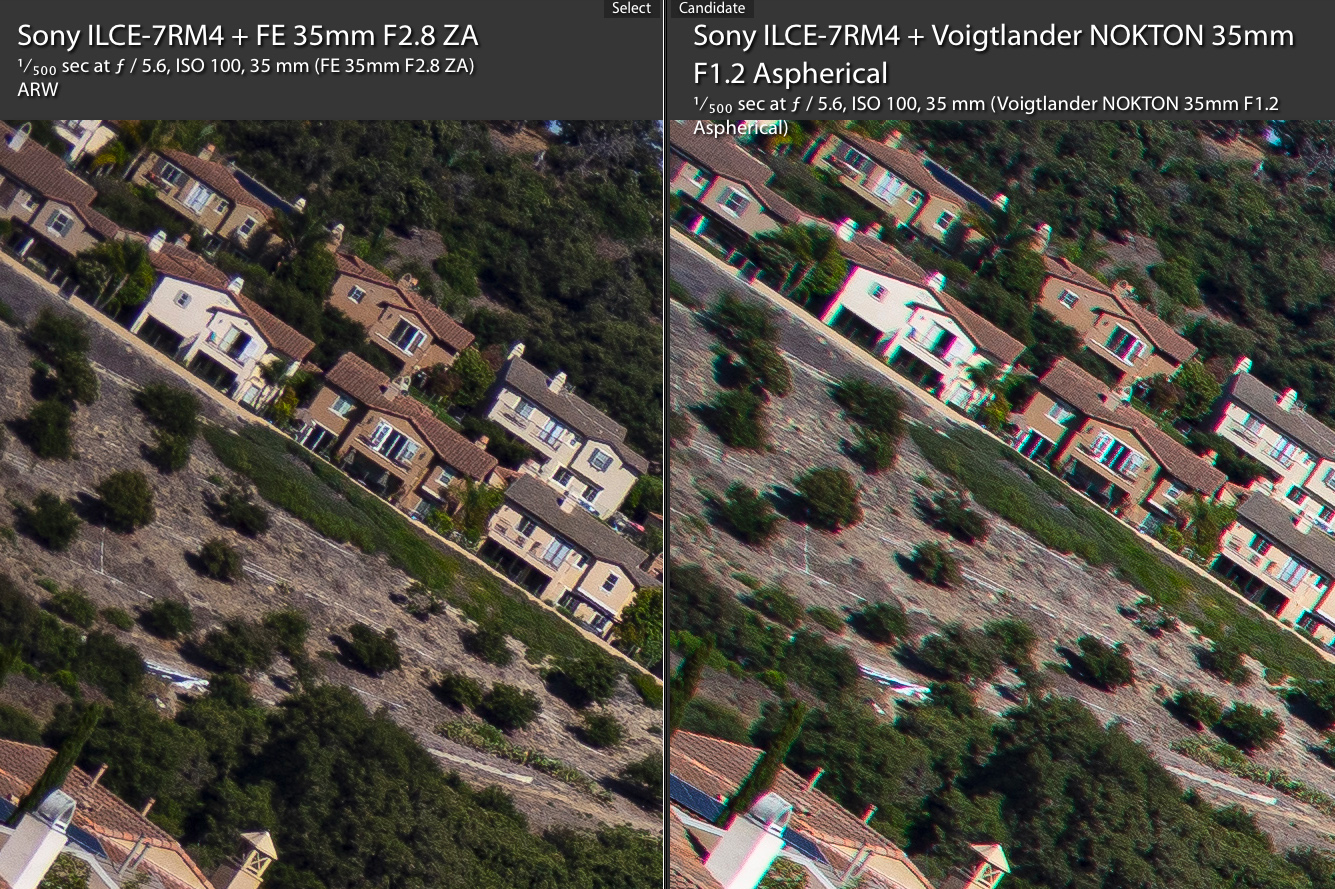

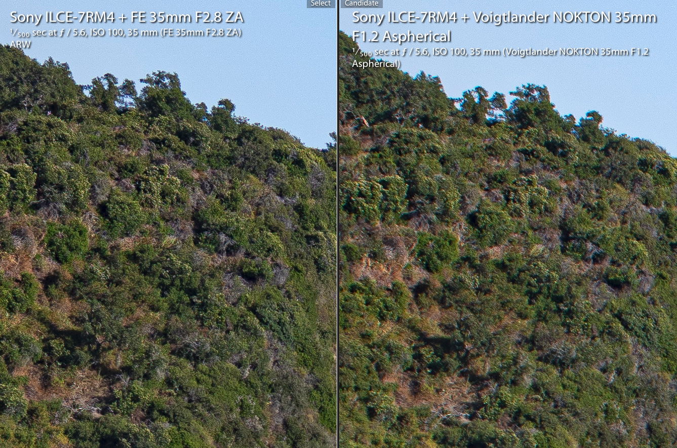

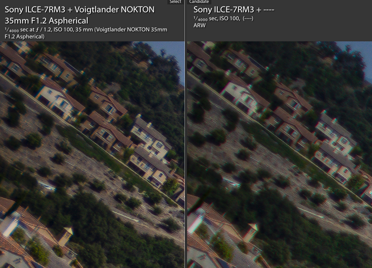

  5. Chromatic Aberration (LaCA)

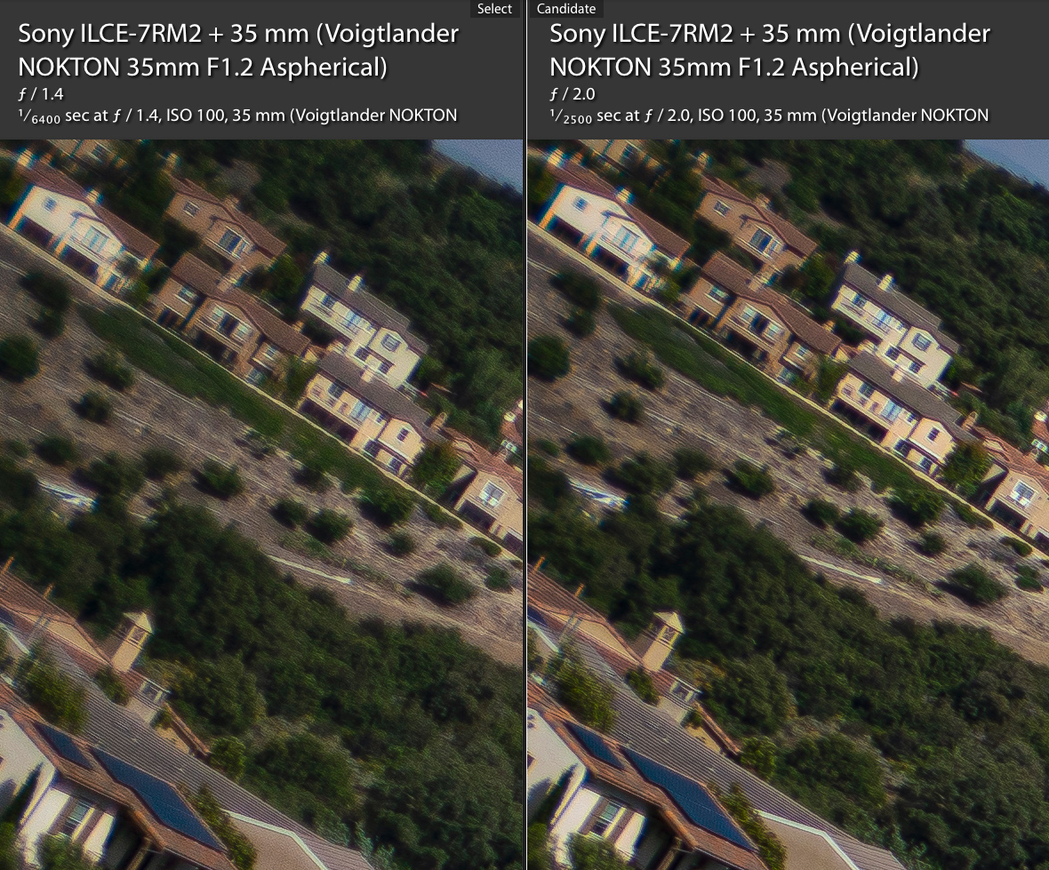

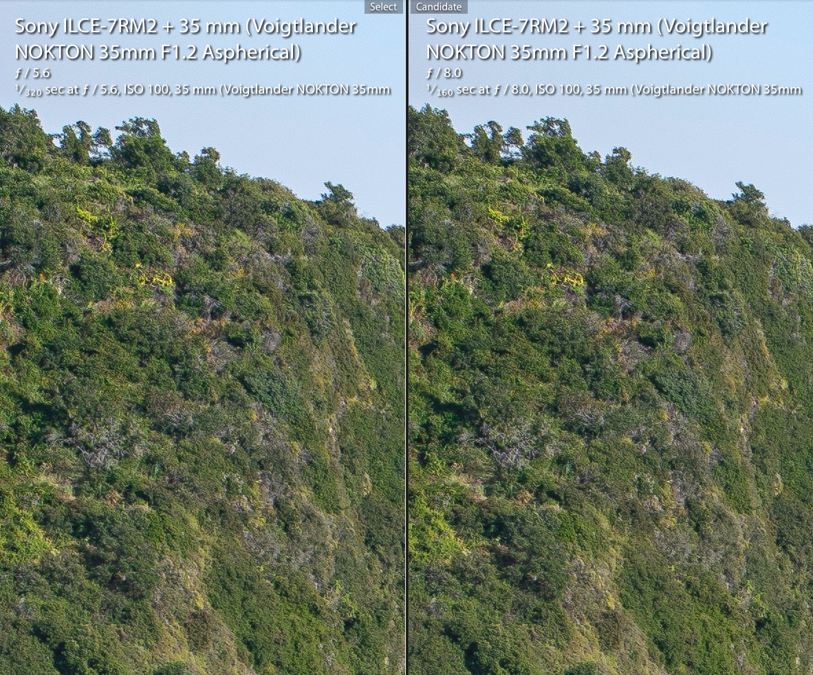

p.1 #2 · Voigtlander 35mm f/1.2 Nokton Aspherical Review

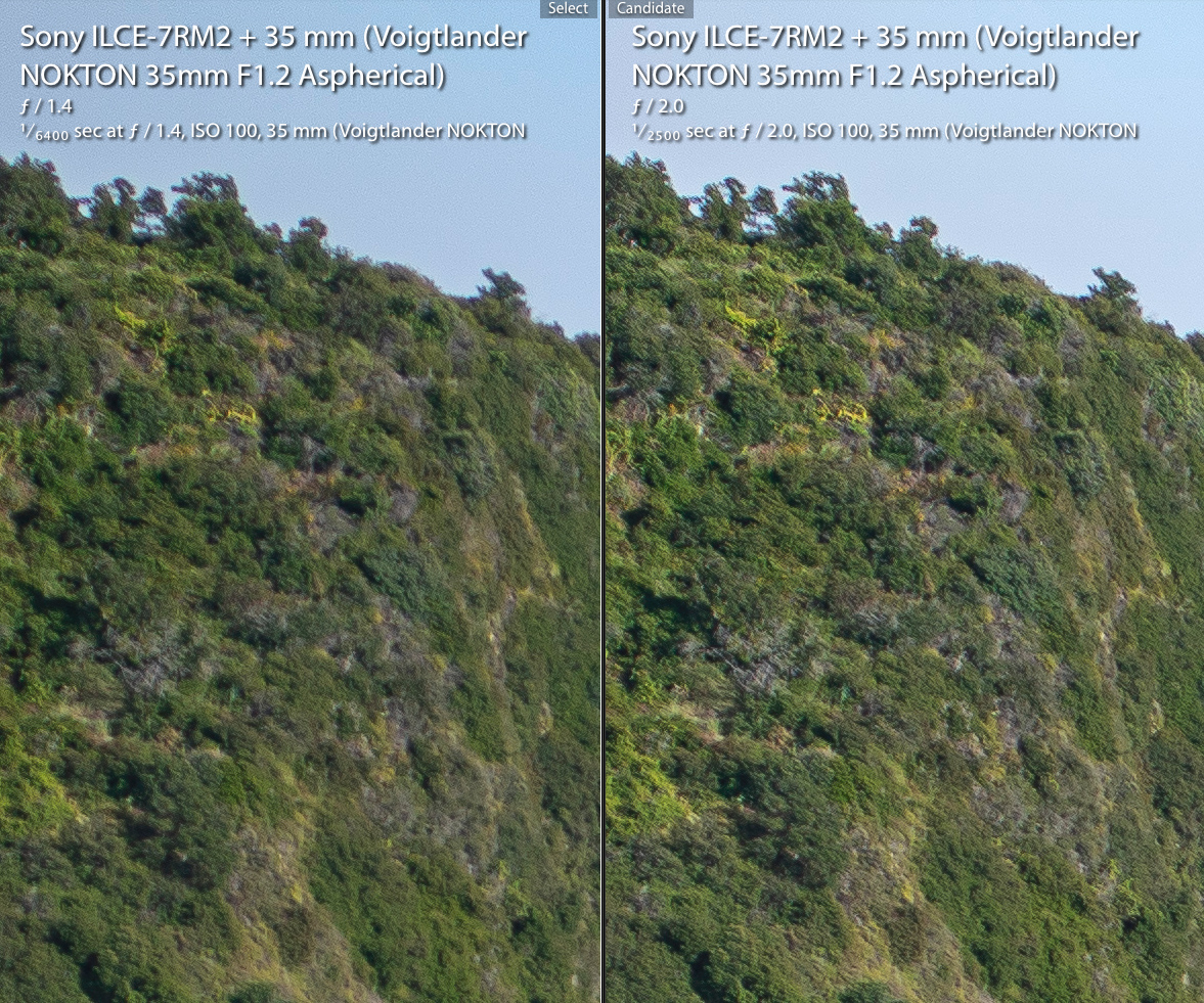

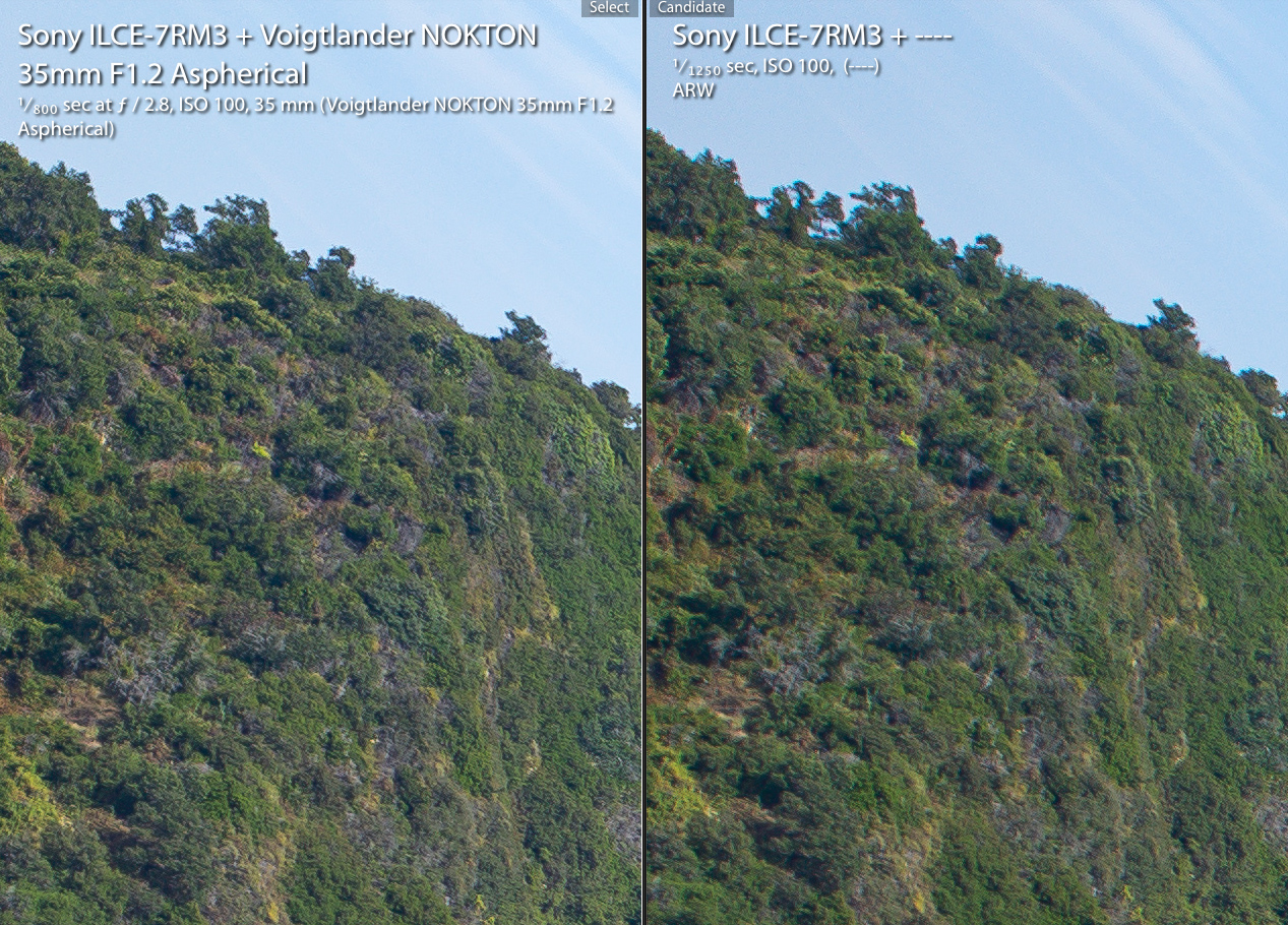

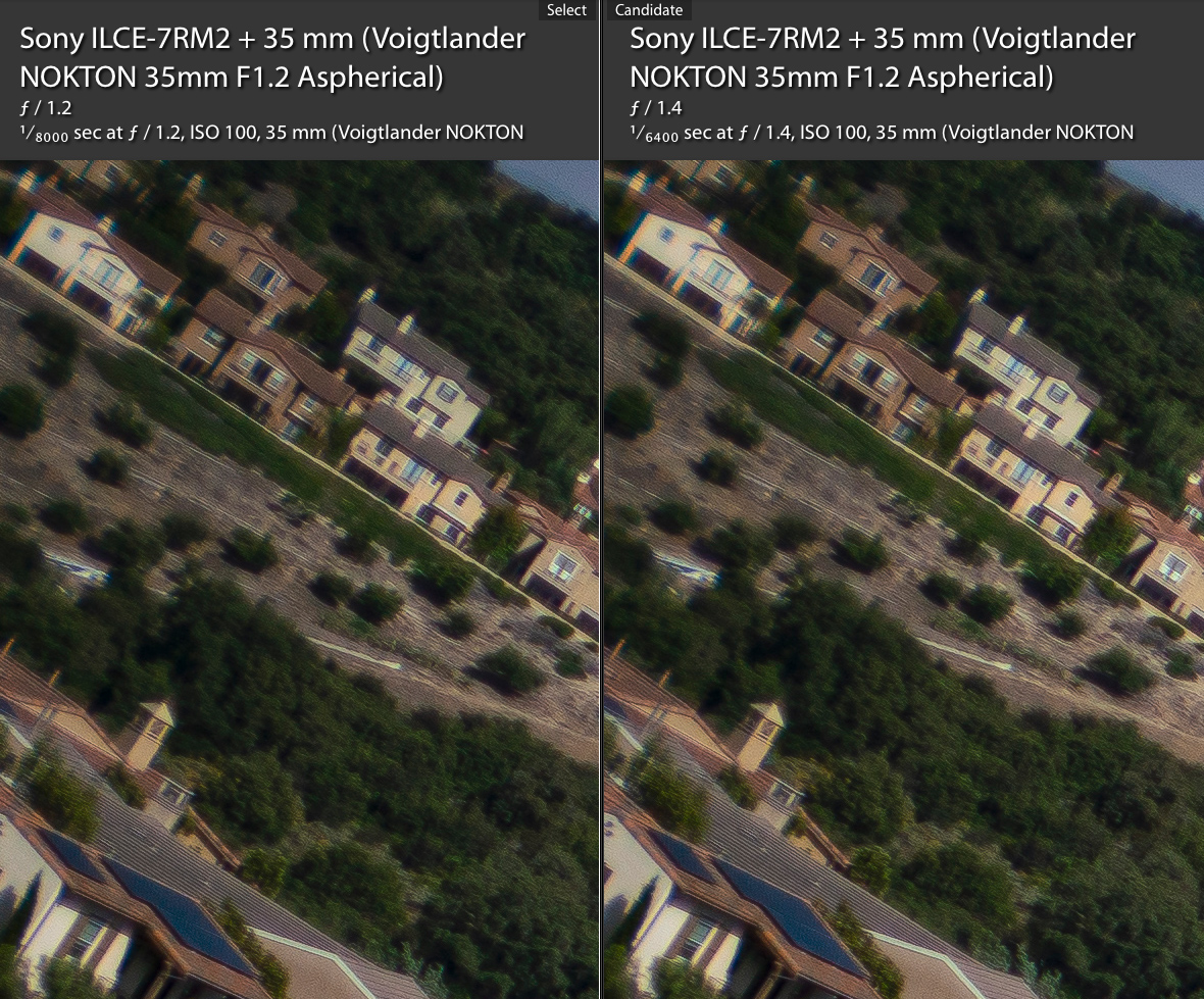

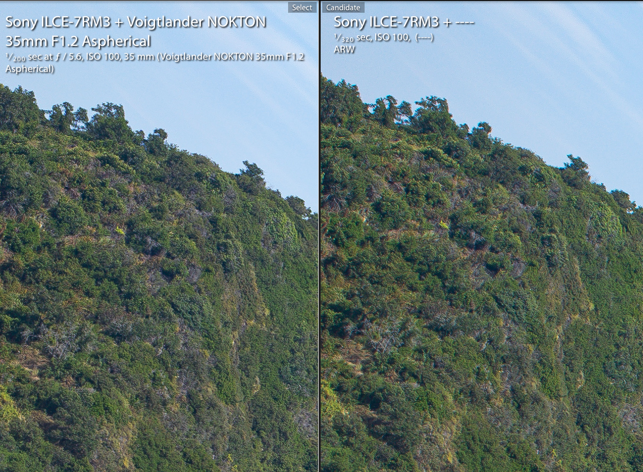

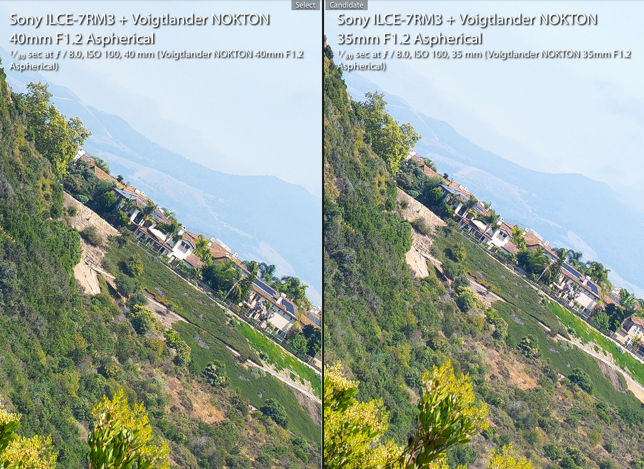

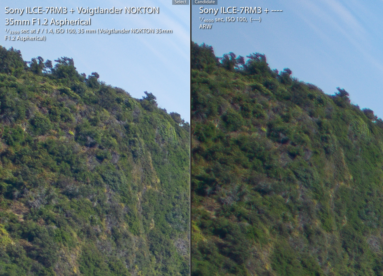

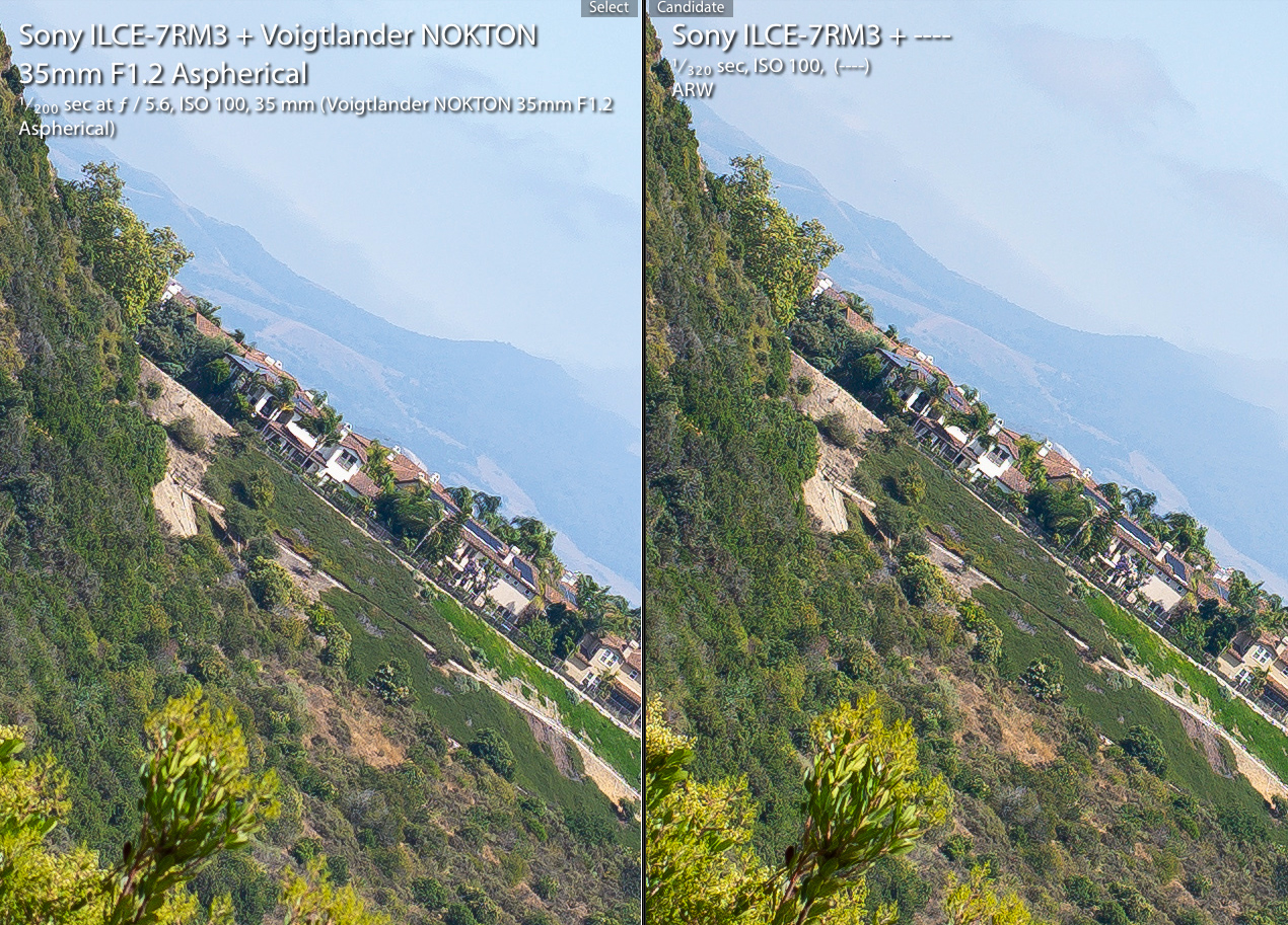

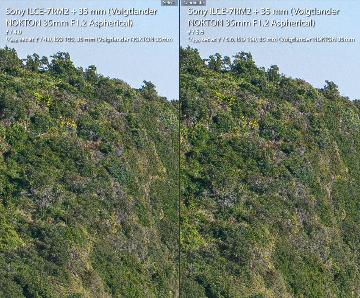

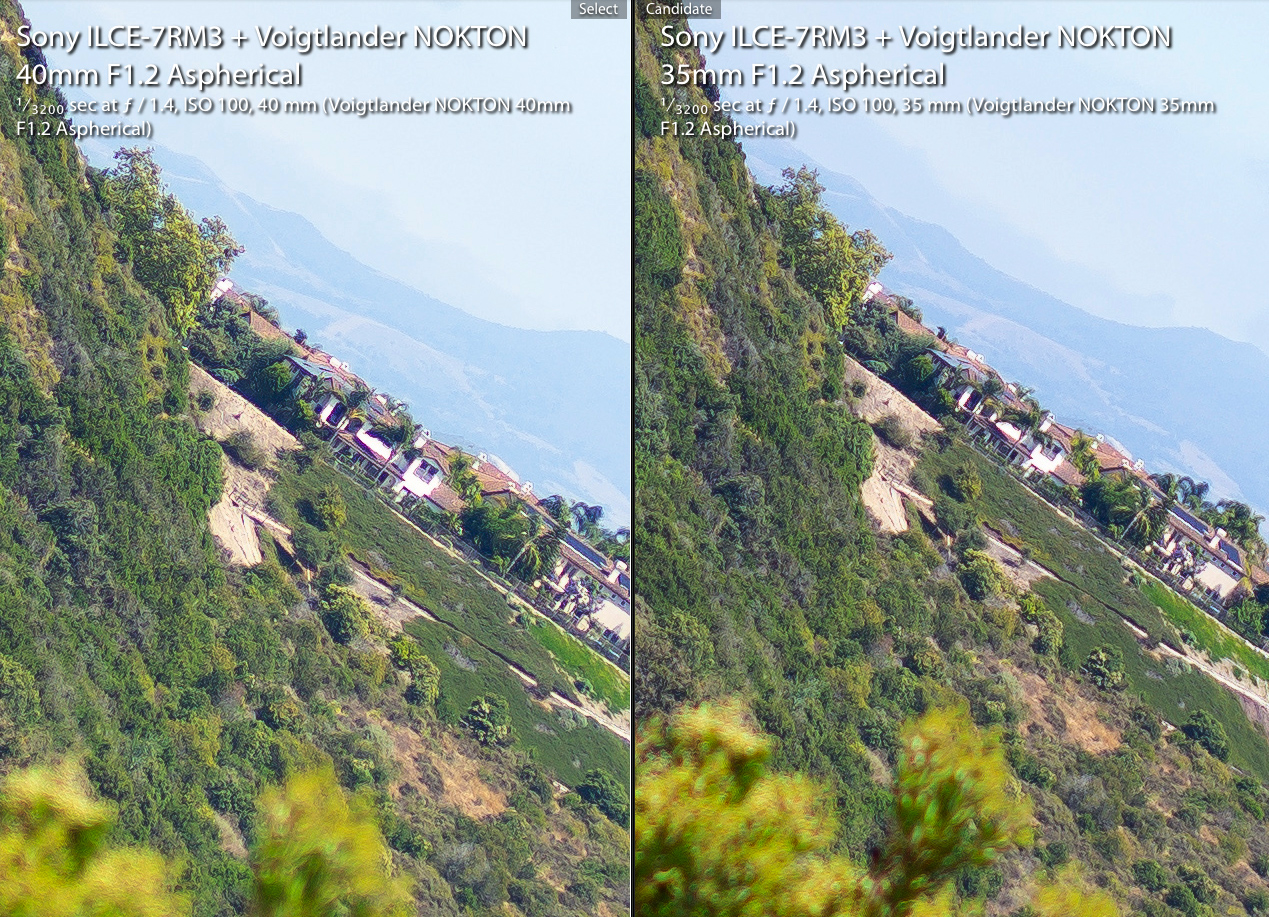

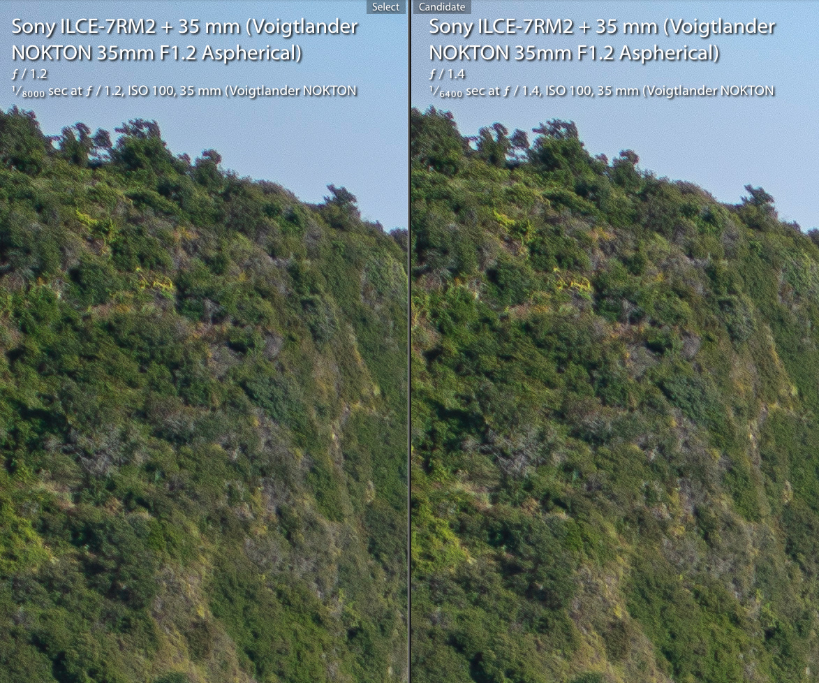

Infinity Distance test for Resolution and Contrast
Here is the full image thumbnail showing the areas demonstrated at 1:1 magnification.
  1. Distance: Infinity
  2. Focus: Center - Best of three @ 12.4x magnification
  3. WB: Daylight
  4. Lens perfectly centered using my decentering test
  5. Software: Lightroom with my default landscape sharpening. All other settings set to default
PS: Vignetting and distortion were NOT corrected. All in-camera corrections turned 'off'.
Center Area

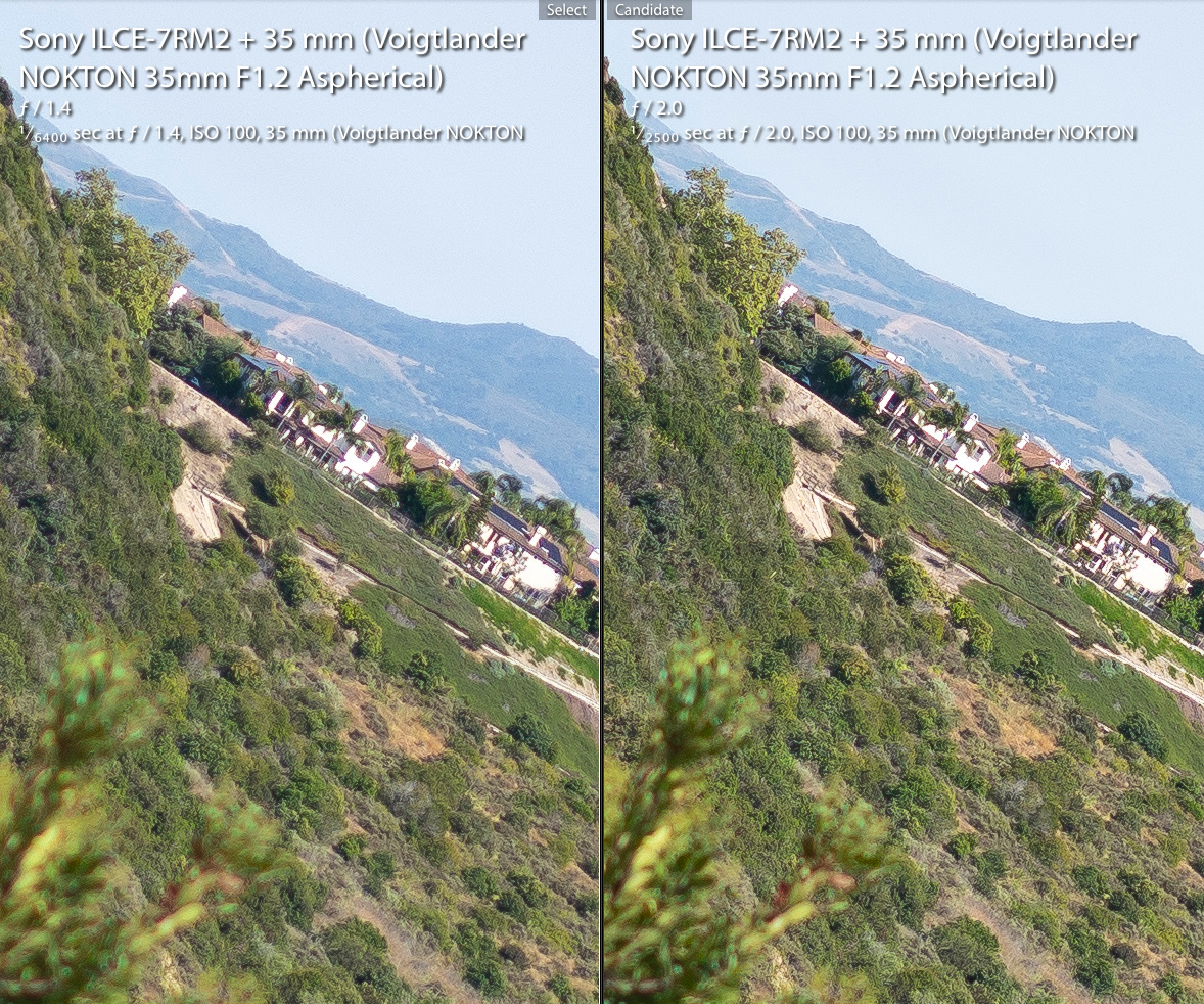

Center at f/1.2 vs f/1.4: Good performance at infinity distance. f/1.4 slightly better. Color aberration is noticeable (purple fringing)
Center at f/1.4 vs f/2: There is a small jump in clarity and overall contrast at f/2. Purple fringing starts to subside.
Center at f/2 vs f/2.8: Excellent performance at f/2.8. Almost absent of color error and high contrast and resolution
Center at f/2.8 vs f/4: At f/4, the center area is optimal. Very strong performance
Center at f/4 vs f/5.6: Very similar performance at these apertures
Center at f/5.6 vs f/8: Still great at f/8, although diffraction starts to creep in.
Jun 08, 2020 at 07:16 PM
Admin
p.1 #3 · Voigtlander 35mm f/1.2 Nokton Aspherical Review

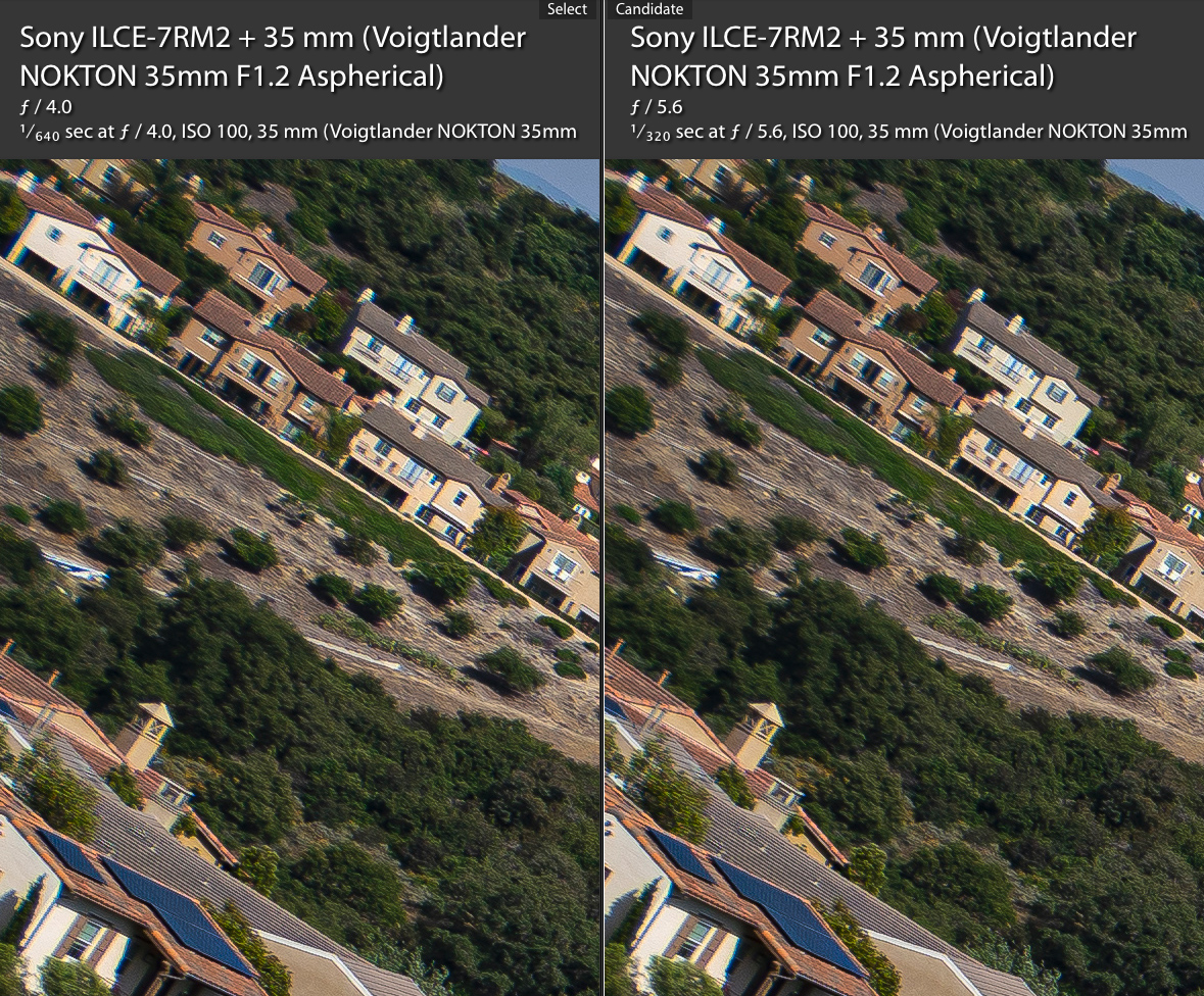

Mid-Field Area
Mid-field f/1.2 vs f/1.4: A little soft at the mid-field area, especially wide open
Mid-field f/1.4 vs f/2: Just like at center, there is a jump in IQ starting at f/2
Mid-field f/2 vs f/2.8: Mid-field area improves further at f/2.8. It's now at good level
Mid-field f/2.8 vs f/4: Very good performance at f/4 with a noticeable improvement from f/2.8
Mid-field f/4 vs f/5.6: Higher resolution at f/5.6. (Optimal for this area)
Mid-field f/5.6 vs f/8: There are similar at these apertures. Perhaps a tad better at f/8
Jun 08, 2020 at 07:18 PM
Admin
p.1 #4 · Voigtlander 35mm f/1.2 Nokton Aspherical Review
Extreme Corner Area
Extreme corner f/1.2 vs f/1.4: Very similar at apertures. Strong astigmatism but still "ok" resolution/contrast
Extreme corner f/1.4 vs f/2: Noticeable improvement at f/2 but astigmatism still present
Extreme corner f/2 vs f/2.8: At f/2.8 there is a jump in IQ towards the corners. higher contrast and resolution and lower astigmatism
Extreme corner f/2.8 vs f/4: IQ improves further at f/4. (approaching the optimal aperture for this area)
Extreme corner f/4 vs f/5.6: Small improvement and now the optimal aperture for the corners
Extreme corner f/5.6 vs f/8: Very similar IQ at these apertures.

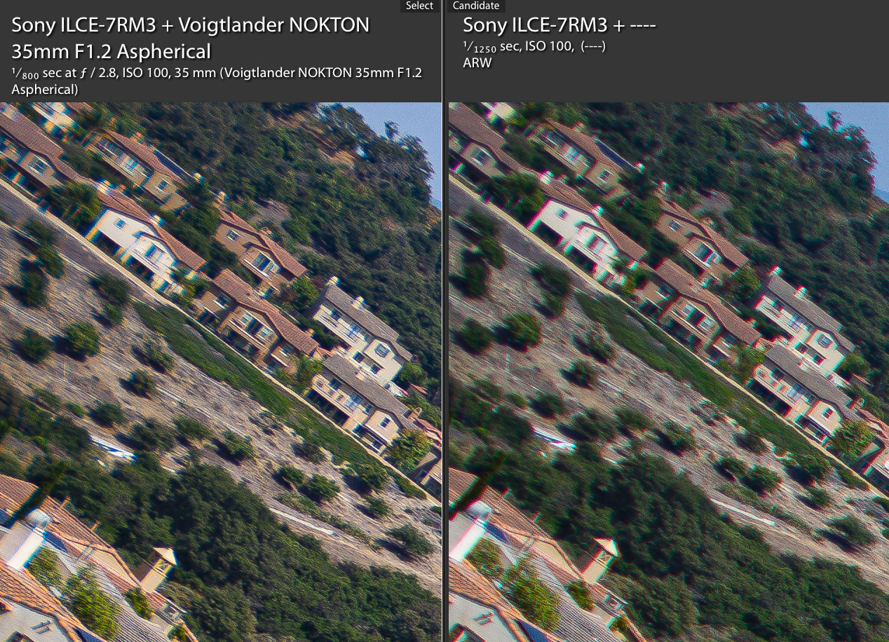

Chris_88 wrote:
Fred, I know it's early, but I'm curious about your findings re performance differences between the VM and e-mount versions. A major camera store in Tokyo just posted their review the other day, and among other things they mentioned that the e-mount version showed less purple fringing than the VM version. Also, they argued that stopped down performance was on the same level as the APO Lanthar lenses. I would be interested to hear you thoughts on these points, when you've had more time to evaluate the lens.

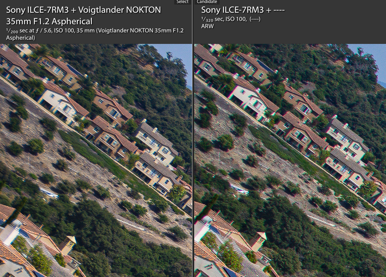

Yes, the E-mount version will show less lateral CA when editing its raw files in Lightroom. However, it's not because it's superior optically.
The reason is that Sony embeds CA correction to the RAW file and that does not happen with the VM lens adapted to Sony or used on a Leica body. Once the VM file is corrected for CA, files from both lenses would look pretty much the same in terms of color error. (There is some correction for purple fringing as well)
Jun 09, 2020 at 11:07 AM
