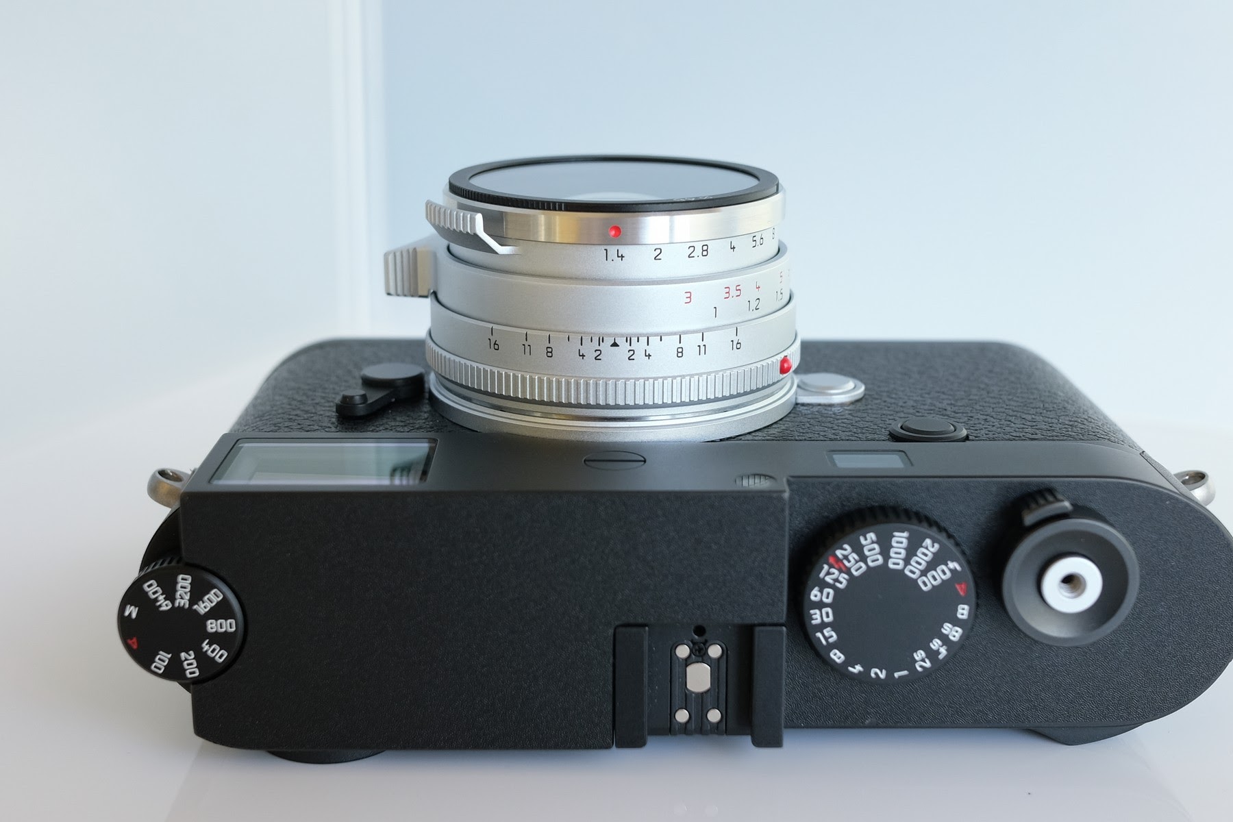

@yukosteel's close-up modification article has been released, which enables the reissued Leica Summilux-M 35mm F1.4 Steel Rim to have a closer focusing distance of around 0.76m.
The Leica Summilux-M 35mm F1.4 Steel Rim reissue (11301) lens has a minimal focus distance (MFD) of 3ft or ~0.9m. This article discusses an experimental modification of the lens focusing mechanics to increase the closer focusing range to approximately 0.76m.
The modification requires precise and accurate grinding of five separate parts, including the MFD focus stopping bar of the outer RF helicoid ring and the elevated area of the inner RF helicoid ring. The modification can be completed by anyone who only needs the lens to focus closer while using Live View or adapting it to another mirrorless system camera.
However, if the lens is to be used with a Leica M rangefinder patch at closer focus, the lens RF couple cylinder must also be modified.
Read the Leica Summilux-M 35mm F1.4 Steel Rim reissue close-up mod article and initial tear-down.
New 0.76m MFD after modification

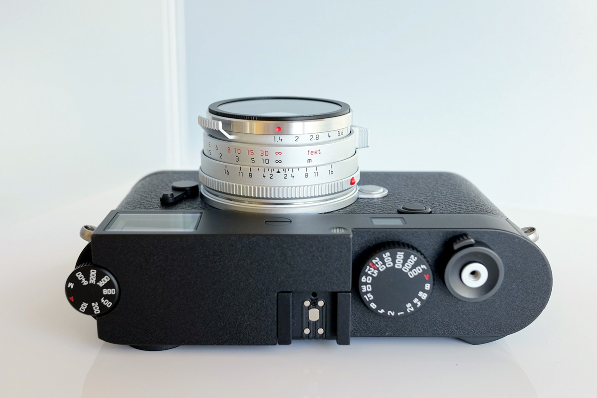

I just received my Leica Summilux-M 35mm F1.4 Steel Rim back from the close-focus modification.
Despite the significant operation it underwent, the lens performs flawlessly and maintains its original appearance. Even the modification done around the mount area is not noticeable. It remains accurately aligned with the rangefinder, and the focusing ring operates smoothly across the full range, including the newly added range of 0.76m to 1m.
Although the Voigtlander 35/1.4 Nokton still boasts a closer minimum focusing distance of 0.7m when compared to the modified Leica Summilux-M 35mm F1.4 Steel Rim, the latter's newly extended close focus ability is a significant upgrade.
