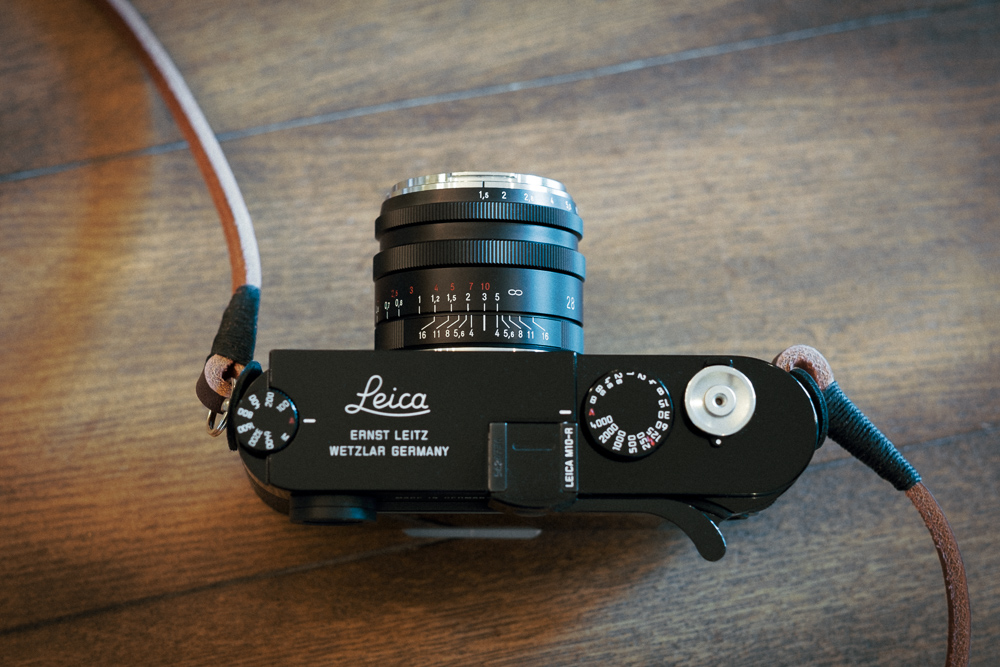

Here is an image displaying the camera after completion. It's free of any tiny scratches.

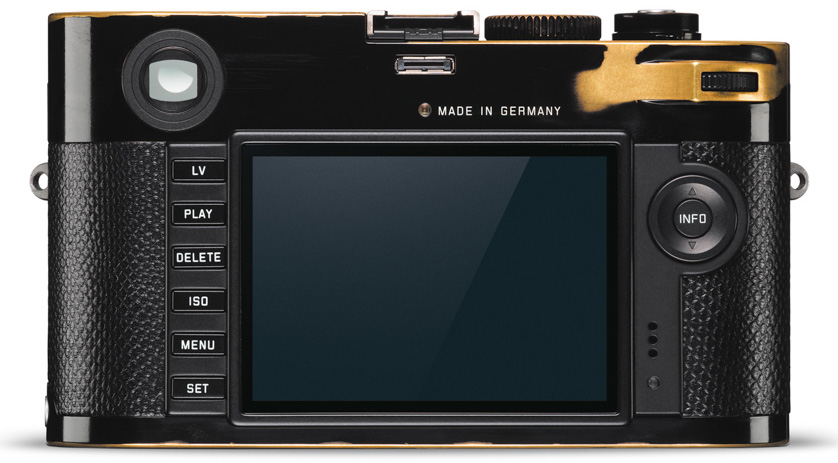

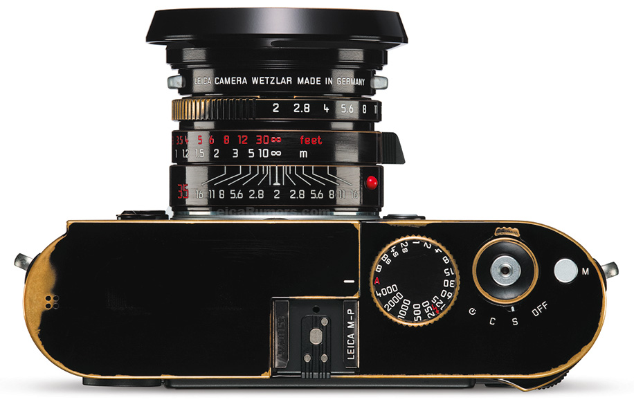

I just discovered that even Leica themselves engaged in this practice, as evidenced by the Leica M-P Special Edition crafted in collaboration with Lenny Kravitz.

I could be mistaken, but my understanding is that Leica produced only 125 cameras with brassing. I wonder if the brassing was consistent across all 125 copies or if it varied in location and appearance, given that it was applied by hand.

At least the brassing is in areas that make sense - I've seen some people hit random areas with sandpaper such as the entire top plate etc. that wouldn't get worn with normal use.
