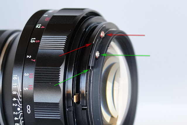

After reading the disassembly article again, I figured out that it's actually possible and not too hard to tweak shims for rangefinder accuracy. It's a tad trickier than adjusting the simple mount shims, but it's still doable to access and tweak the RF shims if your lens isn't calibrated well.

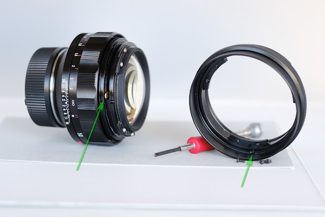

Good news! The rear optics of Nokton 50mm F1 can be dismounted for aperture area cleaning without risk of optical decentering. Well, if I knew that earlier it would save me hours of time on front area re-calibration, but at least it's discovered now. I've updated article with more details and pictures.

That's for aperture cleaning! Also, having the ability to adjust the RF shims is invaluable for this lens. All of my copies weren't properly adjusted, but it should be a relatively straightforward fix adding shim(s) if it backfocus and removing if it frontfocus.
