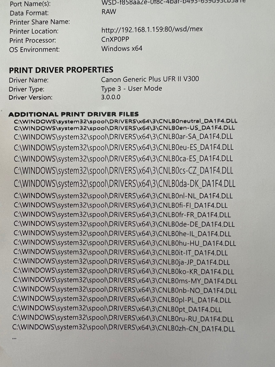

Here is an image of the distorted text I am getting. It happens whether I am printing or using the copier function:

Could this be a problem with the paper not being transported at a uniform speed? When it slows down, the text is compressed and when it speeds back up (going too fast for a moment) the text gets stretched? That would account for why it happens whether I am printing or copying--because both use the paper transport mechanism. If so, that may be the end of the printer, unless there is something to clean.
But does make sense that this would happen line by line? Maybe, if there is some form of cog-wheel effect.

It definitely looks like a mechanical problem, possibly triggered by something else like the change you mentioned.

Looks like a paper transport problem. You may want to look in the maintenance section of the users manual to see how to clean the drive rollers. If it's not just crap on the drive rollers I suspect it will require Canon repair or maintenance.

I think you used to be able to buy "sticky" paper and feed it through to clean rollers. It certainly looks like a paper feed issue.

I did clean whatever there was to clean on this printer including running paper through a special cleaning cycle, but that made no difference.
However, it occurred to me to wonder if a defective toner cartridge could have anything to do with the issue, and when I pulled the toner cartridge, I saw that there was a roller and cog wheel on the cartridge!
When I changed the cartridge, the problem disappeared! Yay! That's what I get for buying non-Canon cartridges.
