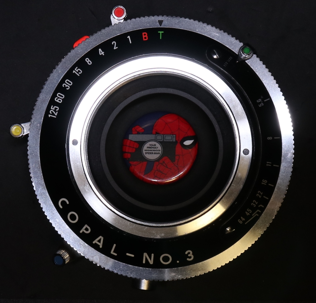

That's "T-mode"; one shutter button push to open shutter, another to close it. I prefer using T-mode over B-mode, when it's available.
