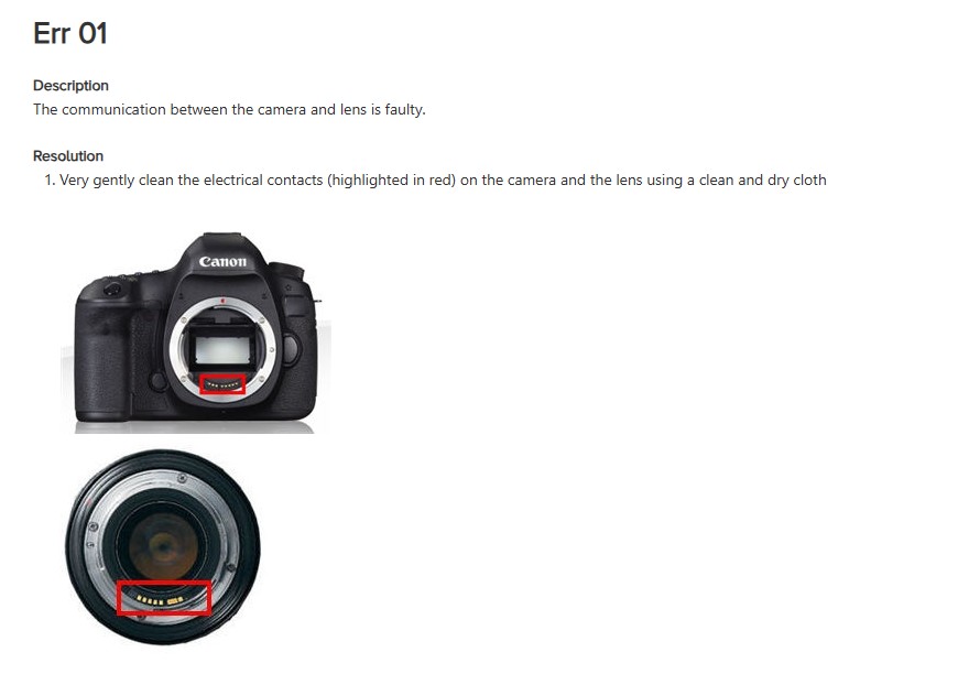

Does anyone have experience with this code? And what’s the cost to repair?

If you're using it on a DSLR, it's a communication error. Clean the contacts.

I think that's one of the errors I got, cleaning contacts a good place to start. I splurged at the grocery store, getting a package of erasers you can put on the end of your pencil, for <$1 They used to say to use pencil erasers to clean contacts
The lens has been used tons, had developed play, and i had to rotate the lens when on the camera, apparently to get the contacts lined up, to get it to function. Although I don't think I'm having nearly as much trouble on a different body , so the body may matter.

Pencil erasers can be quite abrasive. Depending on the contact materials, the plating may be quite thin and damaged. I'd start with a soft cloth and contact solution.
Are we sure that is not an internal ribbon cable issue?

They used to say to use pencil erasers, I used them to clean off contacts recently. If someone is concerned don't do it, I suppose, but I doubt a clean dry cloth as is apparently recommended these days really gets it done, if dirty
I'm getting to the ribbon cable, probably ought to clean contacts and check for play 1st, though.
