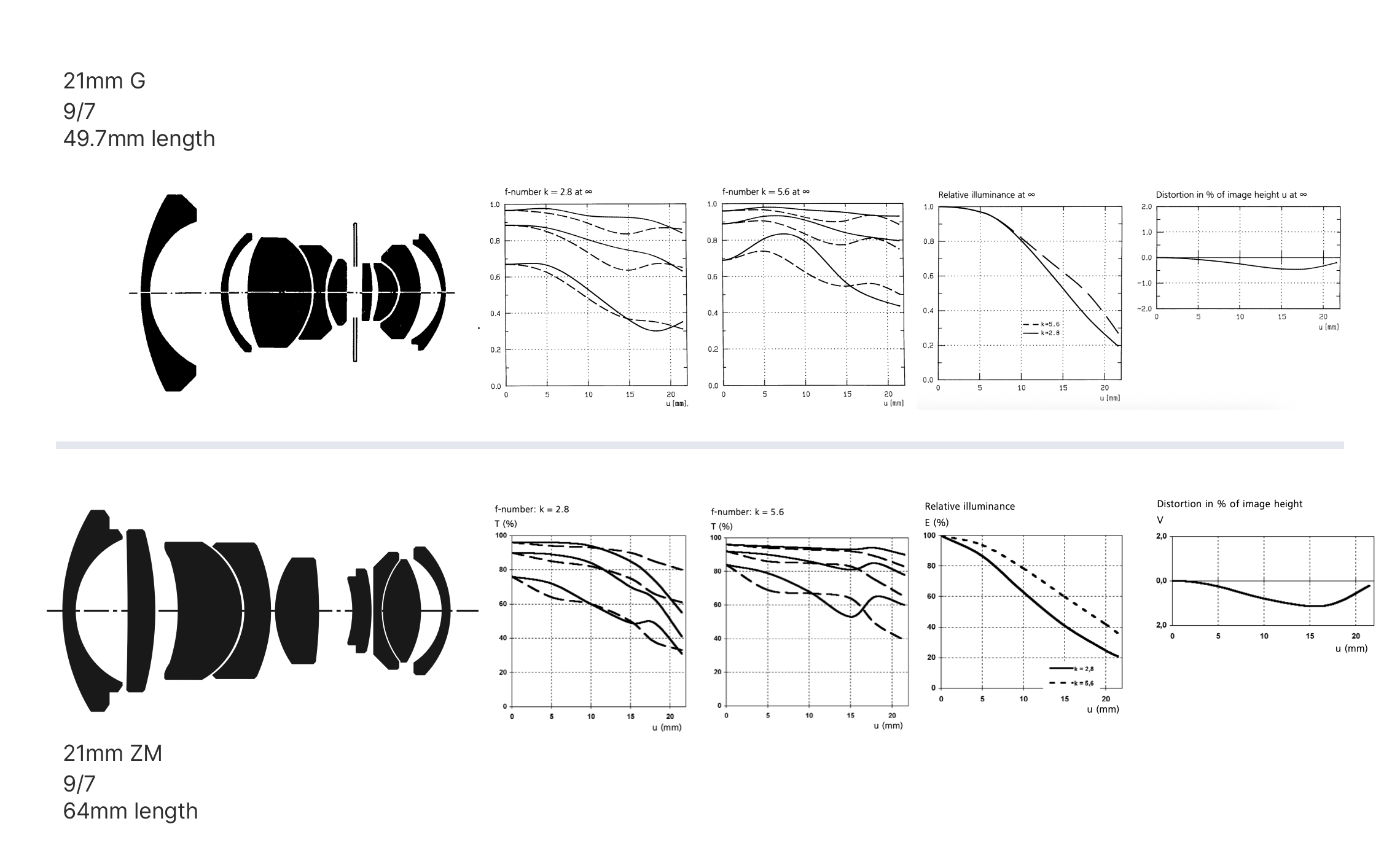

Casting a vote for the Contax g 21mm adapted to Leica m. A little cheaper than the ZM and also smaller with a really lovely signature.

The Contax G21 and G28 are stellar. Where do you buy the adapter? I remember Japan Camera Hunter had this service some years back.

Did you all say G21?? Unless you are going need faster than 2.8, I can’t recommend the G21 enough

This image provides some sense of the blurry edges on the 21mm Biogon-c f/4.5. Never noticed the edge problem on my M11M, but does vignette a good bit at 4.5. It isn’t a good choice for pre-M11 cameras. You don’t want such a slow/small lens, but I’m in the don’t want large heavy lens at this focal length. The Super-Elmar is faster, larger, prettier, but less micro-contrast. The G21 is amazingly small and much like the ZM, but I’ve only used it on a G2 body. Lovely images on the previous post.
