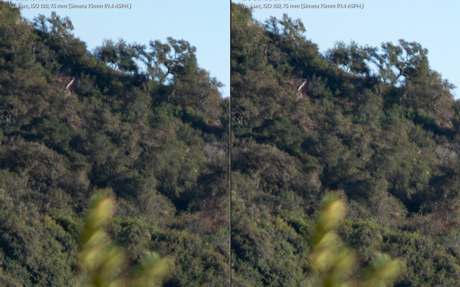

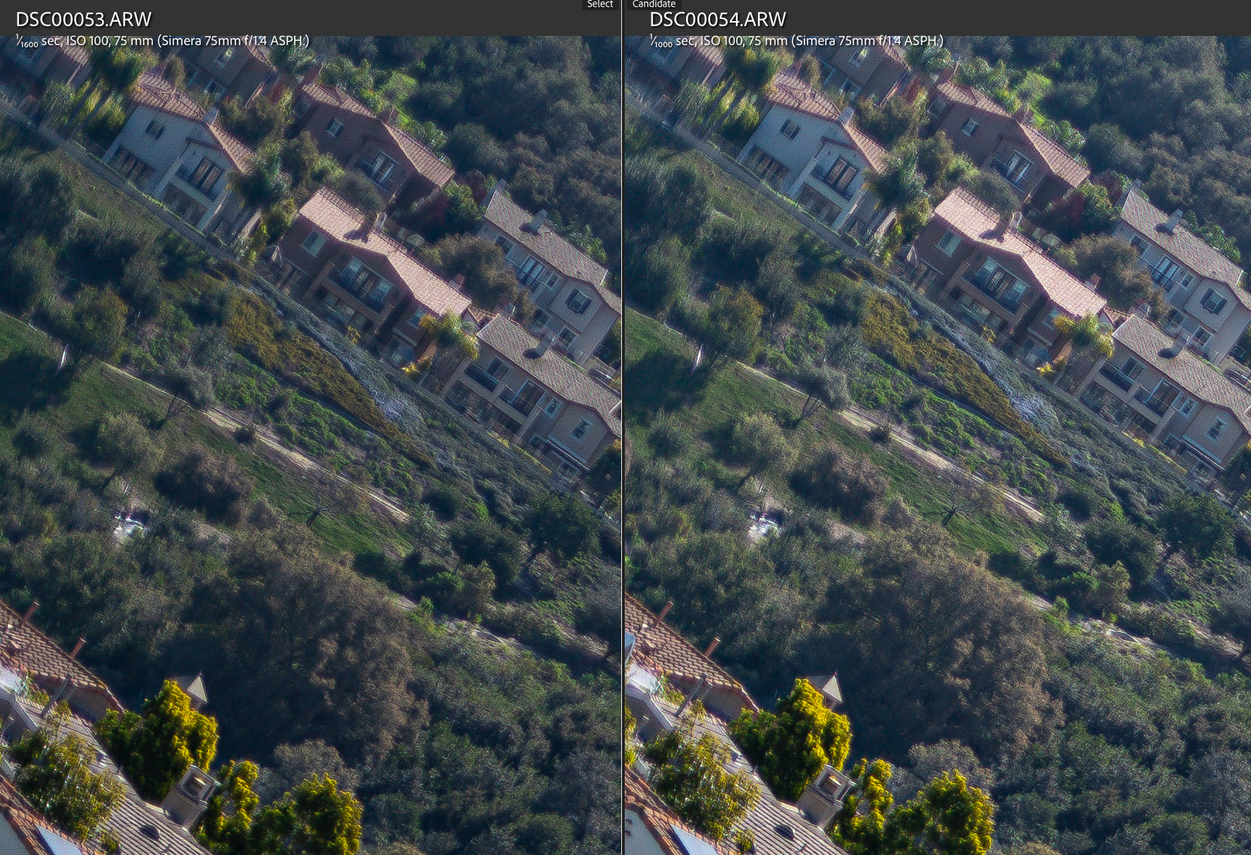

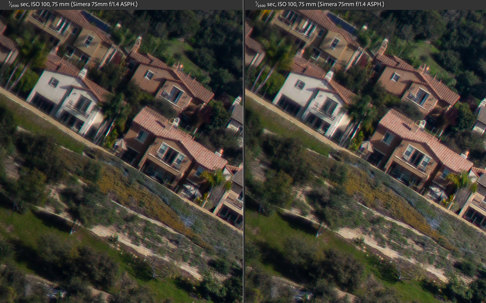

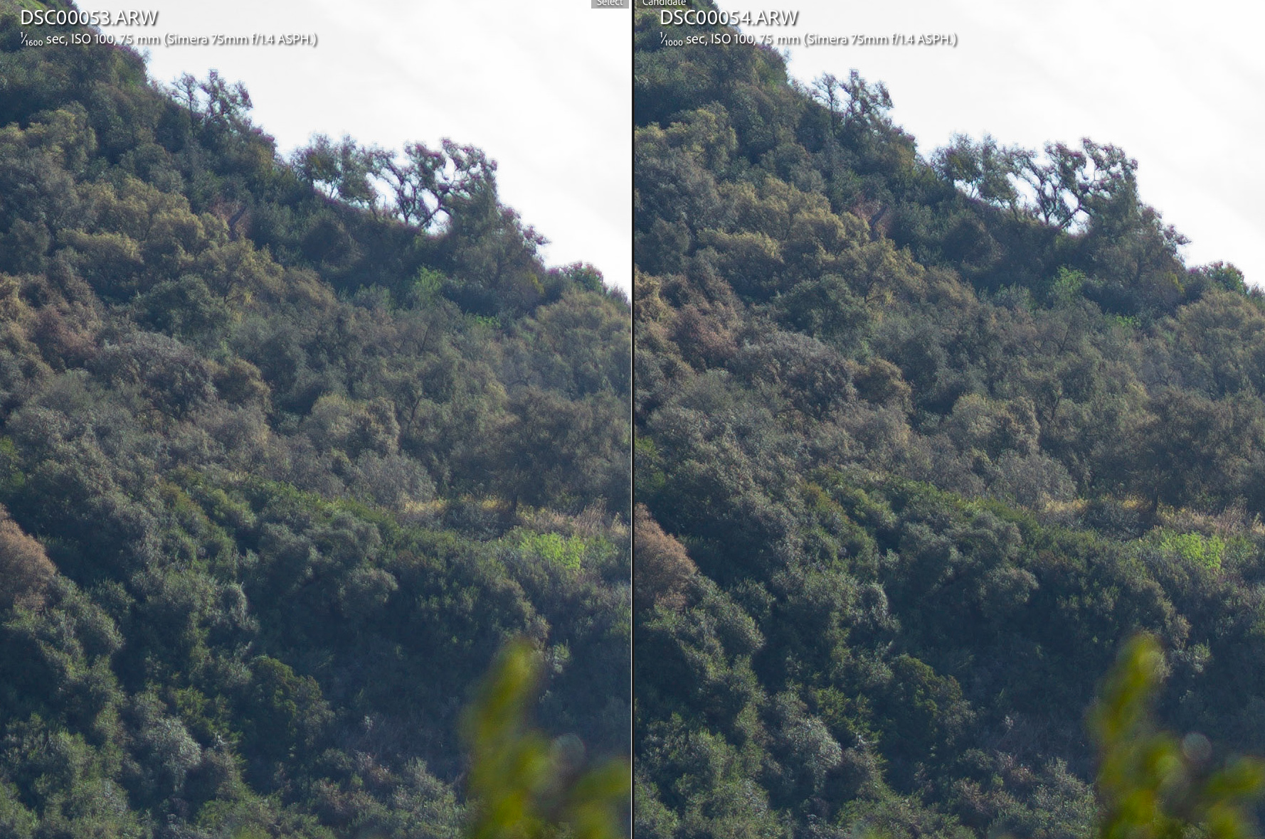

I noticed this too Steve. From time to time, I have noted discrepancies in their testing results.
From looking at Fred's and Bastian's crops, I noticed that Fred has tested the two lenses in significantly different lights--looks at the axial CA WO on the a7r2 versus the m11 when both are WO. There's noticeably more on the a7r2 and the light is harsher as the sky is blown out mostly, which very well could be revealing more definition on the a7r2 crops in the foliage, making it look better artificially. When at all possible, I always take my crops from the same light at the same time--I don't even take the camera off the tripod, just swap the lens.
I also think Fred has a slight misfocus on his Simera testing, or there was a little FC going on. On his a7rii corner crops WO, the absolute corners (the buildings) are not in focus but the trees just before them are. On his m11, the buildings are in focus, while the trees just before them are not.
I think that might be some of the discrepancy we are seeing. So in this case, I lean on Bastian's results. There is also a large differential as Bastian in on a 24mp Leica and Fred is using a 61mp m11. The stock A7r2 is the constant. The files below are from Fred's review and I used from my thoughts above. I did not bother to go through all the stops and distances.
