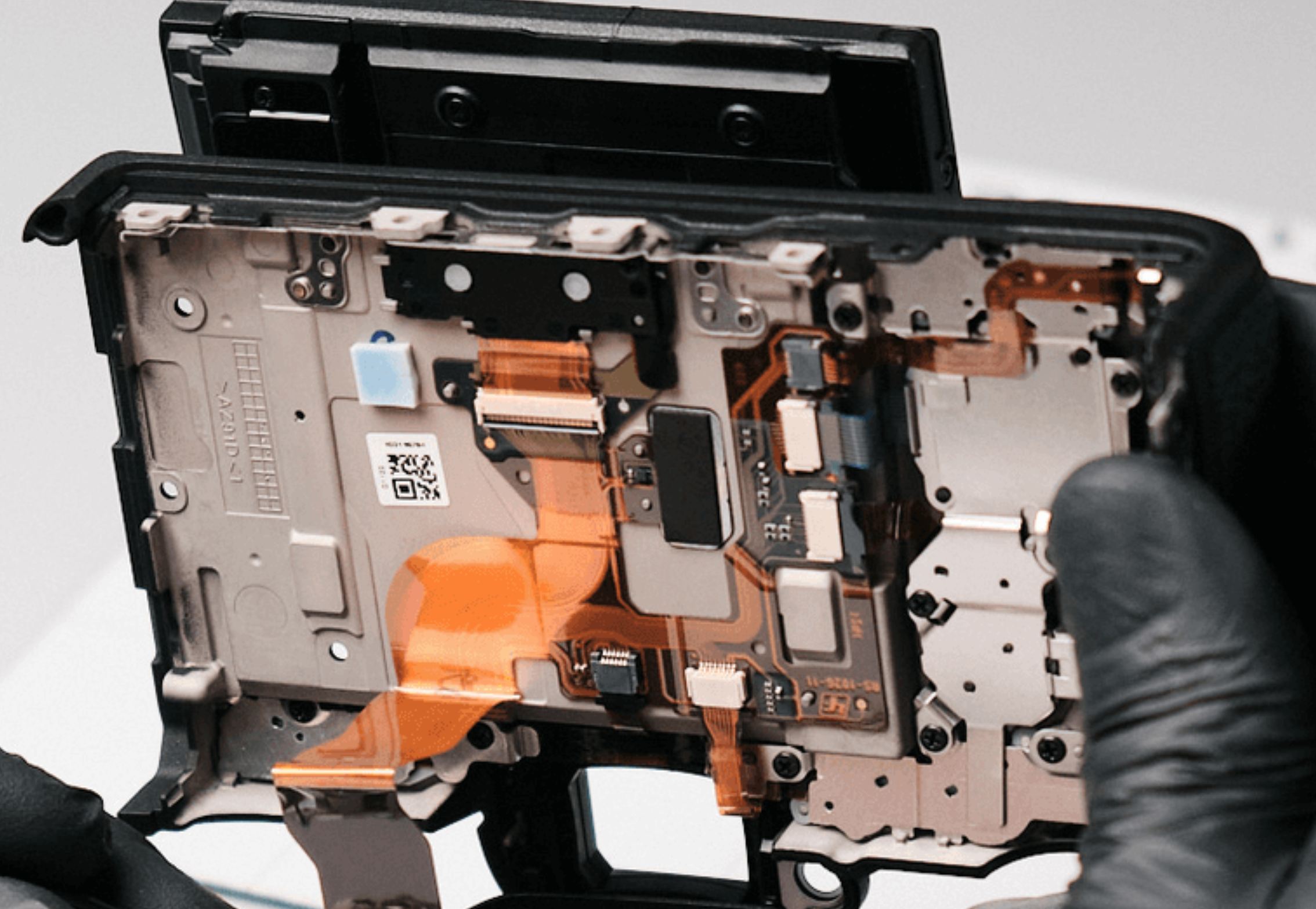

Yeah, probably have camera rear panel down and repeat small amounts electronic contact cleaner like QD or above and cycle the button plus some canned air to loosen any debris, make sure to wait for each spray amount to evaporate off first. If that doesn't work it's probably the button plunger spring or dome failure but unlikely less than a year.
Couldn't find a schematic but Kolari breakdown shows the rear assembly: https://kolarivision.com/sony-a7r-v-teardown/
Best way would probably be to disconnect rear assembly first so any excess dries off and you can limit migration of overspray. Or better yet to access the button assembly (it doesn't look too hard to reach, but not sure about hidden connectors without a guide).
