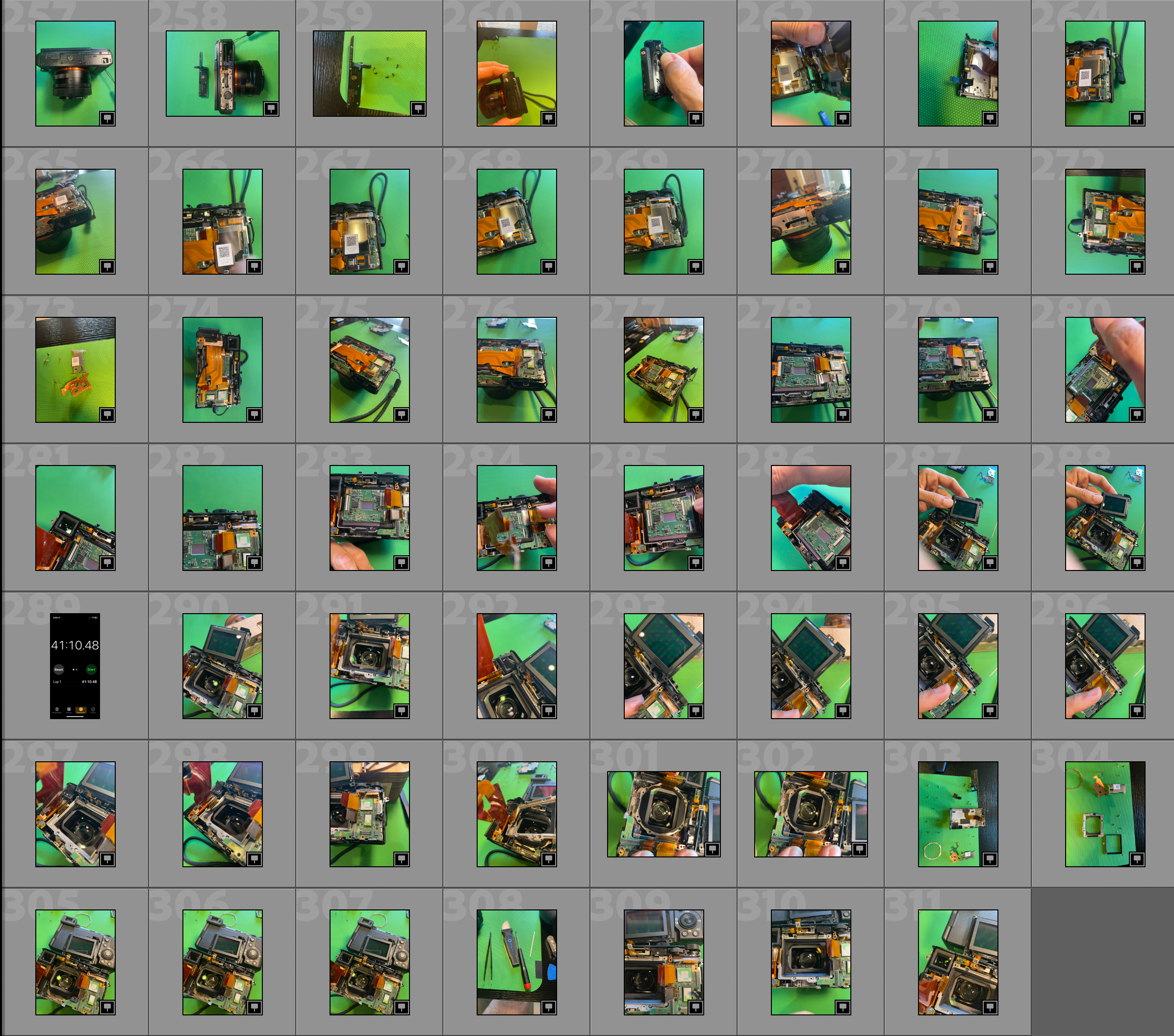

I finally worked up the courage to do a full disassembly of my Sony RX1R II. The whole process took me about 40 minutes to get inside far enough to reach the sensor for cleaning, along with the lens.
A couple of important lessons stood out:

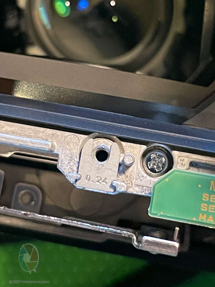

1) Ribbon cables. Some are extremely small and fragile, including the flip-lock (ZIF) flaps that hold them in place. Taking it slow is the key. I didn't have any issues, but you really need patience here. There is only one slide-lock type connector, and that one is for the small ribbon linking the back LCD to the other side of the camera. It works differently since there is no flap which means, the cable just goes straight in/out.
2) Calibration shims. These must go back exactly where they came from. Mine measured 0.24 (bottom), 0.52 (top right) and 0.46 (top left) in thickness, and I was careful to return them to their original spots.
When I reached the sensor, I found 4 dust specks: one large, three small. Unfortunately, I also noticed a large speck behind the cover glass. The RX1R II's design does not allow you to reach the rear element for cleaning. The cover glass sits on the lens itself and is sealed as part of a closed system. I couldn't find any way to remove it as the lens is sealed with the coverglass, so that dust will remain.
Because the glass sits so close to the sensor, I expected the spot to be visible even at very small apertures. (UPDATE: I was wrong -- this dust doesn't appear in images even at f/22.) Even if I had sent the camera to a service shop like KEH, they could only have removed the sensor dust, not the speck inside the lens assembly, which I've learned is a common complaint.
I plan to start a thread with photos and step-by-step notes of the disassembly. I took plenty of pictures along the way. This first attempt took me 41 minutes to take apart and another 45 minutes to reassemble while figuring things out. Now that I know the process, I could probably do the whole job in about 45 minutes total.I think it's safe if you take your time and have patience, but it can feel a bit advanced if you're not comfortable working with small and fragile electronics.

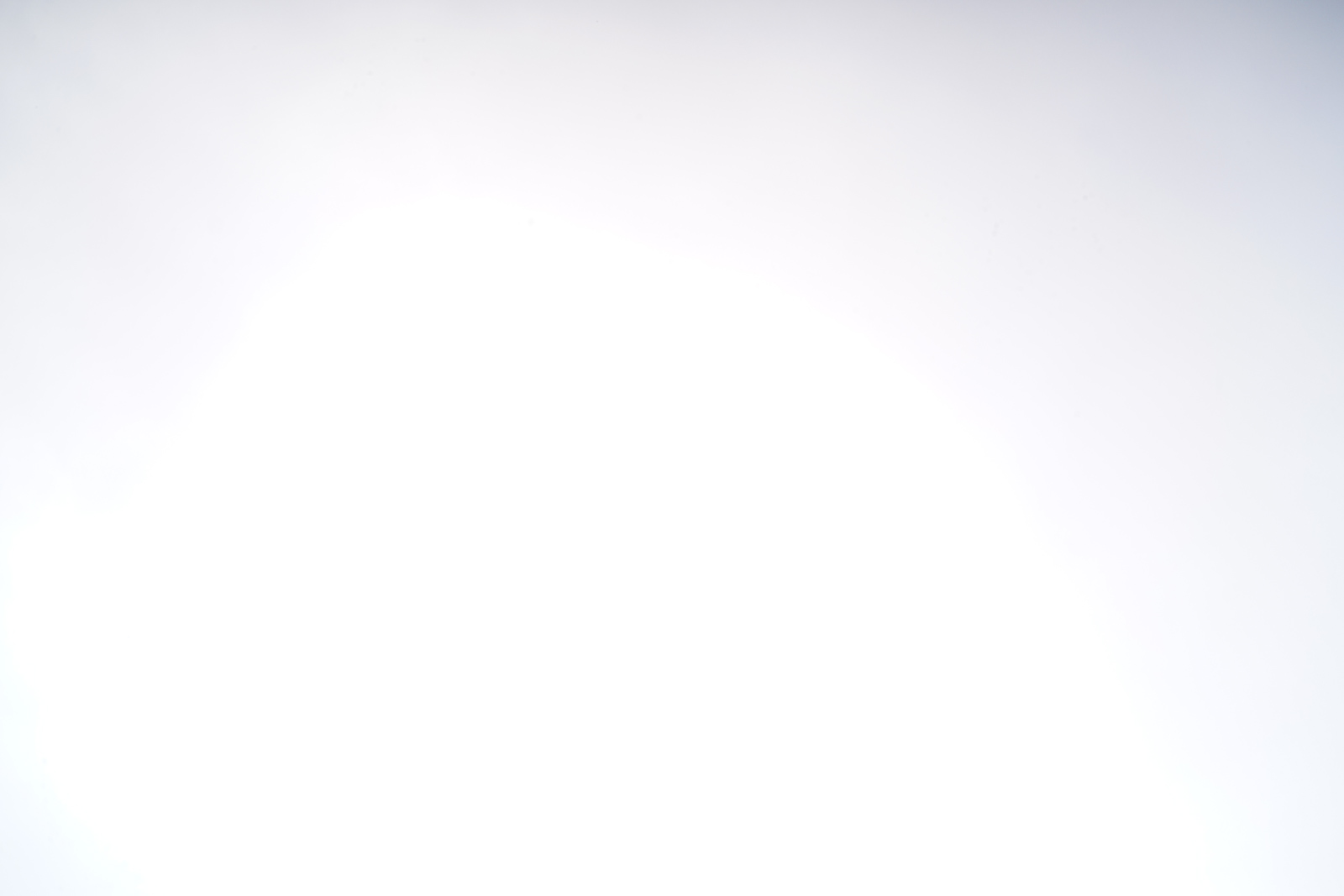

I just shot at f/22 and there isn't a single dust spot on the image. Turns out the only issue was sensor dust...nothing from the lens shows up at all.
Everything else on the camera works perfectly, so I'd say the effort was worth it. I'll be posting a tutorial soon. I could've sent it to KEH but it would cost me $350 + tax + shipping and I'm not sure the tech would be as careful as I was, especially in regards to the calibration shims.
Here's my sensor at f/22. Before, there were four or 5 noticeable dust spots, and now I don't see any.

Preparing the images for the disassembly and sensor cleaning article:
Sep 14, 2025 at 12:09 PM

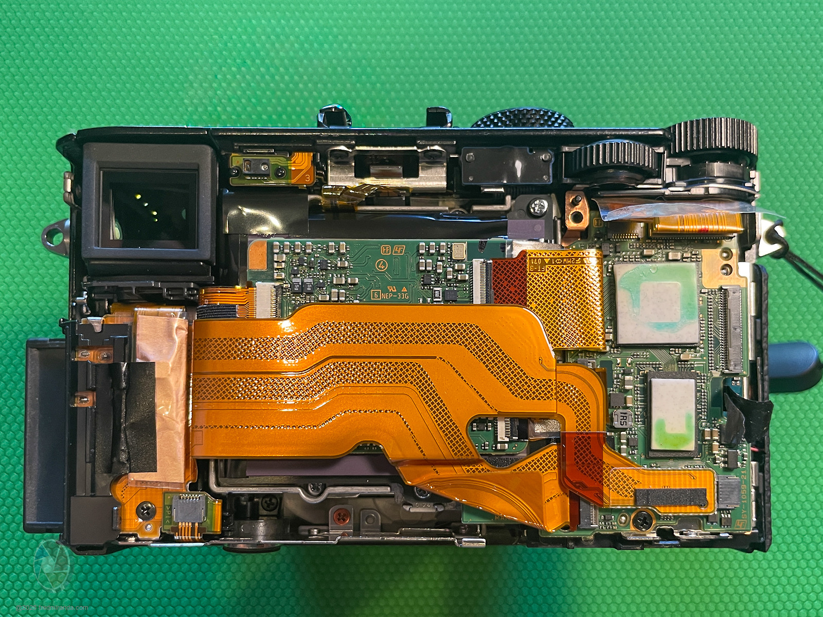

I am also trying to locate a replacement for the internal battery in the RX1R and RX1R II. According to the service manual, the battery is a rechargeable lithium called "BT2950" soldered onto the FC1004 board. After 10 to 15 years, it no longer holds a charge for the date and time, so it needs to be replaced. However, I have not been able to find a replacement anywhere. If anyone has any info, let me know. It's likely the same battery for the RX1 and RX1R but I'm not sure.
BTW, here is one image showing the RX1R II without the back cover and left heatsink/brackets.

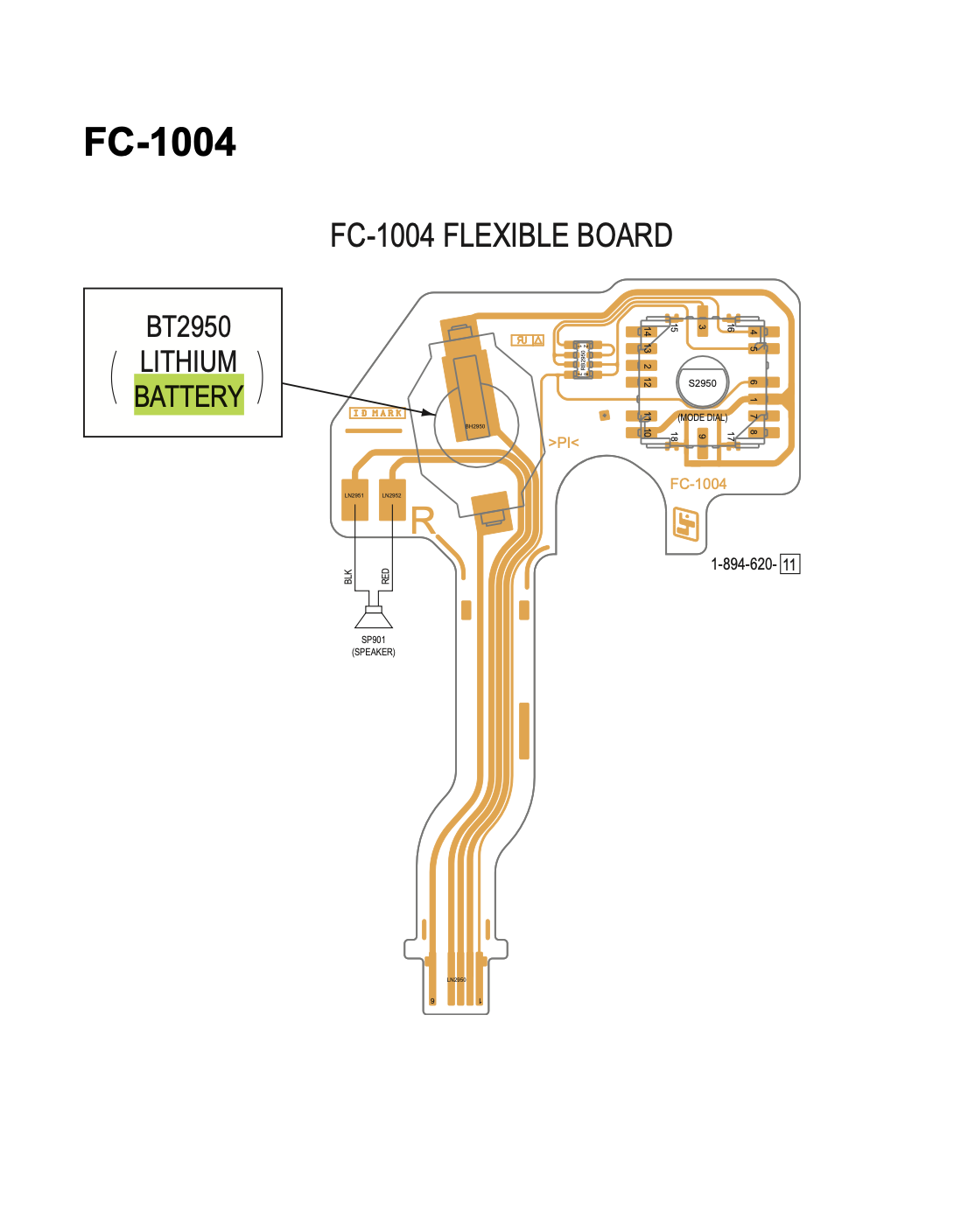

I just found out that the battery is actually rechargeable coin shaped and goes on the 1004 flexible board (Info on RX1R II Service Manual Level 3). Sony does not provide a replacement but it's available under different brands.
You can use any of the followings:
• Seiko MS614SE: Direct equivalent; widely available from electronics suppliers like Digi-Key, Mouser, or Amazon. Cost: ~$2-5.
• Panasonic ML614 or ML614S: Same specs and fit; reliable for clock backups in cameras. Available on eBay, Amazon, or battery specialty sites. Cost: ~$3-6.
• Sanyo ML614 (now under Panasonic branding): Equivalent and often cheaper in bulk.
So, the internal battery on the RX1R II is different than the one on the RX1 and RX1R cameras.
PS: Shooting with old electronics comes with one requirement...you have to be a tech expert

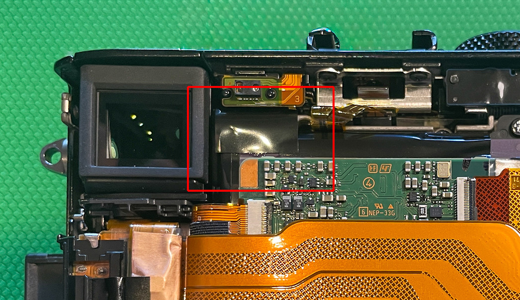

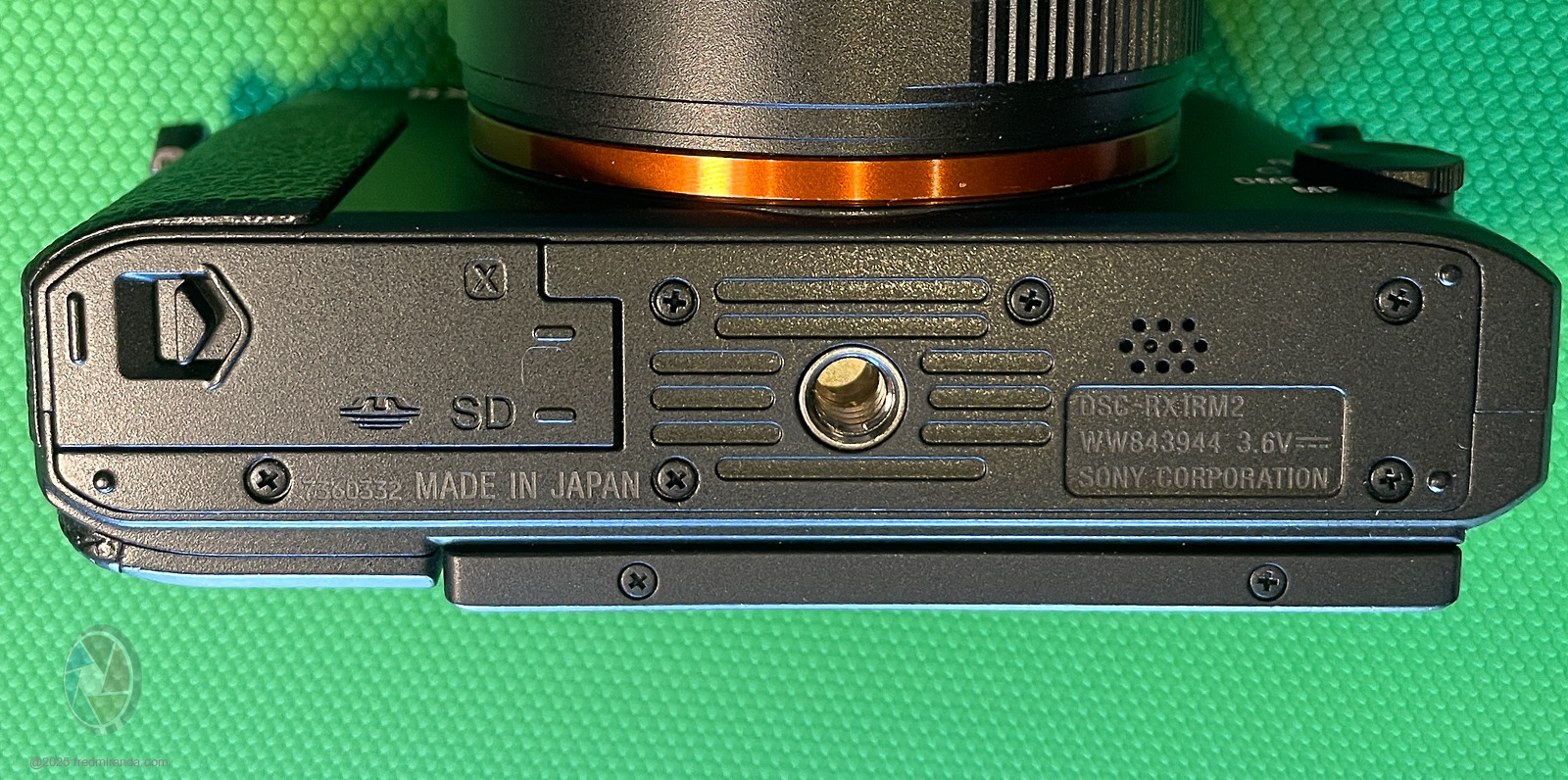

I've been evaluating where dust can easily enter this camera, and I see three main points. The first is the pop-up EVF, which has gaps around it that allow dust inside. That's likely why Sony added the black tape on the top left side of the board that holds the sensor on the opposite side (see image marked in red). The tape doesn't seem to serve much purpose other than shielding that area from dust entry. I added more tape around the edges to give the sensor extra protection.
The second weak point is the speaker at the bottom of the camera, which can be sealed from the inside with tape. The third is the pair of microphone holes on the top plate. Covering them will block stereo audio recording, but you can always use an external shotgun mic on the hot shoe. After cleaning the sensor, I recommend making these modifications to help prevent new dust from getting inside.

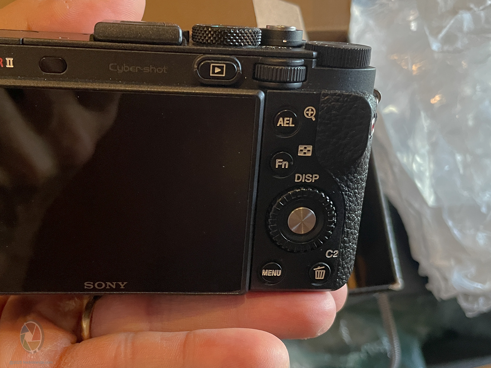

I should have taken close-up shots to show the texture in more detail, because it's very obvious when both cameras are side by side. Here's one from my phone. You can see the surface has a textured, flat finish instead of the earlier glossy look.
This is a newer batch with different finish
...Show more
Thinking about it more, that black tape might actually be the “fix” Sony used for the well-known light leak issue. They recalled the initial RX1R II cameras, and it is possible that the only step they took to stop the leak was adding that tape. It may not have been intended to prevent dust from reaching the sensor at all. In which case, once that black tape is removed during sensor cleaning, it's a good idea to replace it with a new one. (I used this one)
