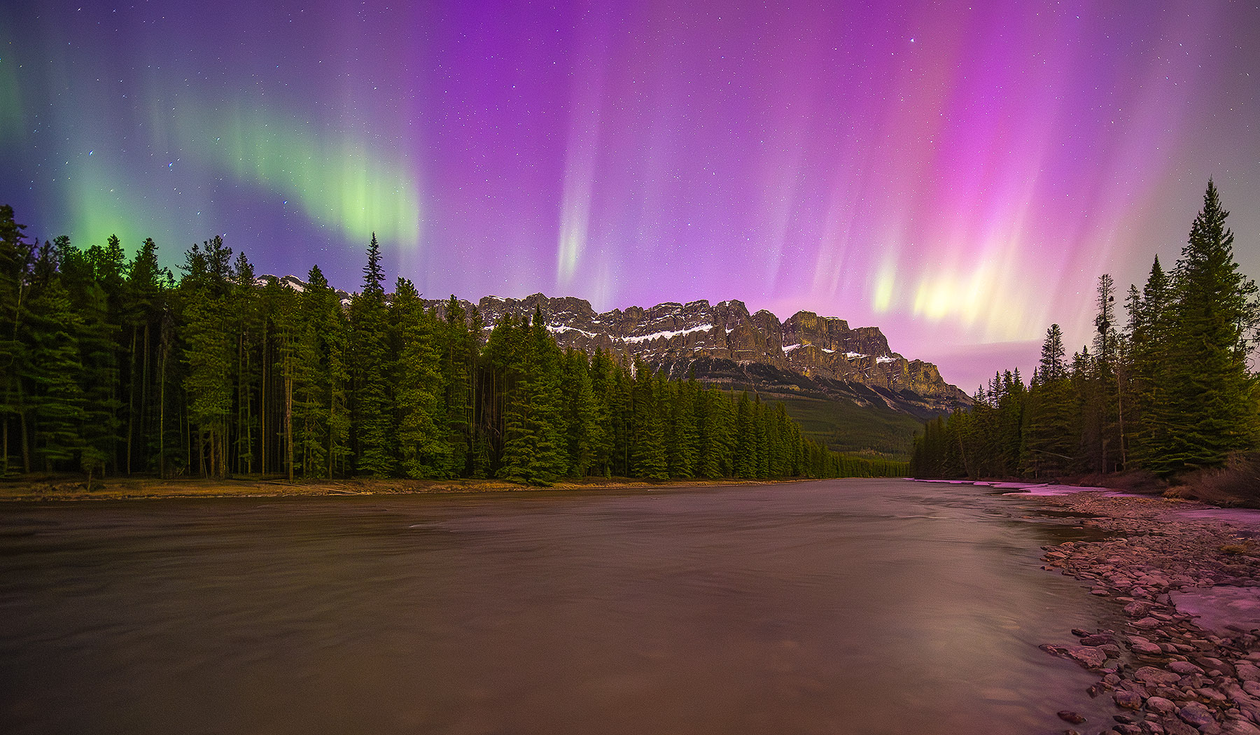

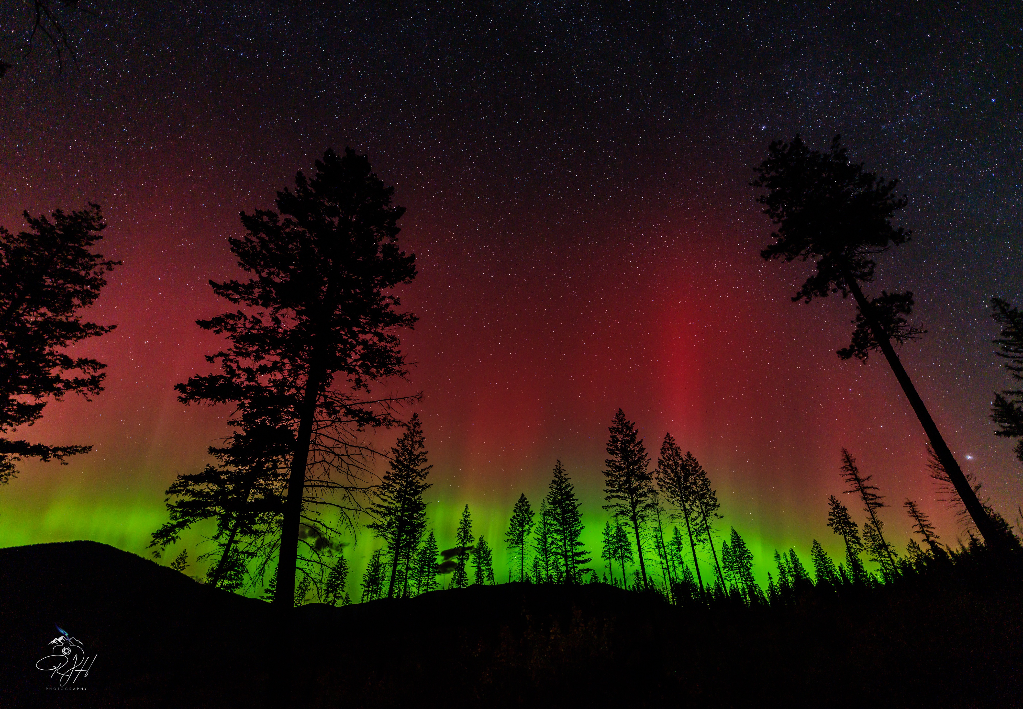

See this link where I used my cheap - laowa 15 macro shift and my 24-70 f2.8.
https://www.fredmiranda.com/forum/topic/1858002/0?keyword=Aurora#16546084
It illustrates that
- f2.8 and f4 are okay, particularly on a really bright/strong night.
- hi iso eg 10,000 yields pretty good
- shift lens result in non distorted trees.
- you don't have to spend huge money to get aurora
This was on a brilliant night in Banff National Park.

this is the 15mm f4.5 shift lens??
Nov 03, 2025 at 04:09 PM
Scott Stoness
p.1 #18 · Help with aurora lens
No its the 15mm f4 macro shift https://www.laowalenses.ca/product/laowa-15mm-wide-angle-macro-lens/
Its a good lens but you can't shift it very far without vignetting unless you like 16x9 format (crop the vignetting off).

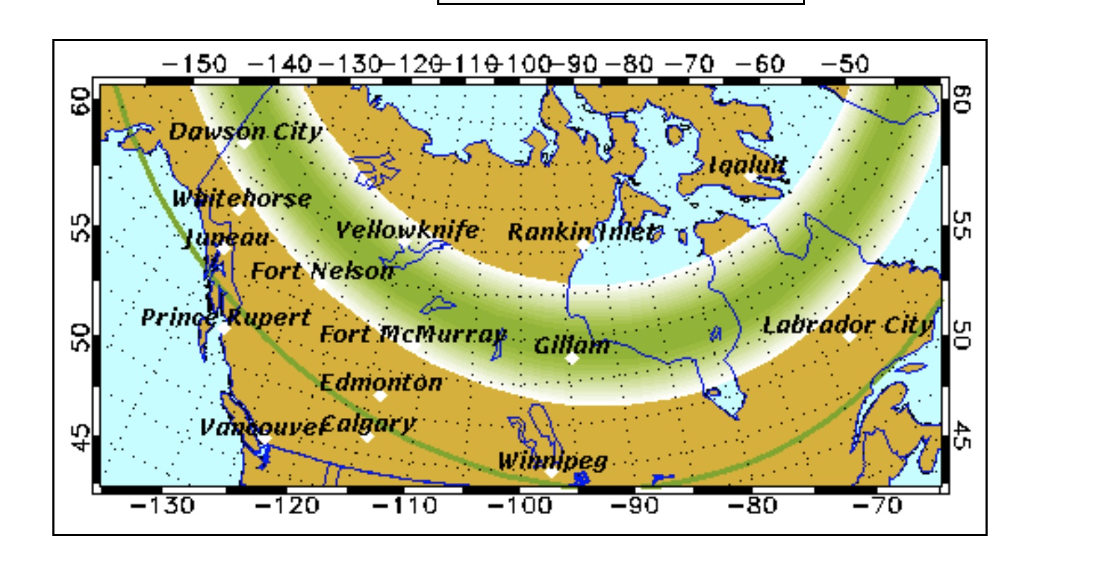

My other tips is that
Whitehorse and Yellowknife [and Churchill] are quite easy to reach (737 out of Calgary) and are very near the centre of the aurora belt.
[Whitehorse is as good as Sveldvard but still requires a good aurora forecast. And Churchill is better than Norway for polar bears in Oct/Nov and Mar (babies emerge)]
[Iceland is pretty cheap for airfare too and easy to find dark night areas]
Go when the moon is not up on the night you go. Moon light is a killer
The university of Alaska Aurora forecast is my go to for predicting good days.
Go when the forecast is for clear skys and moon on opposite side from night time
https://www.gi.alaska.edu/monitors/aurora-forecast
