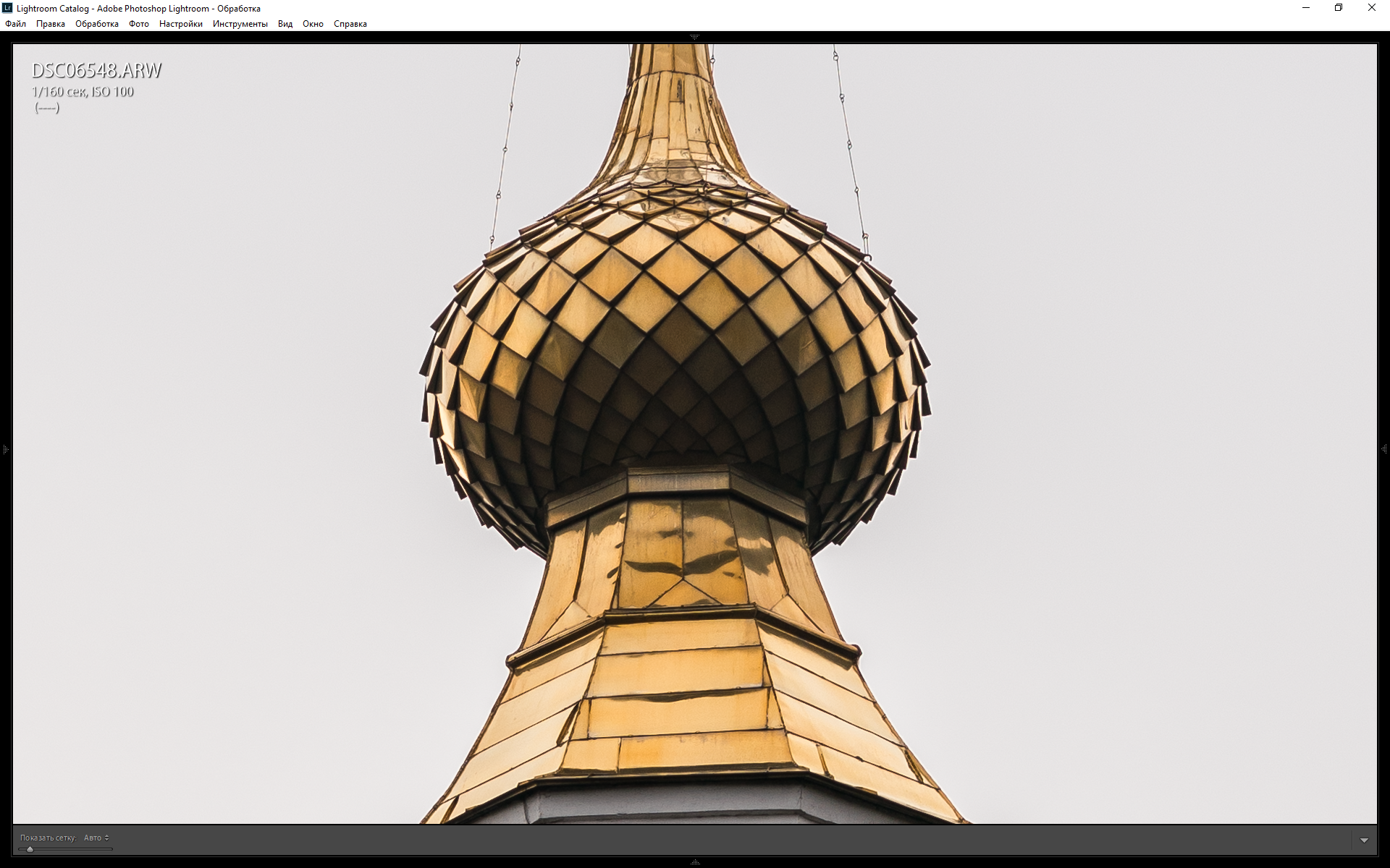

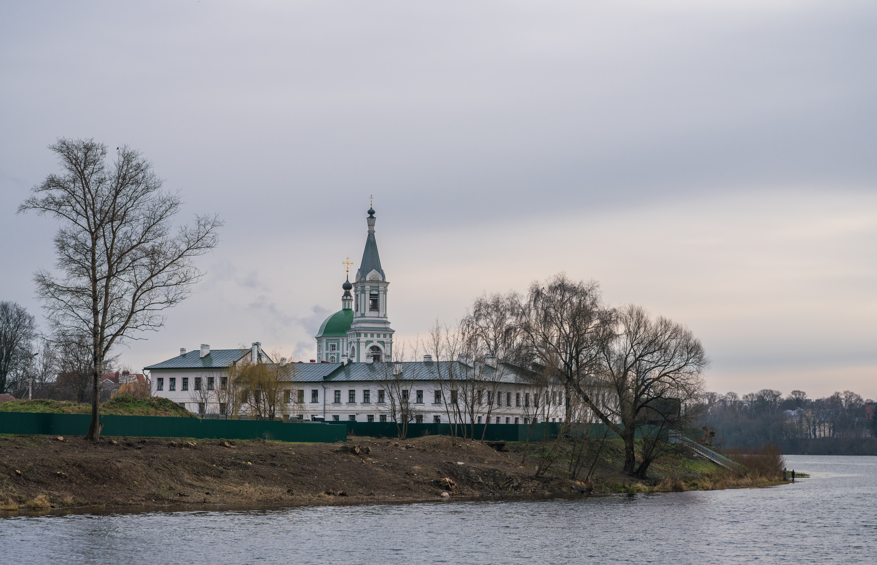

Hello.
I bought the 7Artisans 75mm f1.4 lens to try out the 75mm focal length, which I'd never used before.
My first impressions: it's very soft at f1.4, very soft.
Perhaps it's just my lens.
So, I didn't take any photos wide open, but started at f2.0 and didn't stop down any further than f5.6.
The lens is all metal and very well assembled, with no play whatsoever; everything rotates very smoothly.
The aperture ring has clicks, but only at the specified apertures; there's no clicking action after f/5.6 and f/8.0.
A lens hood isn't included, but it's essential, as it can sometimes cause fogging from a strong light outside the frame.
And of course, there's a huge amount of chromatic aberration; it's very visible on high-contrast objects, even out of focus.
This is especially noticeable in the last frame.
All the photos below have been edited to my liking.
The photos are clickable. Shot on the a7R2.
All photos were taken on the same day, but in different lighting.
Dec 07, 2025 at 09:05 AM

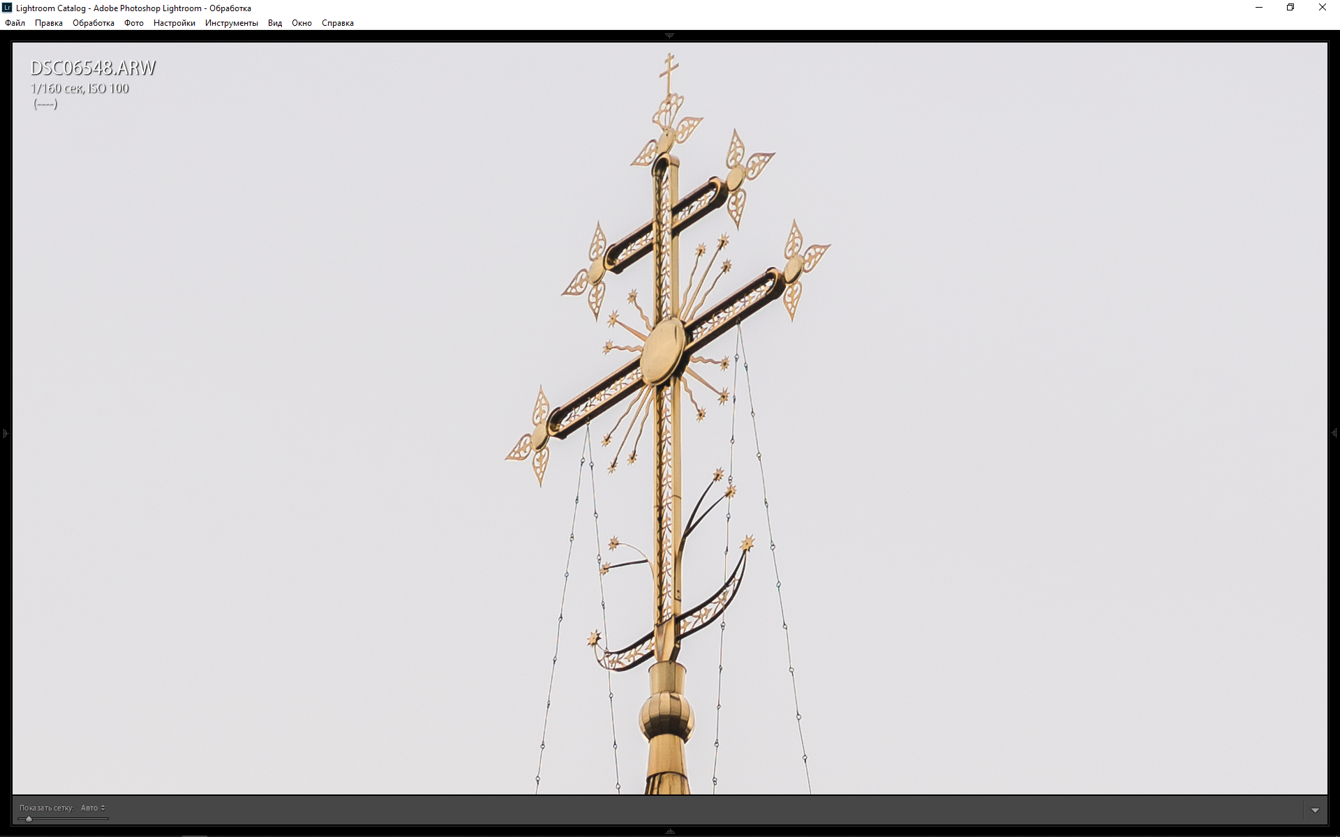

Detail at aperture 5.6 Not bad at all for a $100 lens.
Dec 07, 2025 at 12:39 PM

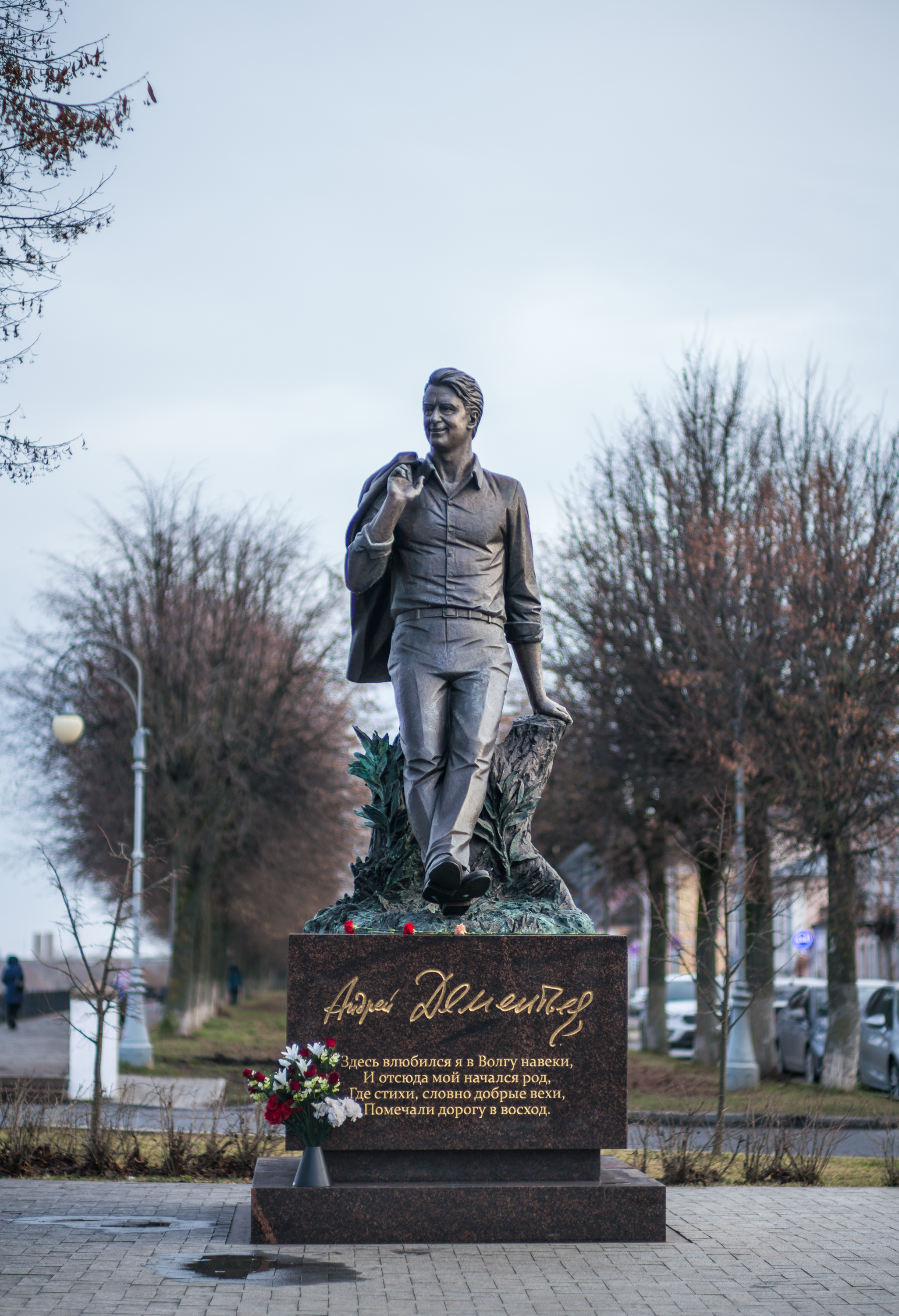

My current travel kit consists of a 21-40-65. I really like the 65, but it's really bad in some situations, and sometimes the autofocus is completely useless. I'm looking to replace it with a 75mm with manual focus. Unfortunately, this 7Artisans isn't at all versatile due to its non-functional wide-open apertures. Certainly not for me. But at 5.6, it shows decent results. So I'll keep it for now. I've already ordered three types of lens hoods for it.
Dec 08, 2025 at 12:30 PM

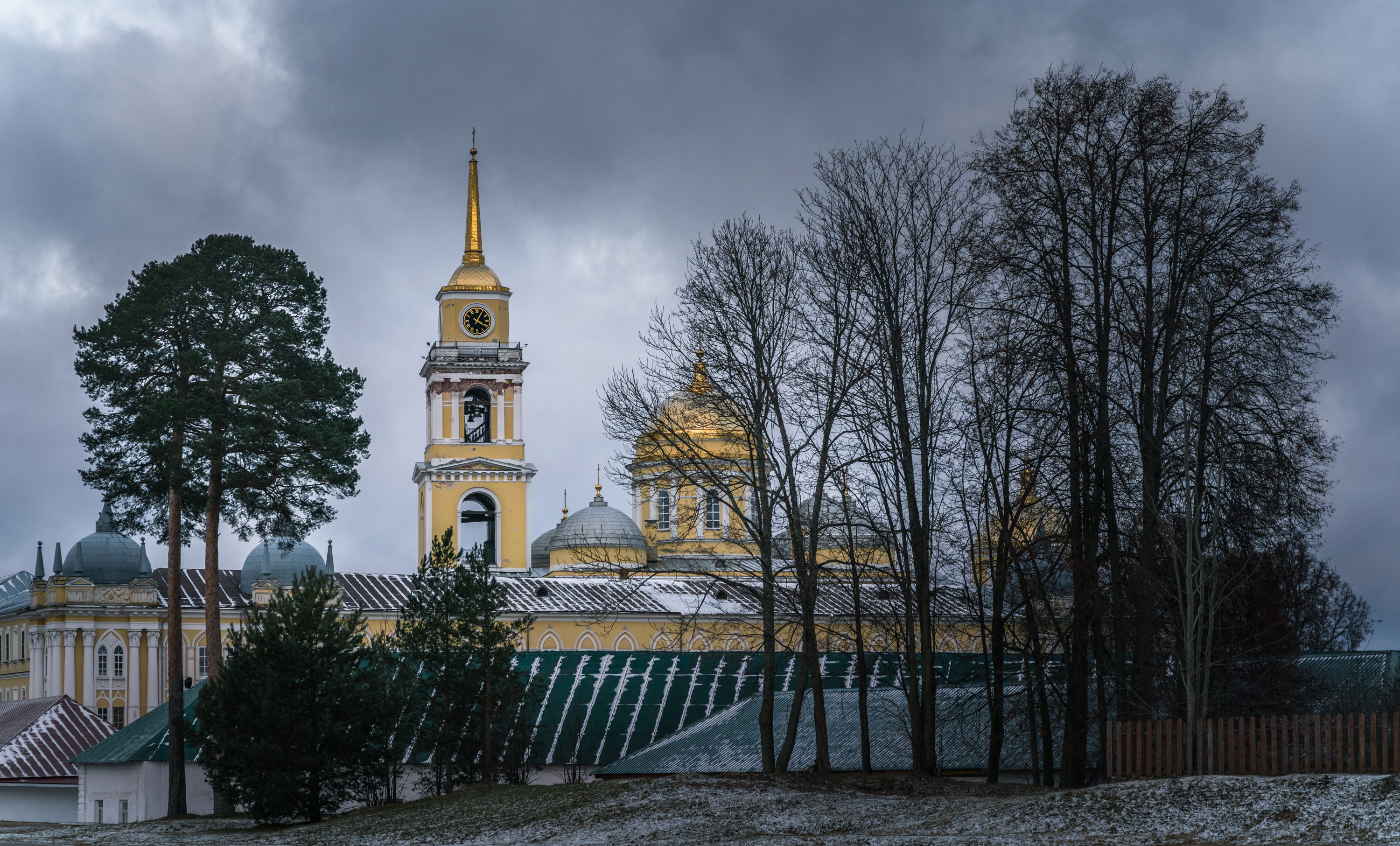

@mudlake, @Happydan, You apparently misunderstood me. An autofocus lens with electronic focus control is great when there's light, lots of it. But what if it's dark and there are no clear, contrasting objects that would allow you to focus accurately?
Here's an example below. On a Northern Lights trip, I stopped for the night on the shore of a lake. Mountains were visible on the other side, their peaks covered in snow. The night was dark and cloudy. I wanted to take a souvenir photo. I used a Sigma 65mm and tried focusing manually. It was very difficult; the eye sees, but the camera is practically blind. Increasing the shutter speed increases noise, which further hinders focusing.
I used a Nokton 40/1.2; its infinity is stopped down hard. That's it, I got the shot. That's why I want a fully manual lens.
@freaklikeme I've already made my choice: the Nokton 75/1.5 Sony E. I just don't have the money for it yet and I need to get used to the 75mm and figure out if I need it or not. I rarely shoot with the 65mm.
Nokton 40/1.2
Dec 09, 2025 at 09:06 AM

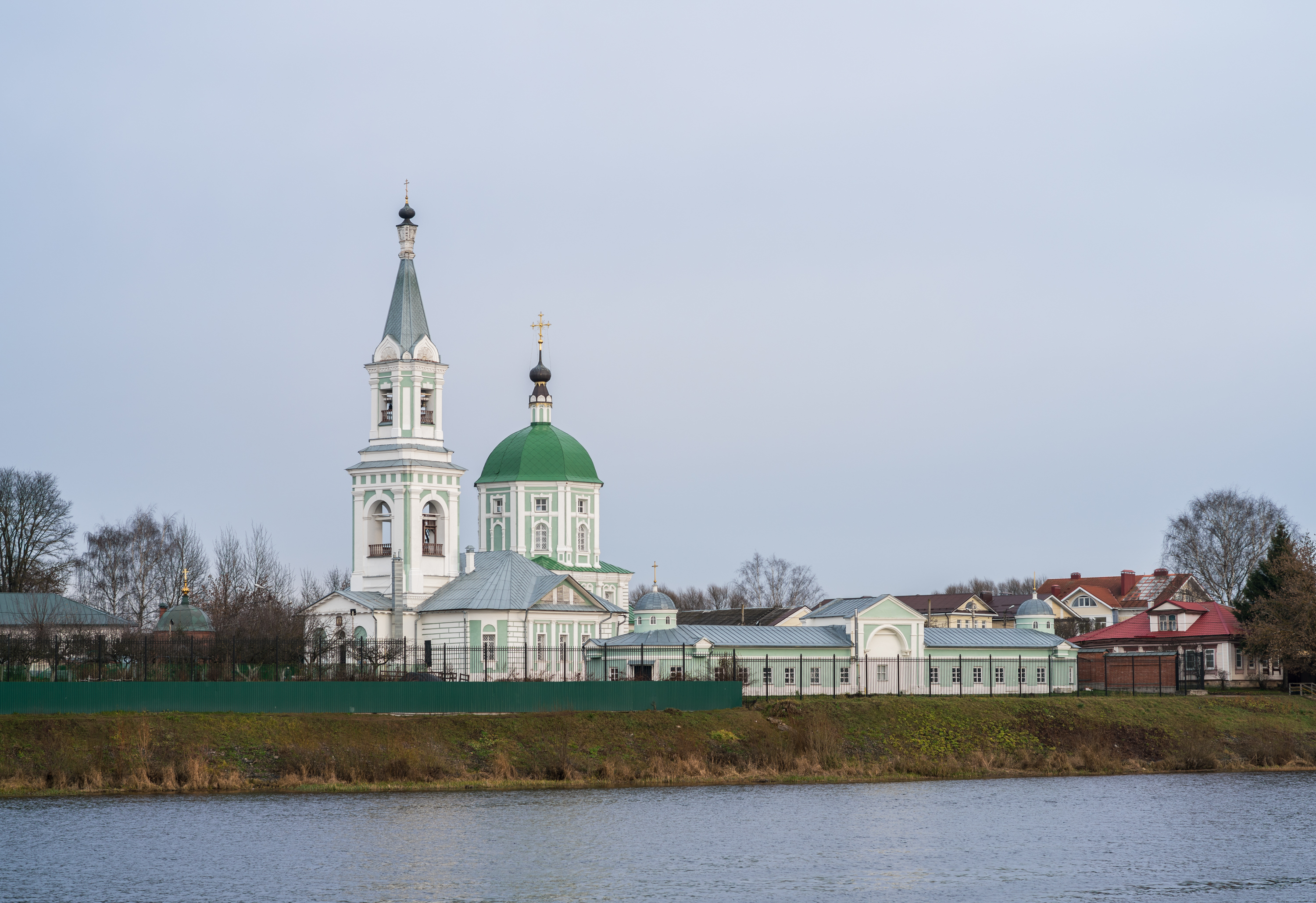

f5.6
Dec 13, 2025 at 02:04 PM
