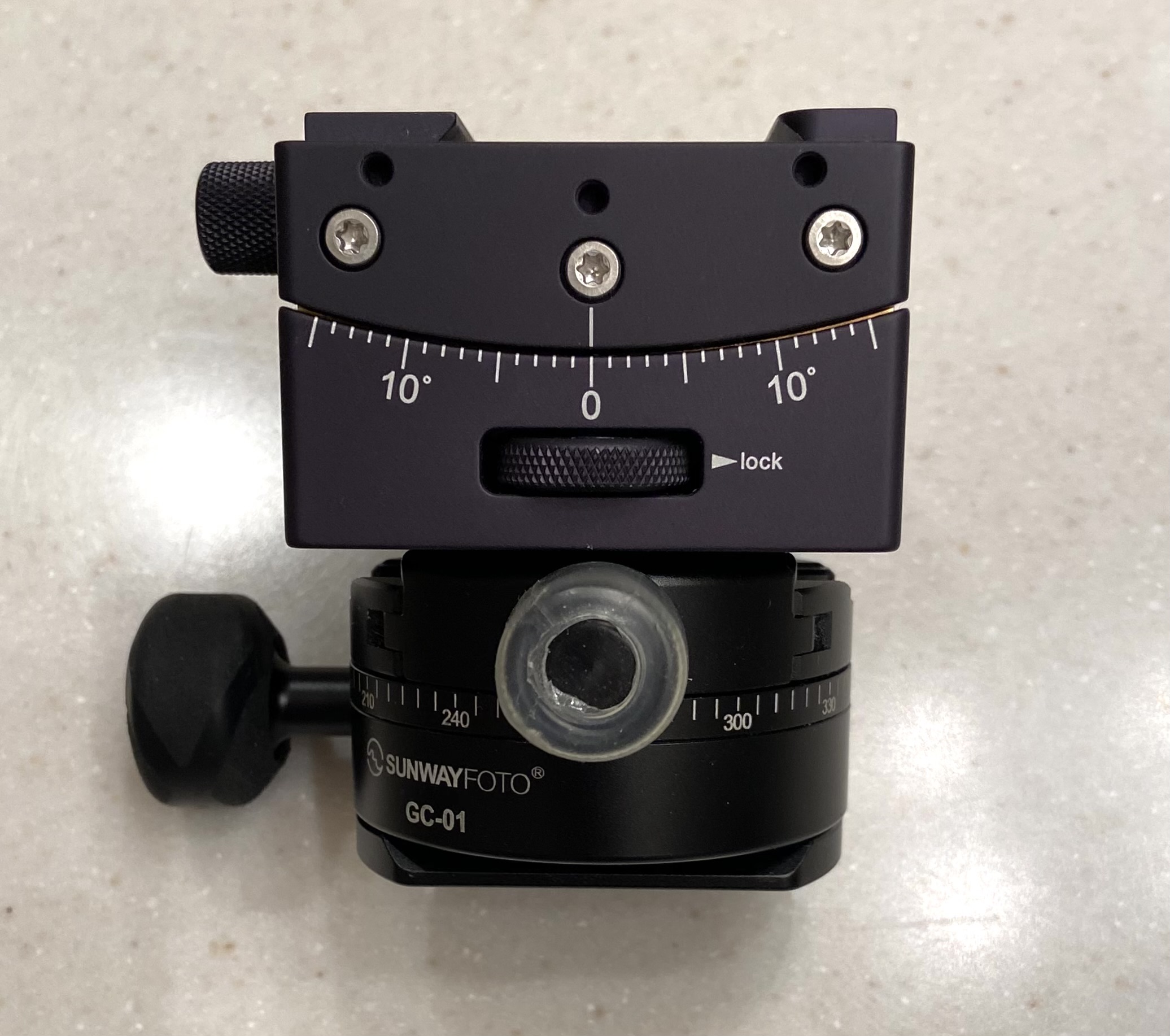

I have a Sunwayfoto GH-Pro II with GC-01 geared pano head on top. it's not for heavy setups though and the GC-01 in particular doesn't lock down very tight. Not a problem if you're level though. We use it for reproduction to perfectly level our camera and it's great with an A7r4 and Sigma 70mm macro on it.
Jan 10, 2026 at 11:06 PM

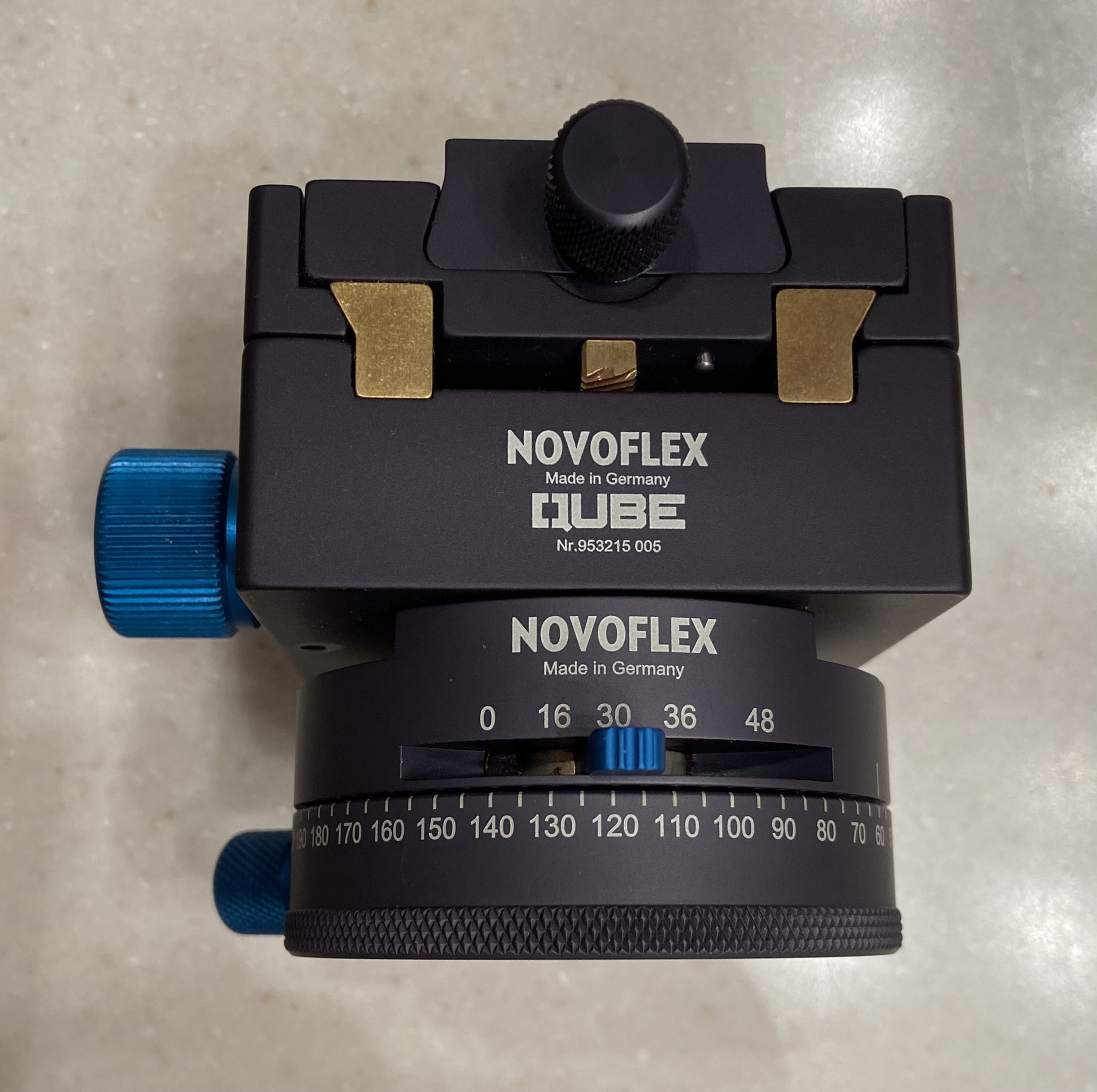

Since you have to level the base anyway, then all you need is just a single tilt stage with a geared pan base. For your described usage, looks like the following simple setup is all you need. It is made of a single stage Novoflex Goniometer, and Sunwayfoto geared pan clamp.
Jan 14, 2026 at 09:20 PM
Cinstance
p.1 #18 · Arca-Swiss D4 geared tripod head observations (and others with geared panning on top)
And here is with the Novoflex click pan. Even with this combo, it’s still much less expensive than a D4:
Jan 14, 2026 at 09:36 PM
