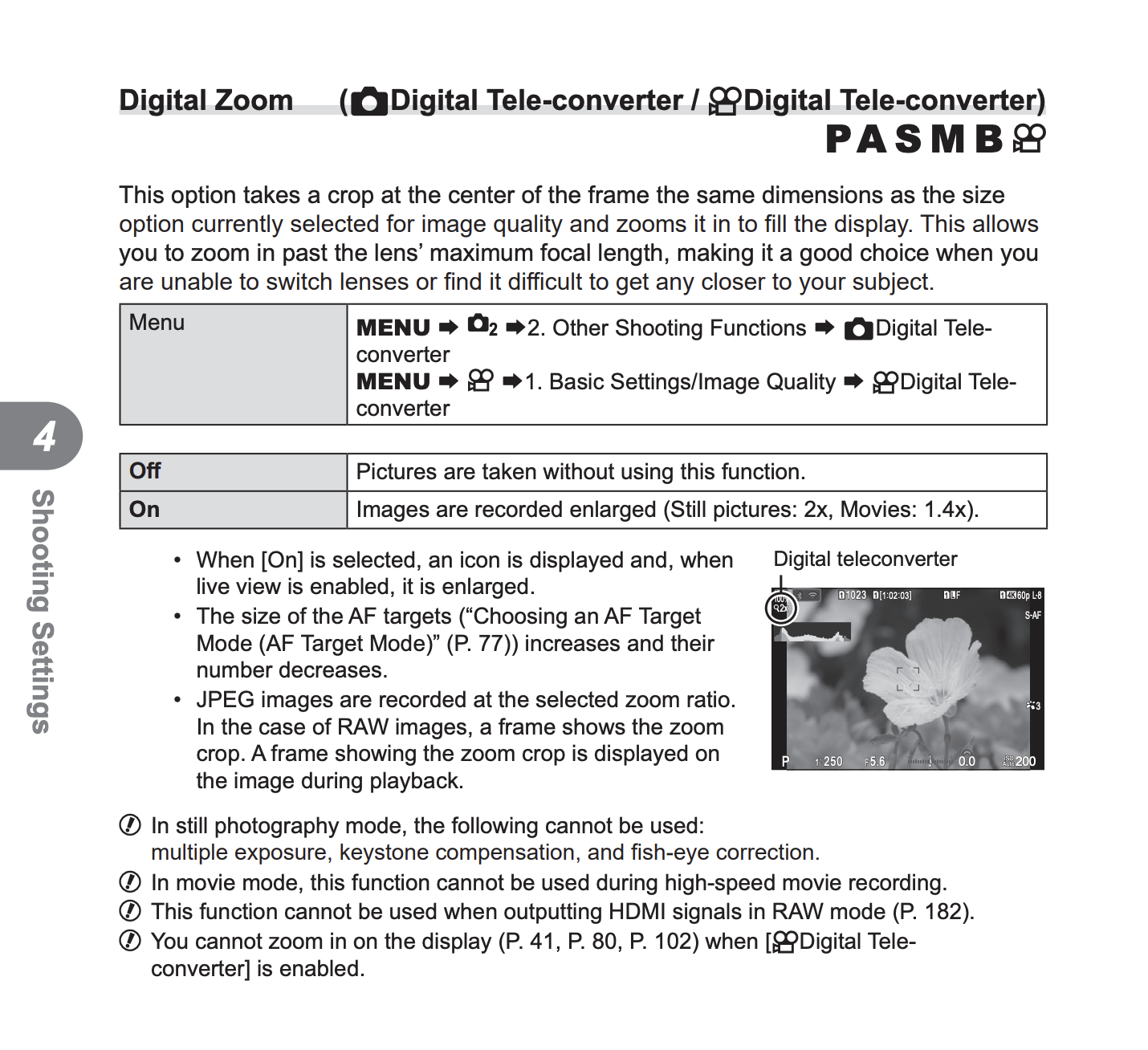

I use the DTC quite often. I'm not aware of any indication in the EXIF that the DTC was employed. However, if you shoot RAW + JPEG and load the RAW file into OM/Olympus Work Space the image will appear with the DTC crop frame shown.

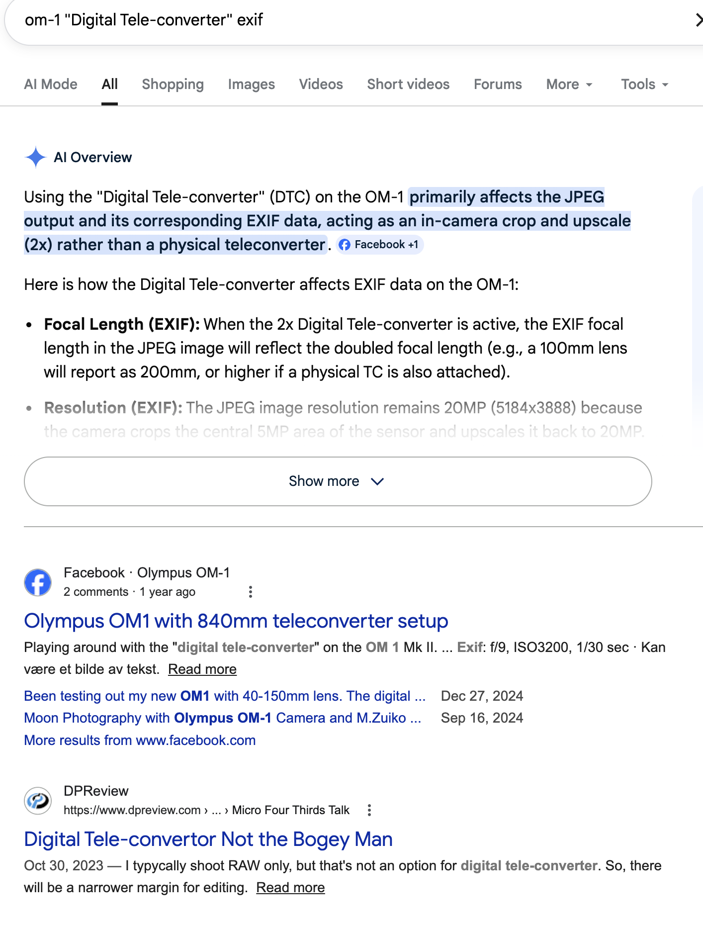

So far I have only experimented with the 2X DCT in JPEG mode, downloading the images in LR and viewing the EXIF data. I see the correct focal length displayed, e.g. when using the 40-150 F2.8 at 150mm setting, with the MC-14 attached without the DCT activated, the EXIF data shows a correct focal length of 210mm. Yet on those same lens/MC-14 settings to which the DCT has been applied, the EXIF data in the downloaded images indicates the same 210mm focal length. Similar inaccuracies occur with other lenses at various focal length settings.

I am guessing the 2XDCT does not show in the EXIF because the physical focal-length of the lens did not change.
Not sure if there is a button you could assign to indicate that those jpegs were shot with the 2XDCT.
I shoot RAW all the time, but have the 2XDCT & jpeg assigned to Custom Mode 4.

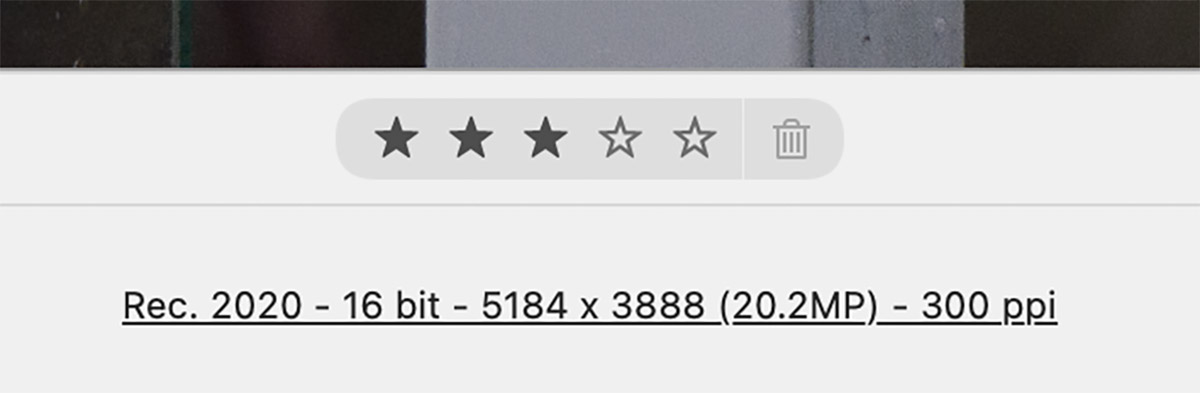

If you play the image you have just taken with the 2XDCT, then press the ISO button at the top right on the back of the body, it will assign a star rating to that image. That rating will show when I open that image in ACR.
a 3-star rating

Thanks a lot Tony!!,
That will work great for me. I remember watching , I think, that video from Rob Trek with all of its information, and will revisit it and learn how to apply its content. He is certainly a wealth of knowledge and I have viewed a lot of his videos.
Thanks again, and I am also learning a lot from viewing your excellent images.

You are right in the fact that the focal length does not change, and I guess the way the camera actually applies the magnification from the DCT, with it done basically in the sensor/processor or such, that the only registered focal length the EXIF data can display is what it reads from the lens and/or MC settings.
